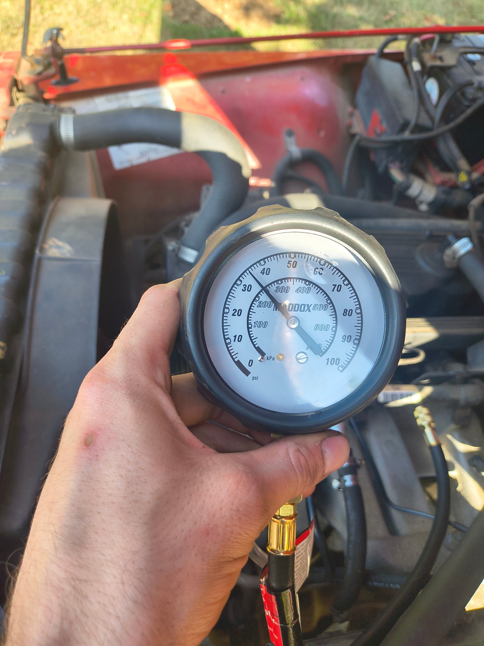

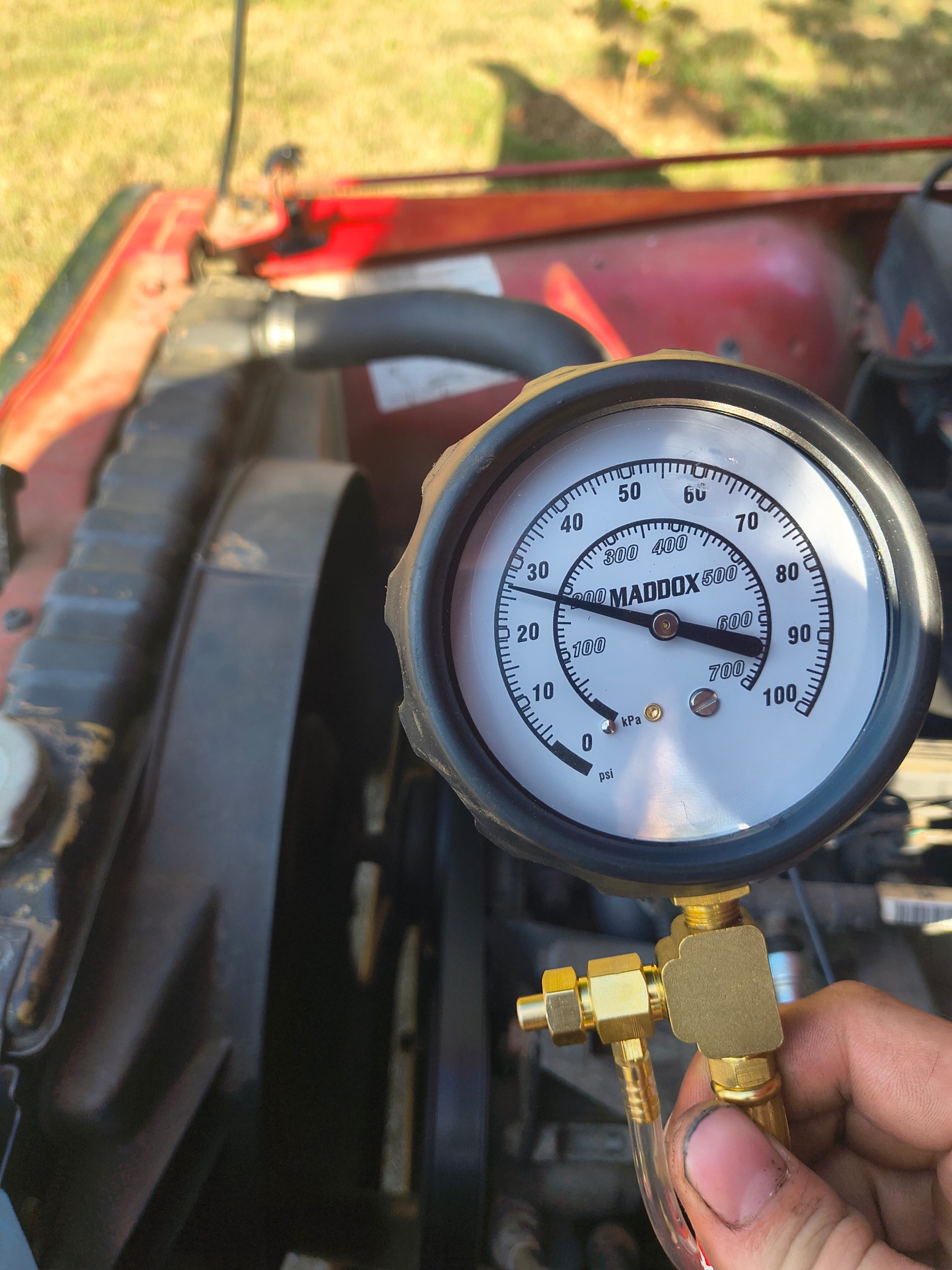

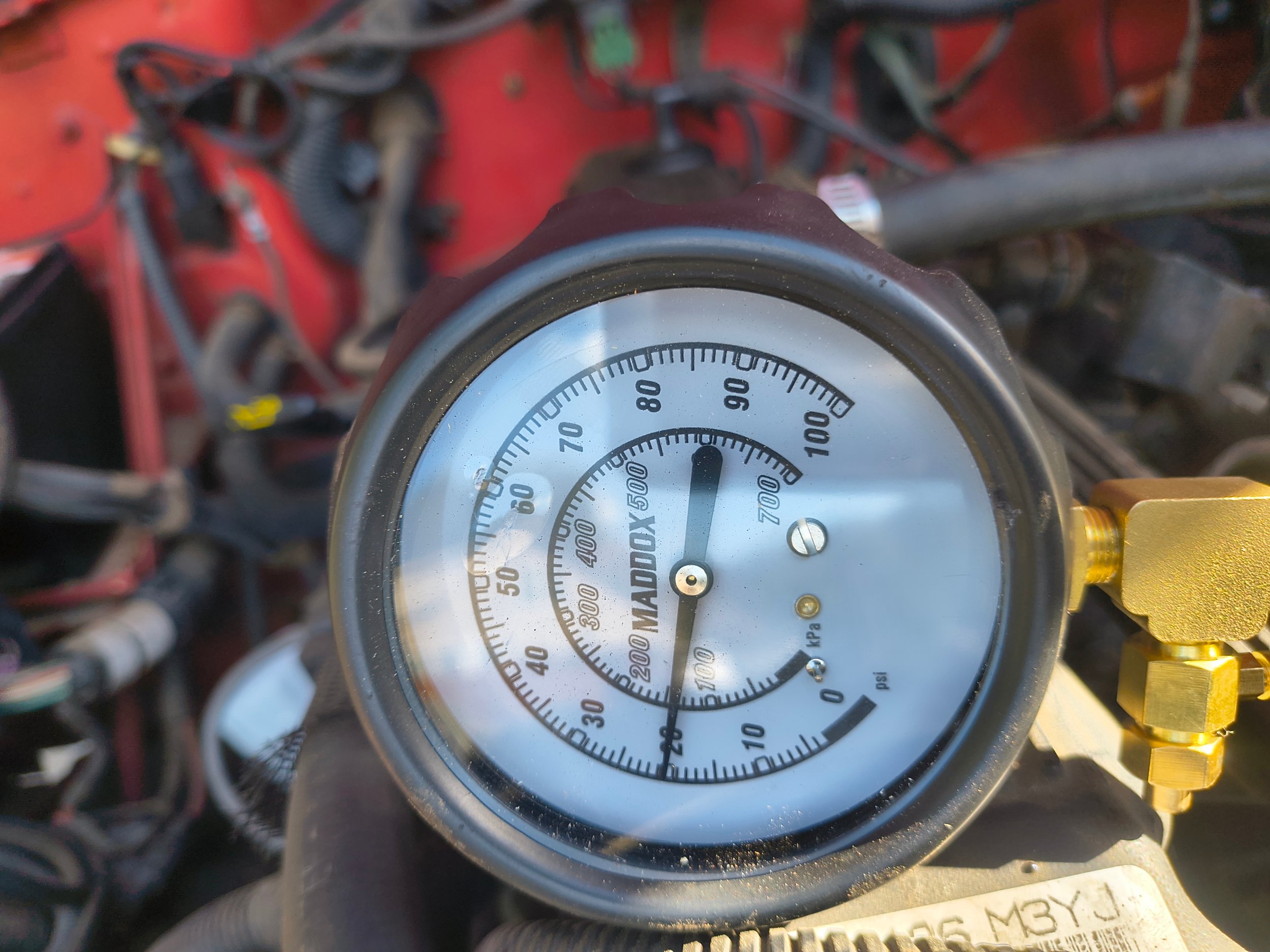

1995 4.0L YJ, 90k miles. My fuel pump died recently (lost power while driving). It had basically no fuel pressure at the rail. I replaced the fuel pump (just the pump, not the entire assembly) and the fuel filter with Bosch parts from Rock Auto. Now my jeep is running again, but my fuel pressure is reading low compared to the specs in the service manual. I'm getting 20 psi prime, 25ish at idle, and 35ish with the vacuum line disconnected from the pressure regulator. The manual states the pressure should be 31 psi at idle and 39 with the regulator's vacuum line disconnected. So the pressure is about 5psi lower than it should be. The jeep also idles slightly rough, but sits around 600-700ish. Of course that increased when I disconnected the vacuum line to the fuel pressure regulator.
Should I replace the fuel pressure regulator? I have not done a pressure leak down test. What other tests can I do? Could the rough idle be related to the low fuel pressure?
