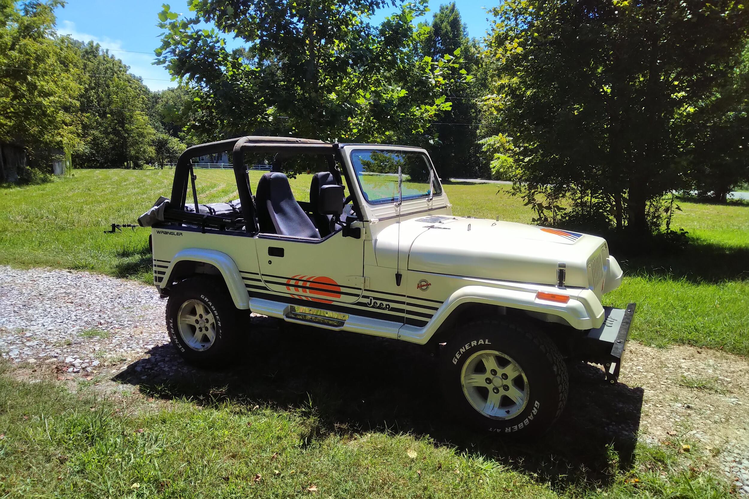

What Gilaguy said about the stock height. Here is my Jeep on new stock springs. It has a 1" body lift. Looks beefy doesn't it? The axles sit on top of the springs, so the bump stops are closer than you'd think. They are a direct evolution of the CJ line. They were already lowered for stability. That suspension is about as low as it gets.
I can't imagine how much rougher it would ride with even less suspension travel. These things are short. They'd rather bounce over a bump.
