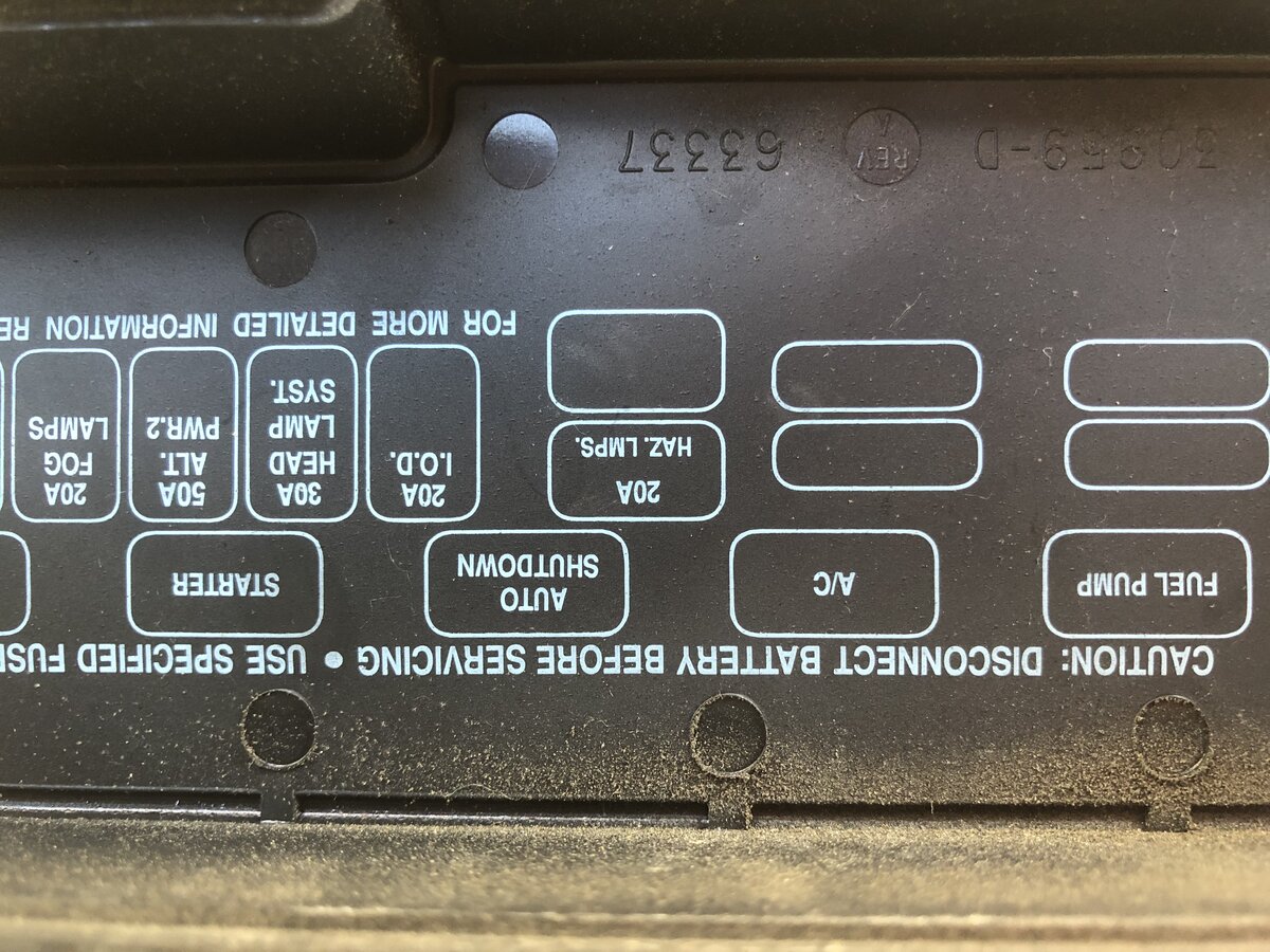

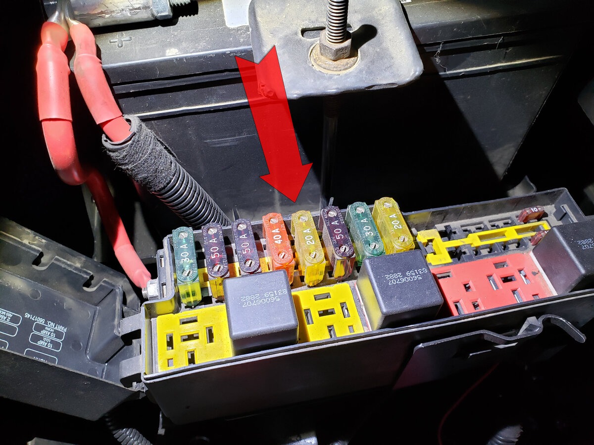

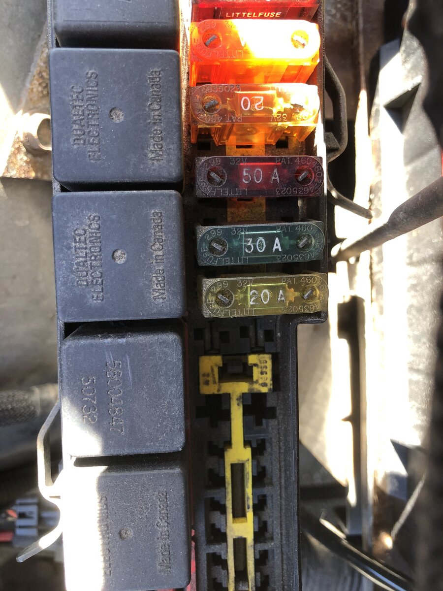

thanks for your reply dude man my first problem is that in the power distribution center there is no fuse for hazard flash there’s a fuse for the fog lights as a number five fuse on the cover for the distribution center it shows that there should be a 20 amp fuse at the endBut there isn’t anything for it
The Hazard fuse is the 5th one from the right in the Power Distro (the "brake/haz" fuse under the dash does not protect the hazard circuit like it says it does). The hazard fuse should be 20A, but from your description I'm betting it's either ok, or like the brake light fuse will blow as soon as you replace it. There's one place where your three problem circuits all come together, and a single malfunction could easily cause all the symptoms you're describing; the turn signal switch.
