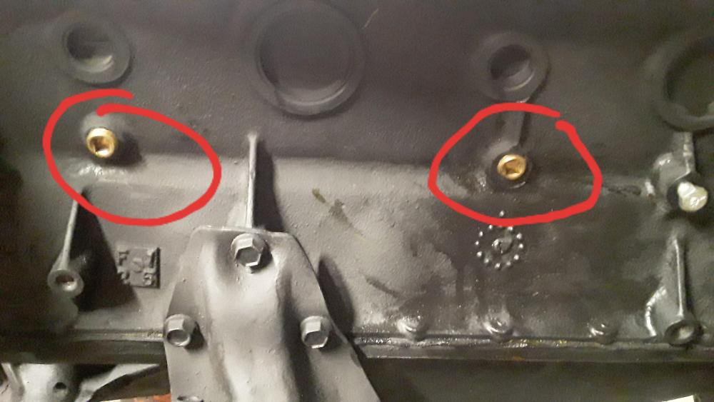

Hello Everyone,
I just purchased a new Champion Aluminum radiator with electric fan kit for my 1990 YJ with a 4.2. My question is there a secondary location for me to put the temp sending unit that would kick on the fan? I seem like there is already two temp sending units, on for the dash gauge and one for the computer? Any help would be great. Thank you!
Dont shoot the messenger here, but Im reading off a Moses Luddel post that says on the drivers sdie of the block, below either freeze plug just to the left and right of the motor mount there are 2 plugs that are basically block drain plugs for coolant.
