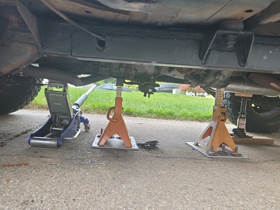

I am installing new catalytic converter. This is my first time working on the exhaust system.
I have removed the skid plate and supported transmission with two jack stands.
My question is do I need to put the skid plate back on before I start the engine for checking exhaust leak?

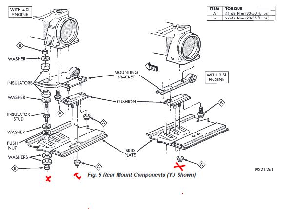

the tranny mount and skip plate are ALL IN, one.
this is all you need to know.
the transmission must be supported.

FSM words (terse)
TRANSMISSION REMOVAL AX5 , stick shift mine,
(1) Shift transmission into first or third gear. Then
raise vehicle on hoist.
(2) Support engine with adjustable jack stand. Po-
sition wood block between jack and oil pan to avoid
damaging pan.
(3) Disconnect necessary exhaust system components.
(4) Remove skid plate.<<<<<<<<<< bingo
(5) Disconnect rear cushion and bracket from
transmission (Fig. 5).
(6) Remove rear crossmember.
3 transmission and 2 engines, and details are not the same. it's the FSM how to work any tranny.
bolts a and b free the mount 4.0L
