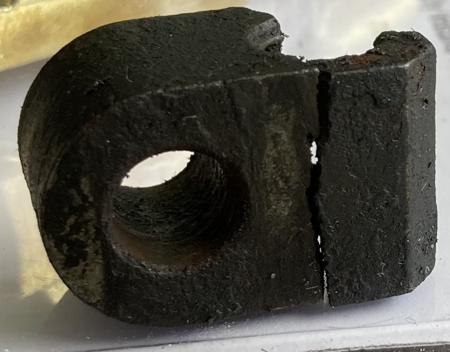

First problem: I broke the tensioner nut while unscrewing the bolt. I’m not sure where to get a replacement and my internet searching skills are failing me. It has two holes facing different directions and the top hole is in a half circle on top of a square. I thought about trying to weld two nuts together that are offset, but I’m still new to welding and don’t trust my skills yet for this type of application. Any help locating a replacement nut or at least telling me what kind of nut it is would be awesome.

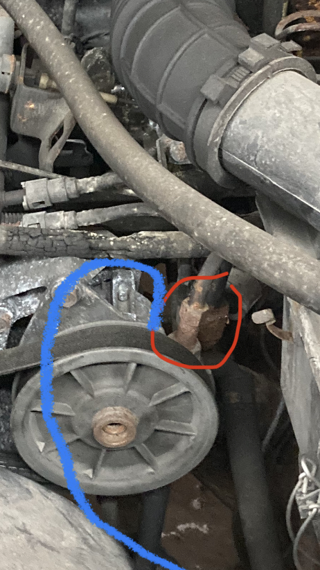

Second problem: The pulley on the power steering pump was broken and I thought it would be faster and easier to just replace the pump and put on a new pulley instead of trying to wrestle the old one off while not damaging the pump. I got the new pump and tried attaching the upper hose (I think - it is the hose with the sensor on it). When I completely screw that hose in, it is about 180 degrees different than what it was on the old pump and will be in the path of the belt. I’m not sure why this is happening and I don’t want to not have the hose screwed in all the way. As an experiment, I tried wrapping tons of teflon tape around the threads to get it to stop in the position I need it, but it did not help at all. I’m at a loss at how to connect the new pump with the old hose. I attached a picture from the original pump to try to better explain. The hose in question is circled in red. The blue line is how the hose would run when hooked up to the new pump. Again, any help is greatly appreciated.

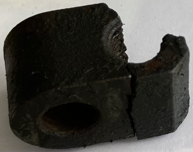

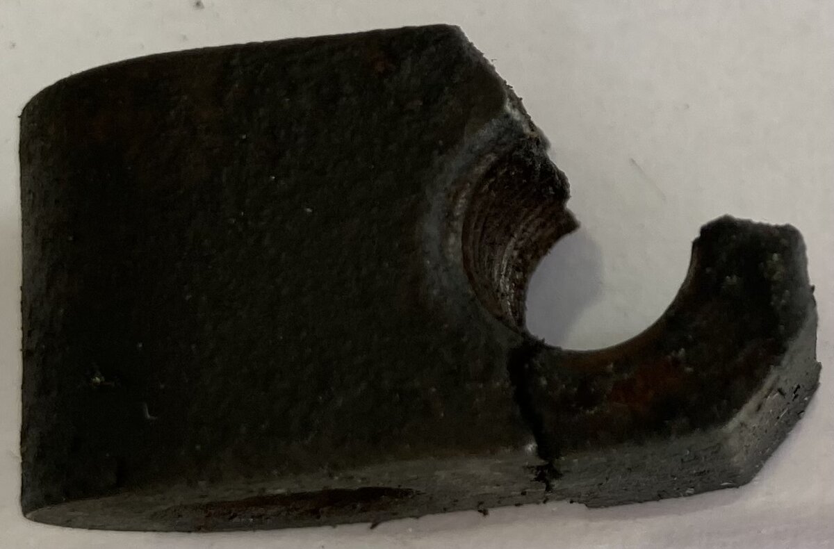

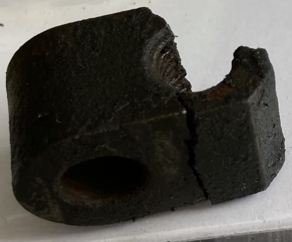

I've attached some pictures of the nut I'm talking about. I only found 2 out of the three pieces so far.
On a whim, I went to my local Autozone and showed them the broken pieces and explained what they came from. He started typing away at his computer and was silent for a couple of minutes. Then he flipped his screen around and showed me Dorman part # 917-148. It is an idler pulley adjuster bolt kit for some kind of Toyota. Instead of round edges, it is squared off, but I think it will work. He told me he also drives a Jeep and knew he could find me something similar. I won't be able to get to the install until next weekend, but thought I would share my results so far.

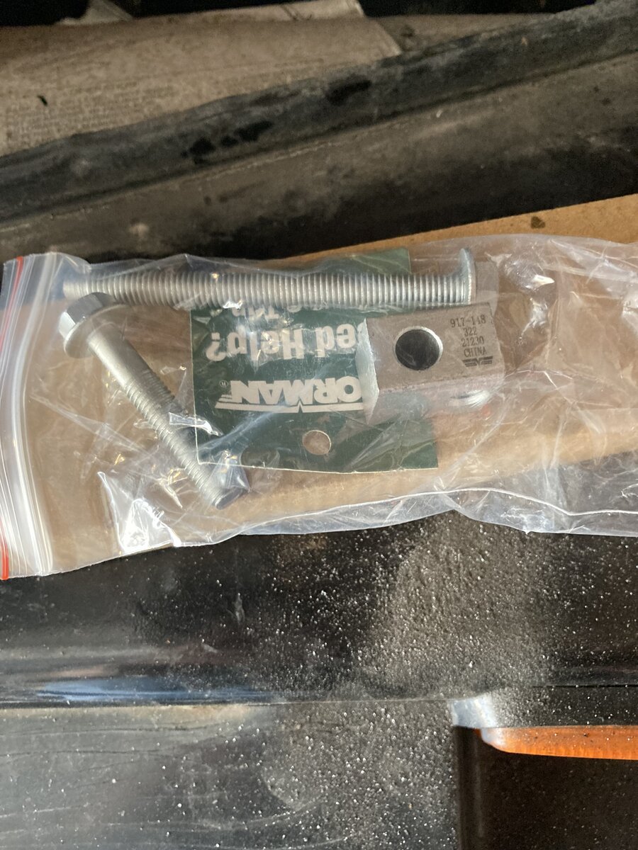

It looks like there is a different kit that might work better. Dorman part # 917-951. It says it is compatible with Wranglers from 1997 to 2002, but it looks to be the same size and shape. My local Advance Auto has one in stock that I'll pick up tomorrow and then I'll update this thread again when I've had a chance to try it out.
I'm going to guess that the nut on the old hose that winds up in the wrong position is frozen to the metal tube. It should spin around the tube on the hose freely.
I was wondering about that. I could not get it to turn at all and assumed that was the design. I ended up twisting the entire tube to the point where I believe I compromised its integrity. A new one is on the way - supposed to be here this past Friday, but now I'm not sure when it's coming. Hopefully sometime this week.

Yep, that is the TJ one I mentioned. Let us know if it works out…if not maybe try emailing doorman to see if they have or will make one for the yj
So some tentatively good news. From a physical perspective, it is only a little bigger than the one I broke and it fits fine into the space it is supposed to go. I attached the bracket to the pump and that worked out well, though I think I tightened the bolts holding the pump in place too much because it no longer slides in the slotted holes. I'm still waiting on the new hose, so I'm not ready to button everything up yet, but so far it is looking good. I typically only work on my vehicles on the weekends, so my next update will most likely be next weekend, assuming I ever get that hose.
Good news! The kit for the TJ does work, albeit with a little persuading. I ended up having to keep the bottom bolt that holds the bracket to the steering pump loose while I made all of my adjustments and set the tension. After that, I snugged everything up and couldn't be happier that there is a solution.
