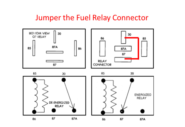

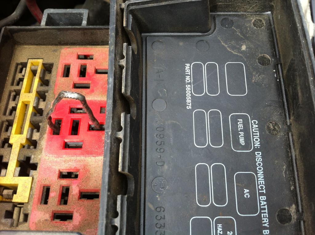

Picked this up a while back, might be obvious to some.

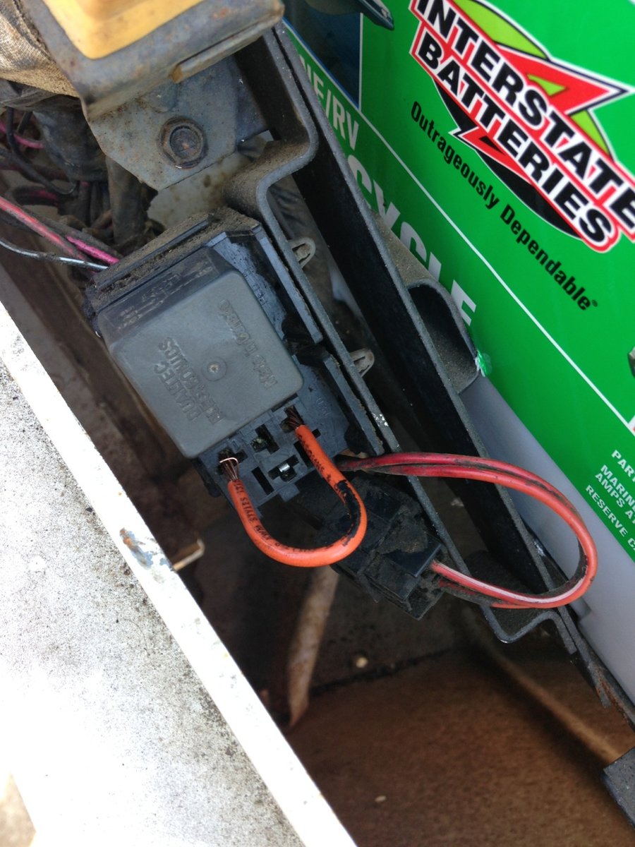

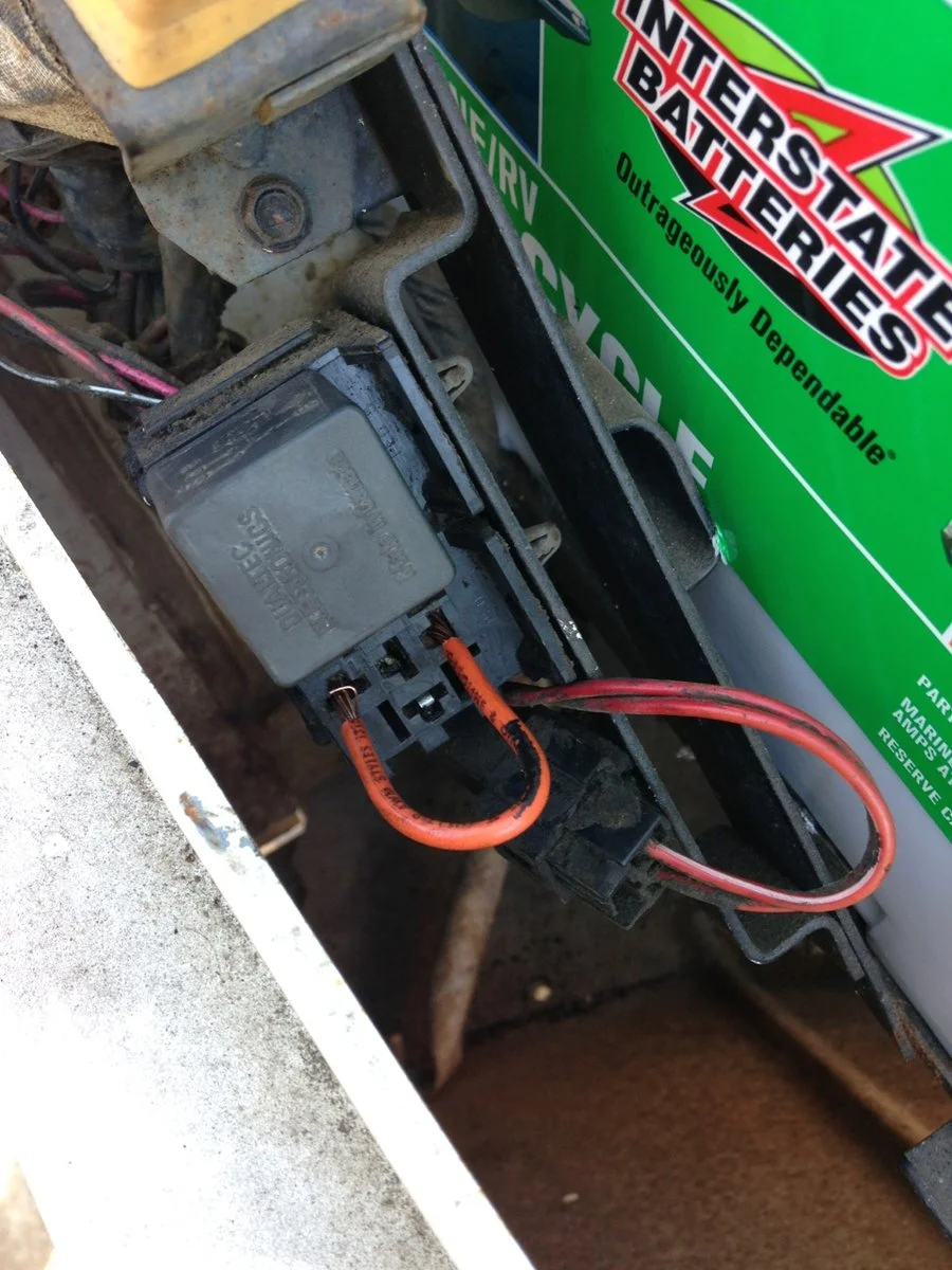

And if you have a pre-1992, it might be over next to the battery.
See? I'm helping :)

87 yj 2.5 tbi is stalling once hot and not starting when it is warm. Fuel pump relay clicks but no pump when this happens. Do you think this will help?
this will jump the relay and supply power to the pump constantly. Its more of a troubleshooting method rather than a solution. if jumping the relay causes the pump to run correctly then your relay could be a cause, or something forward of that.
