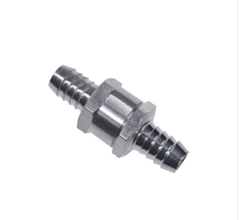

My next attempt at a fix will be adding an inline check valve.

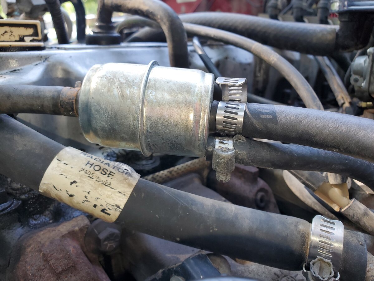

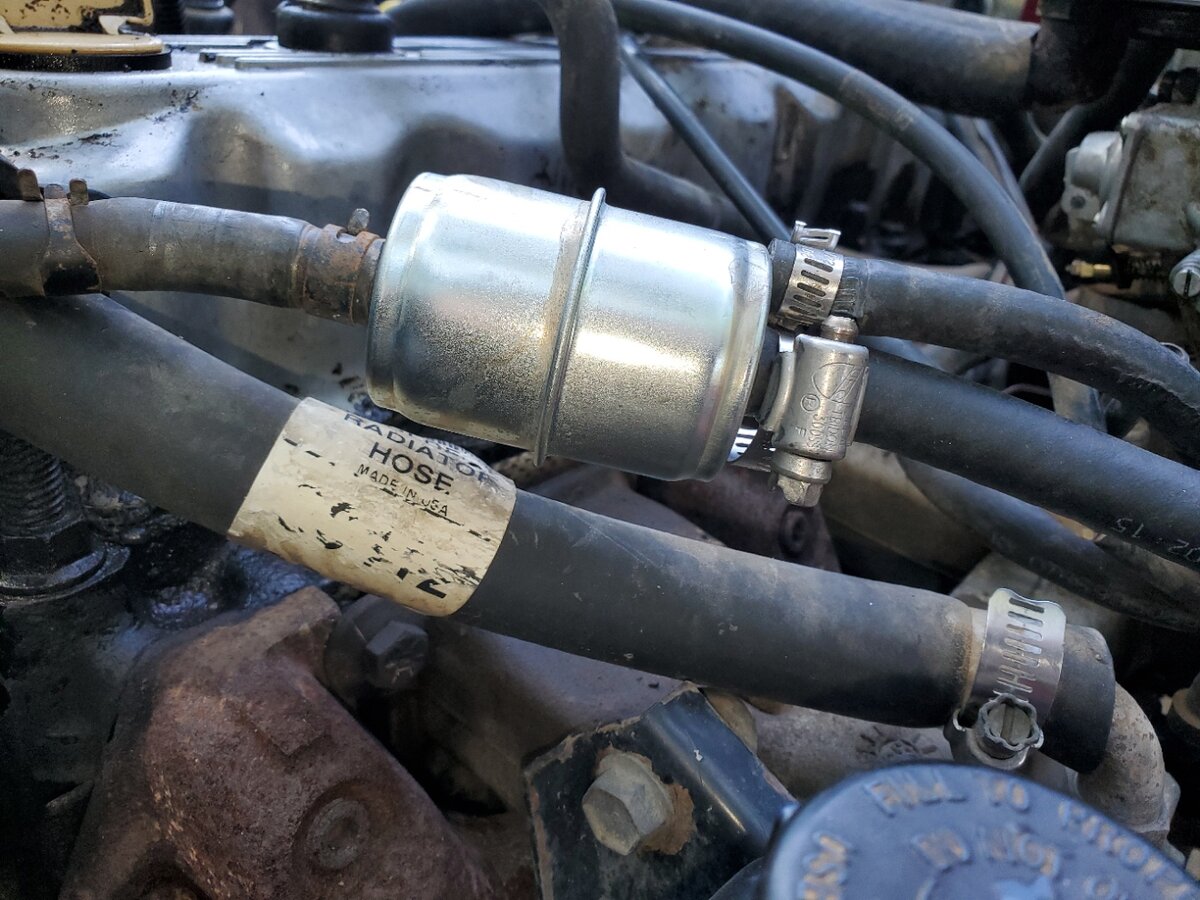

Guy at O'Reilly just told me to check the position of the fuel filter.
I just replaced mine about 3 weeks ago and didn't even pay attention to it's orientation, but apparently having the smaller return line lower than the feed line can allow it to syphon the fuel from the bowl back to the tank. I just went out and repositioned mine... will let it sit an test start up this evening.
before/after
Rotating the filter lines didn't seem to help much. Next step is the fuel check valve.
