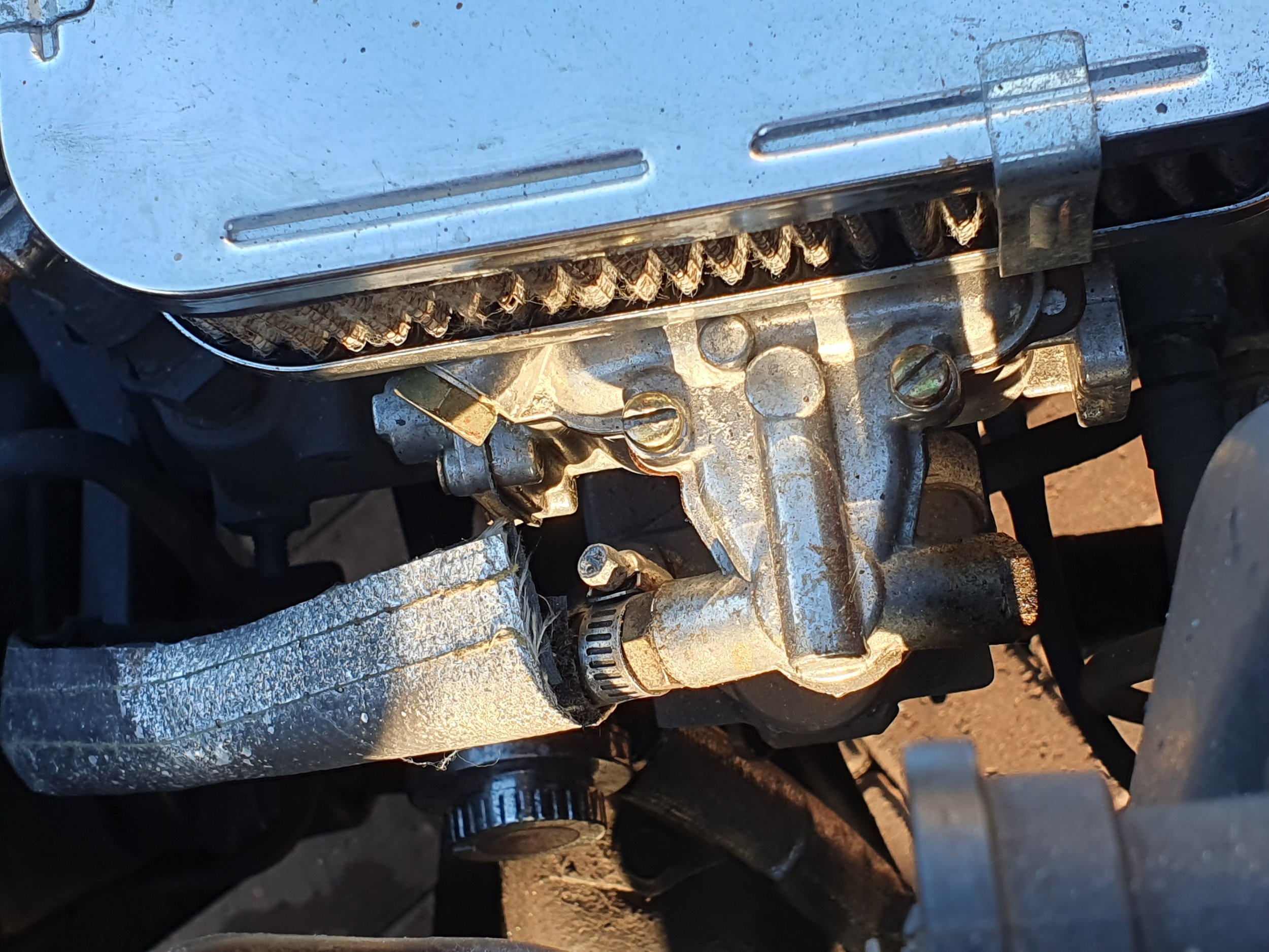

Hi all, A query to anyone with a retro fitted carb on a 2.5l 4 cyl. I know there are lots of posts on this and references to vapour lock but I thought I'd put some pics up to see if there is anything I can do to improve my filter, fuel line, pump, pressure valve set up??
Same issue as reported by plenty other folks really: drives fine for 30 miles at 60mph etc. But as soon as we hit traffic or slow down to a stop or crawl, the Jeep barely holds its revs and seems to want to stall, almost like it's running out of fuel (full tank so it's not a lack of fuel)
So here is my physical layout.
  1. Electric Fuel Pump/ Filter in tank has been removed.

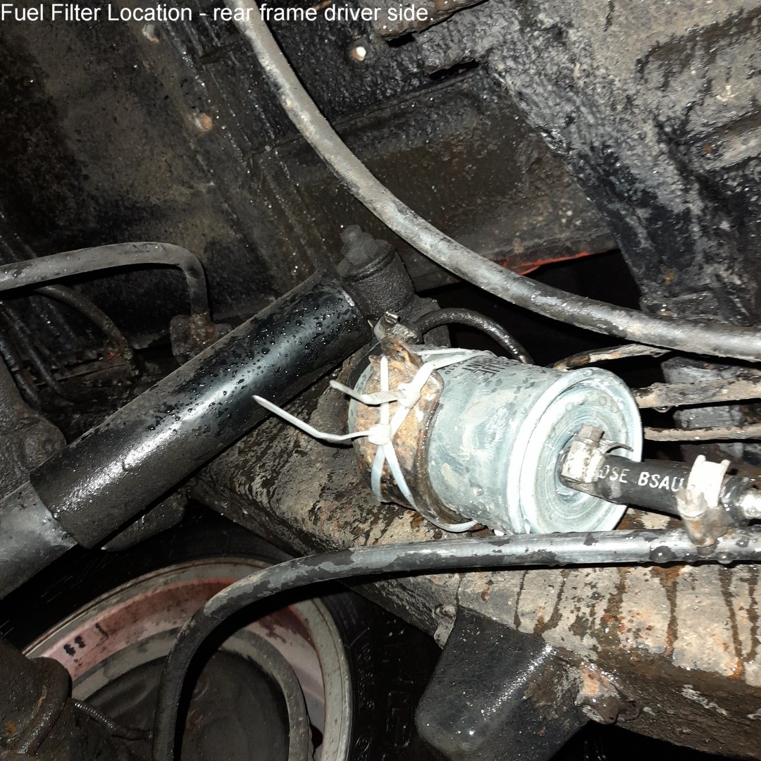

  2. Fuel Filter (one year old) is the large canister type bolted to the rear D/S frame per original spec.

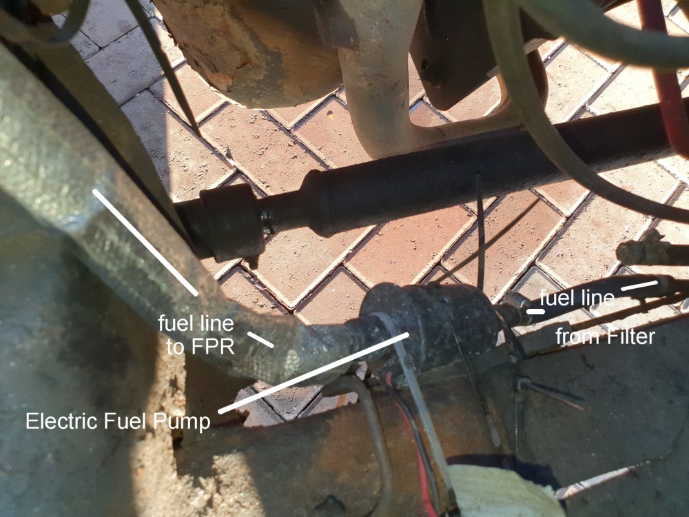

  3. Electric Fuel Pump is bolted to the D/S frame almost directly under the carb housing.

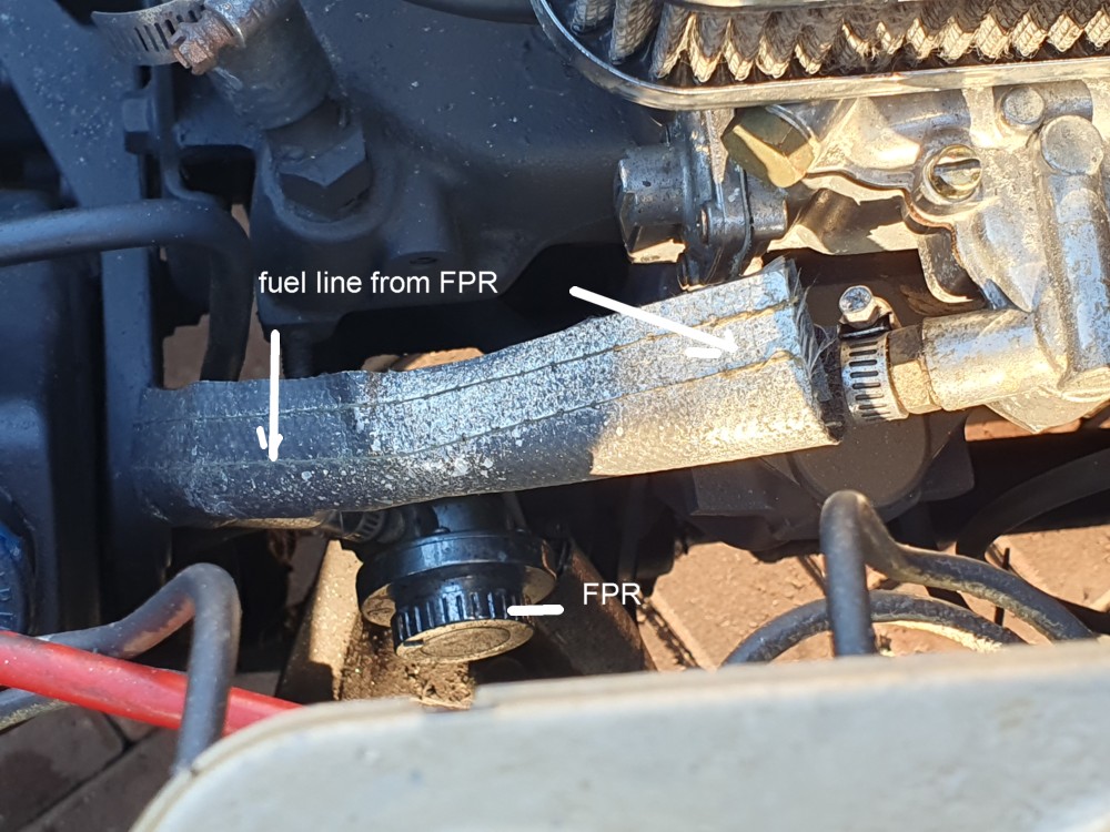

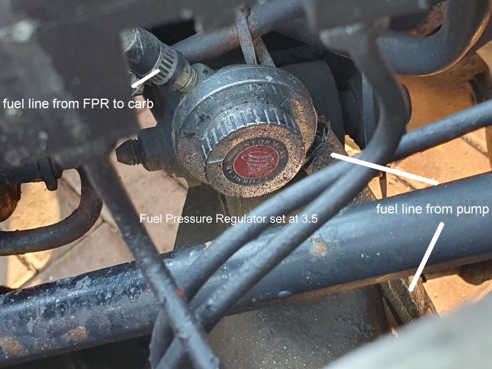

  4. Fuel line goes straight uphill from there to a Fuel Pressure regulator set at 3.5 psi.
  5. Then fuel line goes from there on a short curve into the Carb intake. It's wrapped in heat reflecting material.
Is there anything I can do to place things in a better way or reduce heat build up leading to possible vapour lock?
It seems to me there is a convoluted fuel line set up out of the tank and to the filter with a few ups and downs around the shocks and frame then down to the filter when a shorter more straight forward connection could be a better move? Is this advisable?
Should I move the filter closer to the pump?
Should I fit another filter in after the pump before the FPR or just before the carb?
Can I use one of those small see-through orange and plastic filters that let me see if it's getting dirty?
Any help would be really appreciated. Thanks all.

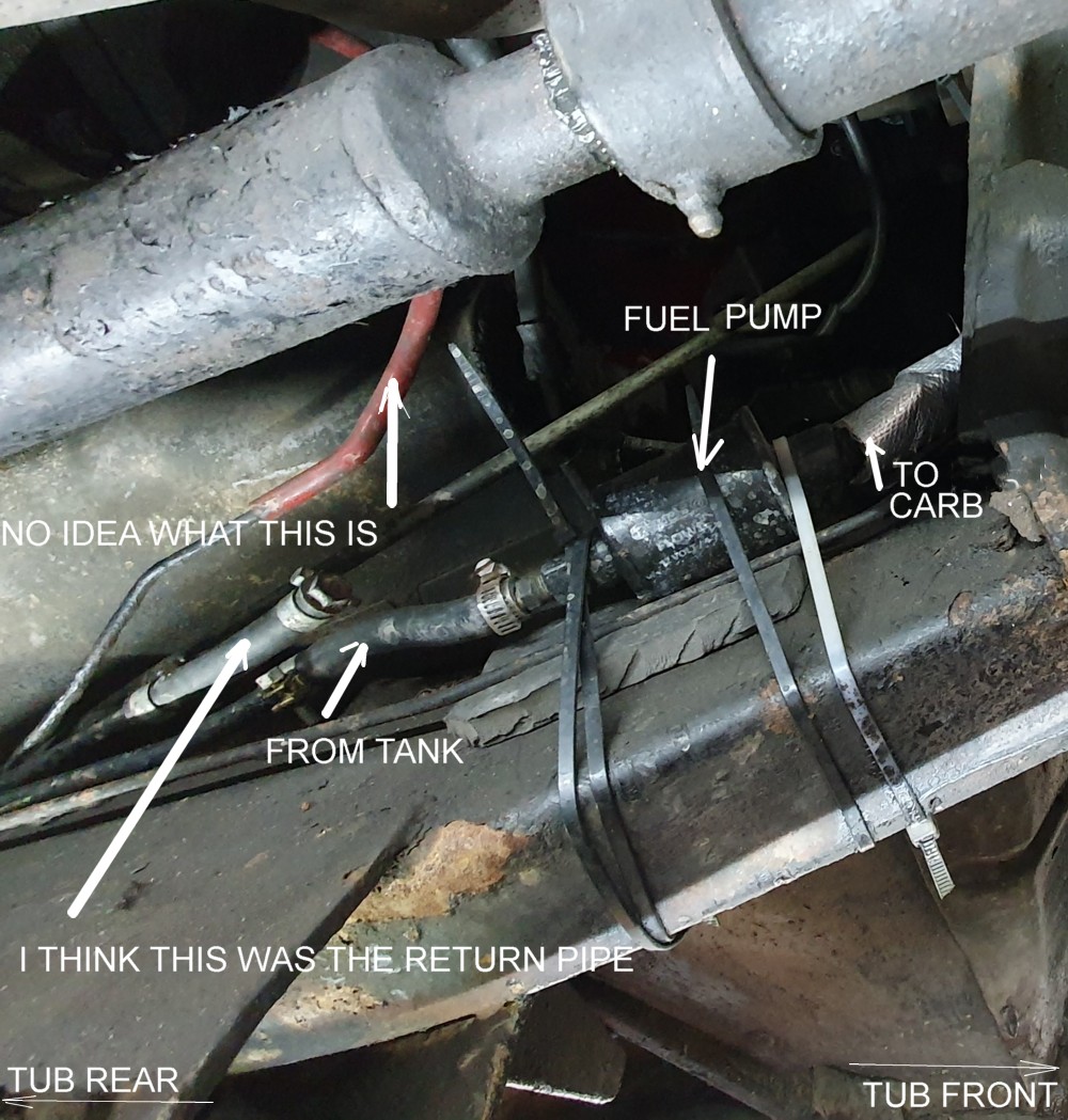

Hopefully this makes sense.
Looks like someone hooked up my fuel lines in reverse.
The line with the in-line filter has been blocked off under the cab juat as it heads up to the engine bay.
The fuel appears to be coming from the return line and has no filter at all, just goes from tank to pump and into the carb.
There is no real return line, just one way.
There is no pump in the tank as this was turned off and a small electric one with a regulator was installed just below the carb.
Questions for you gurus!
1. Is there a way to tell the difference between the return line and fuel line at the tank so I can follow the lines to see if I'm dead right?
2. Is there any harm in swapping the lines over so the line with the filter is providing the fuel?
3, I bought a filter with the extra return outlet to replace the in-line one, so do I hook up the 'original' return line to the return outlet and she should run.
4. Could it be that the tank pump is still in place, and that's why someone used the return line as the new supply line as the tank pump won't allow fuel through without being turned on and the return line will?
5. Can I drop the tank, whip out the pump and reinsert only the line securely so it's free flowing to the filter and on to the new pump upstream and into the carb?
Any help would be greatly appreciated!
Thanks!
Normally it would have a fuel feed line to the carb, the return line and a vent line (red one Id bet) that goes to the charcoal canister. Where you have your filter is pretty much where the one on my 91 was. But not knowing its past history whats the inside of the tank like? rusty, crusty, filter impeded already?
I used to use those glass see thru filters or the semi see thru plastic ones so you could see the junk inside it. I think there is also a sock filter or other type screen on the original fuel pump so that may be partially plugged. Yeah, dropping the tank is probably a good idea to discovery and to set up your lines with 100% clarity on what's what. Just for chits and giggles next time its starts to peter out pop off the gas cap and listen for a hiss like the tank isnt vented and starving it for fuel.

That's a good point. It does hiss when I pop the cap off! Should it be a vented cap? I've got a posh chrome one that you really have to press to click and then lock it. Maybe that's part of the issue. It needs a vented fuel cap?
Late model vehicles generally use a cap that should allow air into the tank to prevent vacuum collapse as fuel is used, but disallow pressure/fumes/vapors out. That's where the charcoal canister and smog system come into play. The tanks pressure is released into the canister and any liquid or fume build up is then recycled back thru the system to prevent whatever fumes are released into the air. Kinda like the star wars gas station nozzles they invented...that dont work. :whistle: I assume all the smog stuff on your jeep is gone or disconnected. I also recall from decades ago messing with one of those fuel pressure regulators they can be very pissy and change all by their lonesome either drowning or starving the engine.
