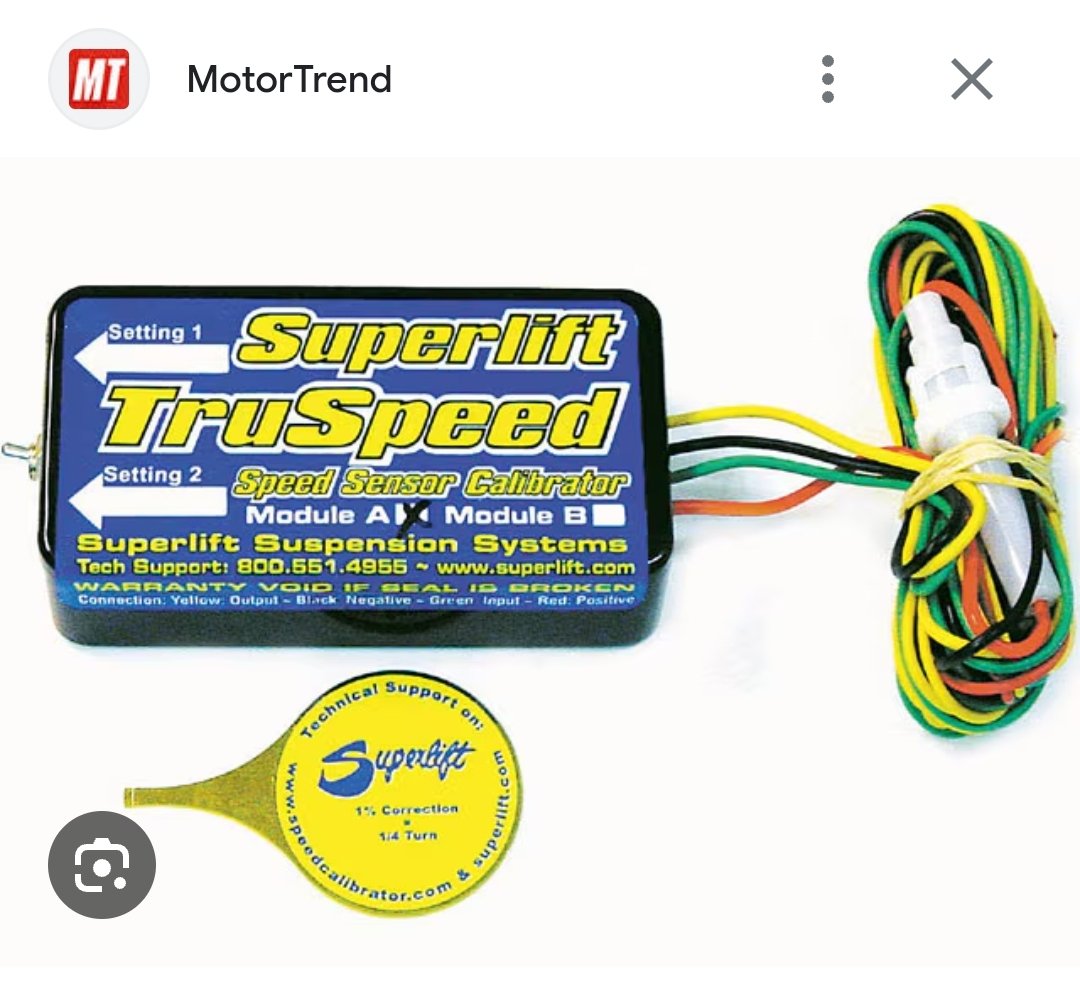

Thanks for the info! The power supply for the calibration unit has a blade attached to the end of the wire that plugs into the fuse box. The instructions say to pull fuse #9, insert the blade on the hot side and put the fuse back in. That's not possible. There is a slot to the right of #9 that is hot, so I put it in there. Maybe the signal is getting noise or it's not a tight fit. I'm thinking about getting a fuse tapper and hooking the units power wire to that and plugging it into the #9 fuse. Something like this (pic). That will be a more secure fit and be in the fuse that the instructions call for.
