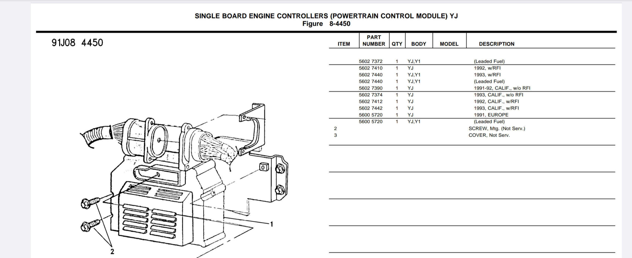

Hi everyone,
So, I have a 1992 YJ (2.5 Man trans) with a bad ECM. I have found a local take off from a (running but wrecked) 1994 2.5 but its an automatic. I believe this should work with no issues but any info from anyone is grateful. TIA
It's looks like the factory parts catalog for the 1992 does not have different part number for manual vs automatic for the PCM. Which is interesting because it does for my 1995. So, I think you'd be fine. Here's the page for reference.
