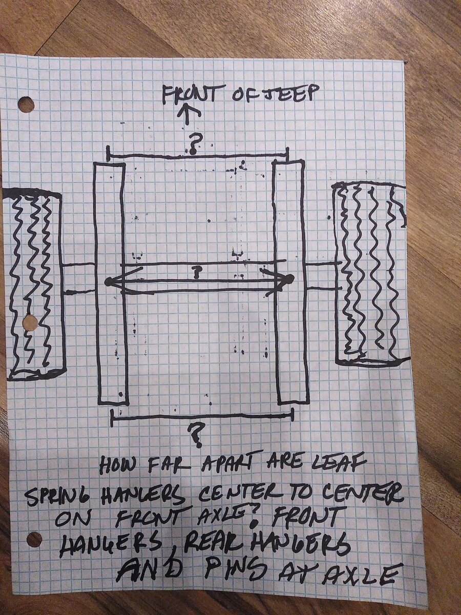

Let me ask it another way. Where springs mount on hangers at front of Jeep.......measurement is 31" center to center.
Where the other ends of those same springs.... attach to frame rail hangers they are 30.5 center to center.
I thought they were supposed to be the same.

I decided to measure center to center on front hangers, rear hangers and leaf pins. I got,
This is for front springs...all center to center
Front hangers 31"
Pins 30.5"
Rear hangers 30.5

They say a picture says a 1000 words....I hoe so.

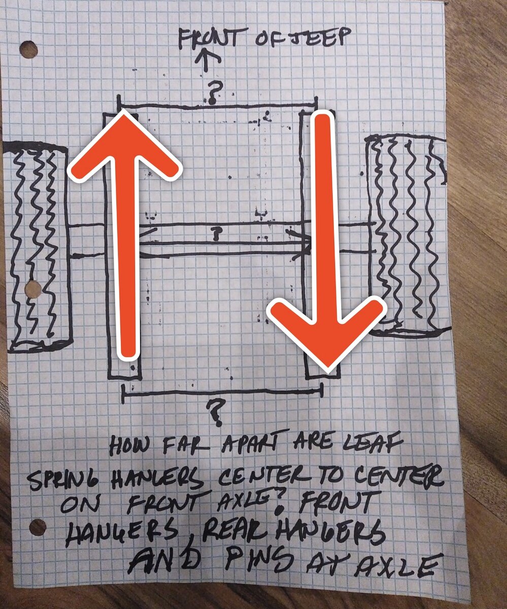

The 43” measurment I provided is front driver side front spring hanger to driver side rear frame front spring hanger, if that makes sense. I got that from your question, “how far apart are the spring hangers center to center on the front axle?”

The 43” inch measurment I provided is front driver side front spring hanger to driver side rear frame front spring hanger, if that makes sense. I got that from your question, “how far apart are the spring hangers center to center on the front axle?”
