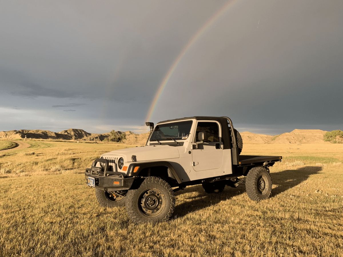

I want to do a diesel swap, but I'm not sure which one. I have a TJ with a R2.8 Cummins and I really like that engine, but I kind of want to go 4BT or Kubota or TDI or something and I want to probably run a 3/4 ton manual transmission, a doubler t-case with a Dana 300 (4:1)/NP231 (I'll have a spare one once I swap mine out on my TJ) and I'm not sure for the rear axle, but I think it was damaged.
I am pretty much stealing this guy's build on a R2.8 forum I have posted on looking for specific info on that engine.
I may not go snorkel (it's obviously not a TJ), and I like a more minimal bumper.

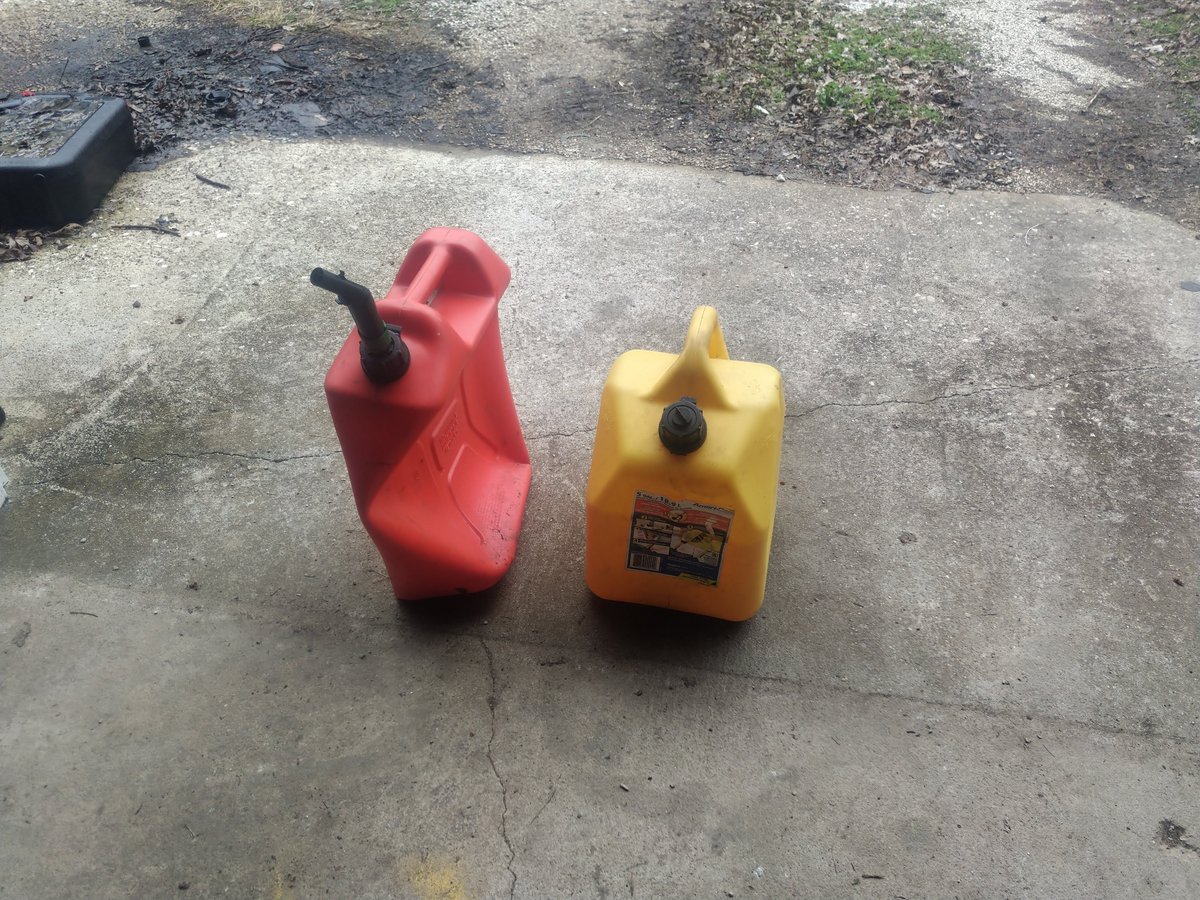

That's what I've ran into before, when I need to refill some gas cans. They literally won't hold more than a gallon or so in that state and you gotta wait until it gets really warm to bloat the cans again. Gas destroys the Nato fuel can (these plastic cans are so thick they barely budge) gaskets as well (pressure not a material issue per se), so you end up using stale gas if you don't spill it everywhere and in a carb injection system, you may have trouble starting up with stale gas. We don't have that problem in our diesel tractors, even if the fuel is growing algae.
I've filled up gas cans in the winter and then on a warm day and like an idiot, stood over top the can while removing the top and been sprayed in the face with gasoline. Though hilarious, it does suck while your nostrils are filled with fumes and your eyes are burning.

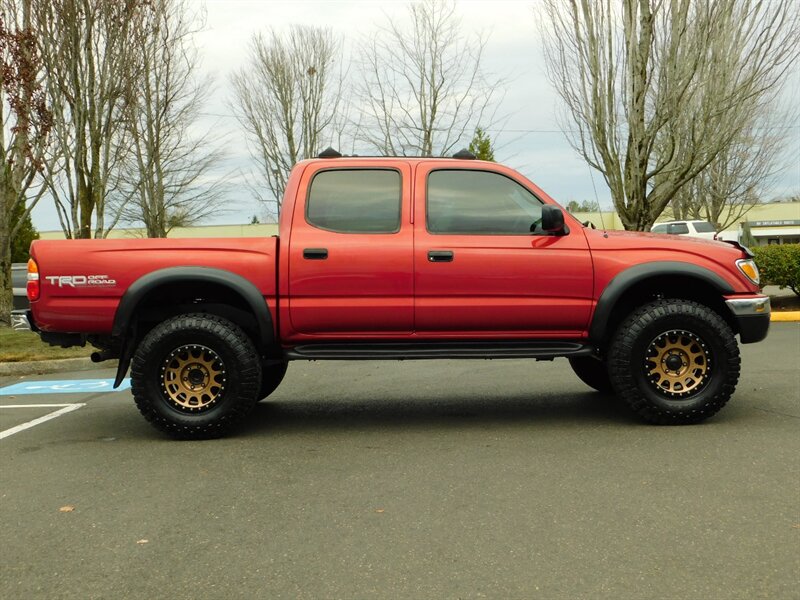

I've got a 2003 Tacoma TRD double cab, and I love that thing.
Here's a picture of it:
I like the earlier Tacomas because they are small enough to still go places, but still a truck.
You'd be surprised how big the back seats are in that too. I have no issue fitting both kids car seats in it.
