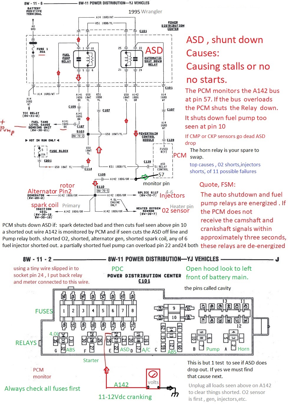

has the ASD relay
if spark is dead after 3 seconds cranking , and the ASD drops out. (de-energizes) that
means the PCM discovered the output pin ASD is overloaded.
I have posted here 10 times all things that cause that.
when ASD drops out all spark , fuel and fuel pump relay go off line. dead.
that is it whole purpose to end 'crash and burn' as seen on TV. and by law.
see ASD if: below.
I made this drawing just for ASD failures. top cause is 02 shorted, the heater shorts and bam, dead.
the voltmeter test, is the PROOF it did.
DTC error code 42 is ASD output was detected OVERLOADED
wire a142 is the wire bus that was overloaded.
the ASD relay must be closed full time cranking or running.
the ASD senses wire 57 , if the voltage is too low the PCM flags it < overloaded. my guess, about 9v.
so a weak car battery is never wise to have. the FSM tells you to keep it charged all the time while troubleshooting all electrics.
try running with 02 unplugged yet.
check out pin 7 FPR, if the pump shorts as they sure can do , it overloads ASD pin 22, and bam , ASD dROPS DEAD>
