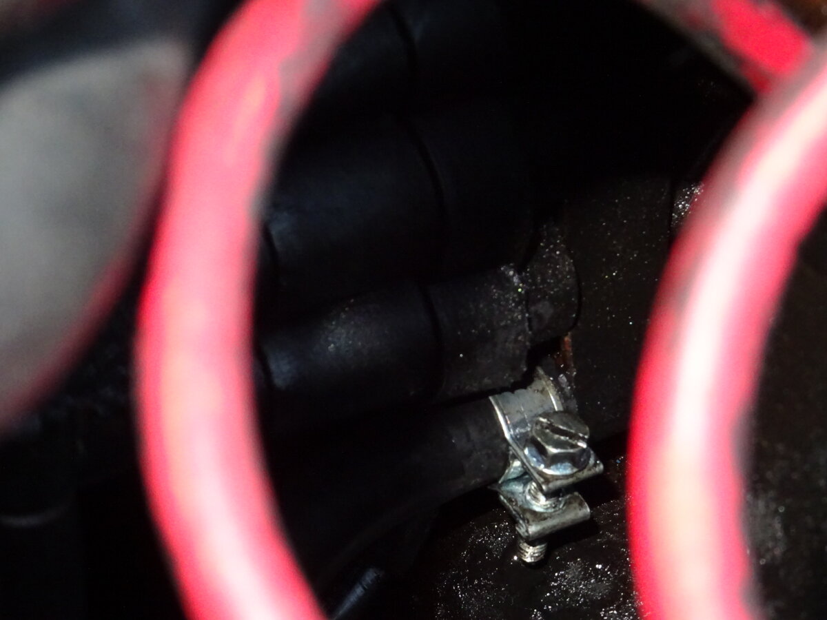

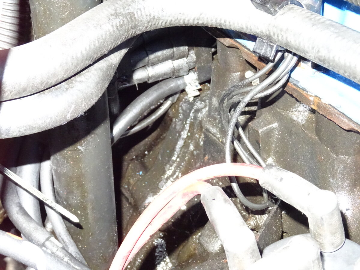

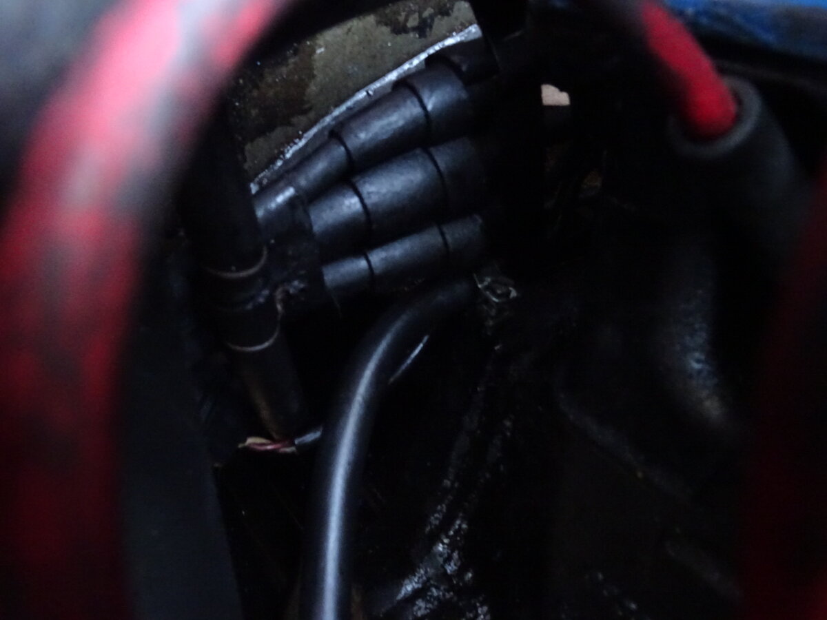

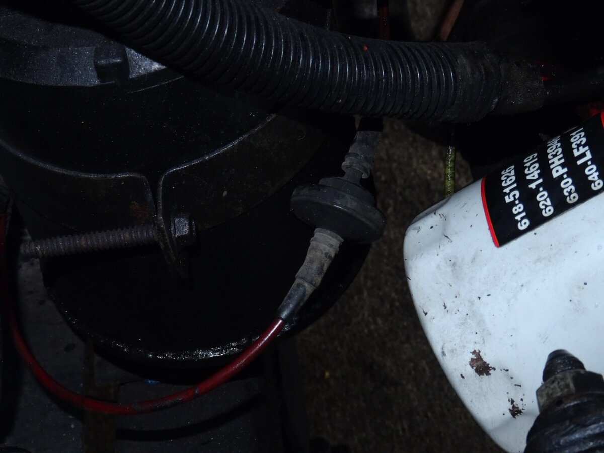

OK tube, pipe and line gurus. Whilst pottering about with my backfiring 88 2.5 I spotted a perished rubber hose half hanging off the nozzle it's supposed to go on. I nudged it off and the whole thing fell apart. I pulled it a little to see what it was and it literally came away in my hand but was obviously connected previously at both ends. Ita about 6 inches long. So I grabbed a new bit if tubing and put it on the nozzle and then looked to see where it originally conneced to at the other end and found a disconnected socket with a weird object on it. I took a chance and connected it and started the Jeep up and no apparent issue. From the pics can you tell me what this line , hose, tube does and from where to where please.? On the pics its the third tube down with the new jubilee clip. This was where it was literally hanging off and totally perished. It's way down behind the valve cover near the firewall in a 2.5 . The other pic is of the strange little device I think it supposed to be connected to. Hope that explains. Many thanks.
Sounds like a vacuum line with a one way check valve. I’m not sure about your year YJ since you have carburetors and mine doesn’t.
Hi, mine is a 1988 built for EU export and has a TBT single point fuel injection system. I plugged the loose end into that thing and I think..... think.....it might have been the root cause of the massive backfire along with a 100% totallycaevon packed EGR valve, solid carbon with no open holes.
