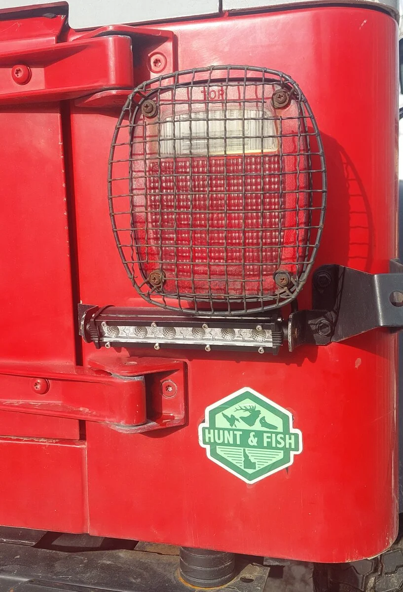

This is a 7" light bar from Amazon.
It lasted about a year and a half before it burned out, but it cost about 10 bucks and takes 10 minutes to swap out.

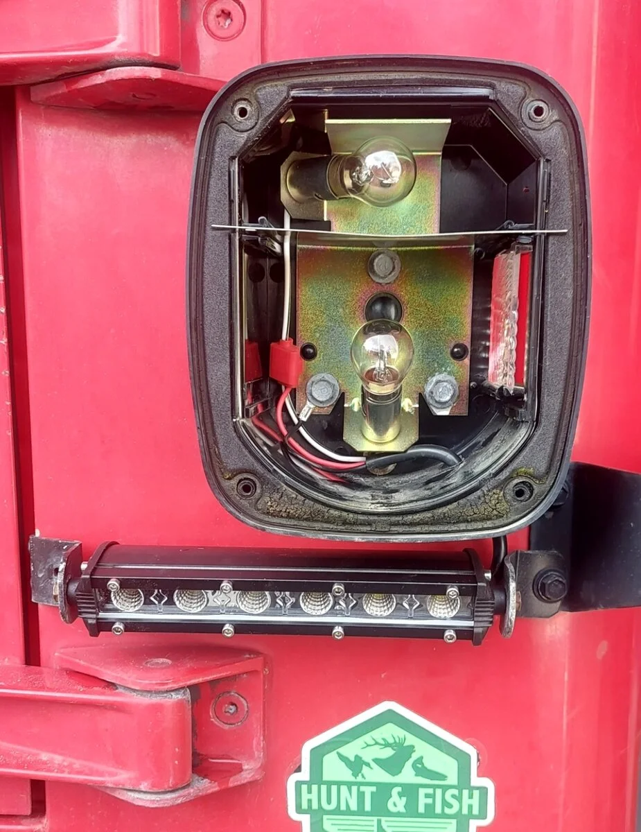

I was replacing it and decided to post a couple pics.
The brackets are made out of a flat piece of aluminum, bent to shape.
This mod was cheap, easy and provides much better light. The light bar pulls less than 1amp, so there's no need to upgrade the circuit.
When this one burns out, I'll just replace it again.
