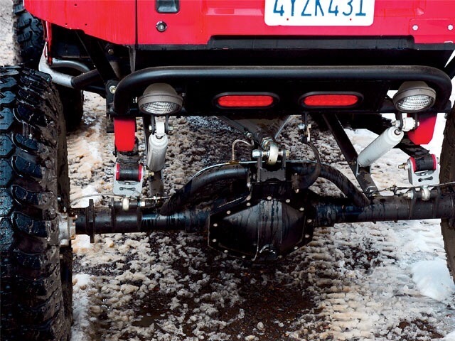

Anyone had any experience, or thoughts, on doing a rear buggy spring (aka 3/4 elliptical)?
Looks like a simple enough conversion, but I just don't know if it would be worth the handling trade-offs.
I could see it unloading going down very steep hills (like revolver shackles can do) and putting you ass over tea-kettle.
The issue is that a 3/4 spring setup requires links to locate the axle. At that point it would be pointless to not pull the trigger on coilovers.
The rear frame has to be removed or pulled in towards the tub to make room for it to all be packaged.
Reactions: Chris
I see, that's not quite what I was referring to.
What I was looking at just adds half a leaf spring U-bolted to the frame to become the new shackle hanger.
I read 3/4 elliptical and I was off to the races. 😂
IMO, any spring hanger should be hard mounted to the frame or bumper. More so on something driven on the street.
They do provide some additional down travel. I just hate the idea of my spring hanger being u-bolted to the frame and having to rely on said setup for everything a leaf spring hanger does.
