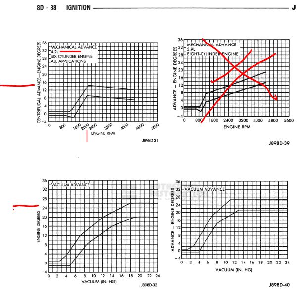

chapter 8D,page 33 covers the tests, using timing light, if failing this full power will be pathetic, just like silly lawn mower lacking true spark controls are.
the centrifugal advance is 12deg at 2000 rpm. if the guts inside, Centrifugal are rusted as most this old are, then there is no advance but vacuum type.
the vacuum tables same page show up to 27 degrees advance. 8D-38

the advance charts good luck figuring out any old car like this with MCU controlled carb and distributor.
