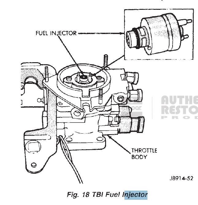

1. buy a NOID lamp - just a few dollars for the Chrysler one.
2. connect it to the plug that normally connects on top of the injector when its bolted in. ( on your picture its the two pale yellow sockets facing upwards)

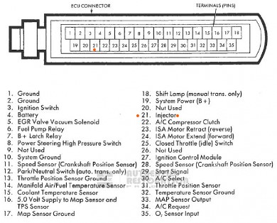

6. No flicker = bad news - May need to test the ECU to ensure the signal is leaving it to the injector. Terminal 21 is the one signalling
the Injector.
( technically FYI, it's on all the time and the ECU provides a negative signal to 'fire' pulses at it not the other way around)

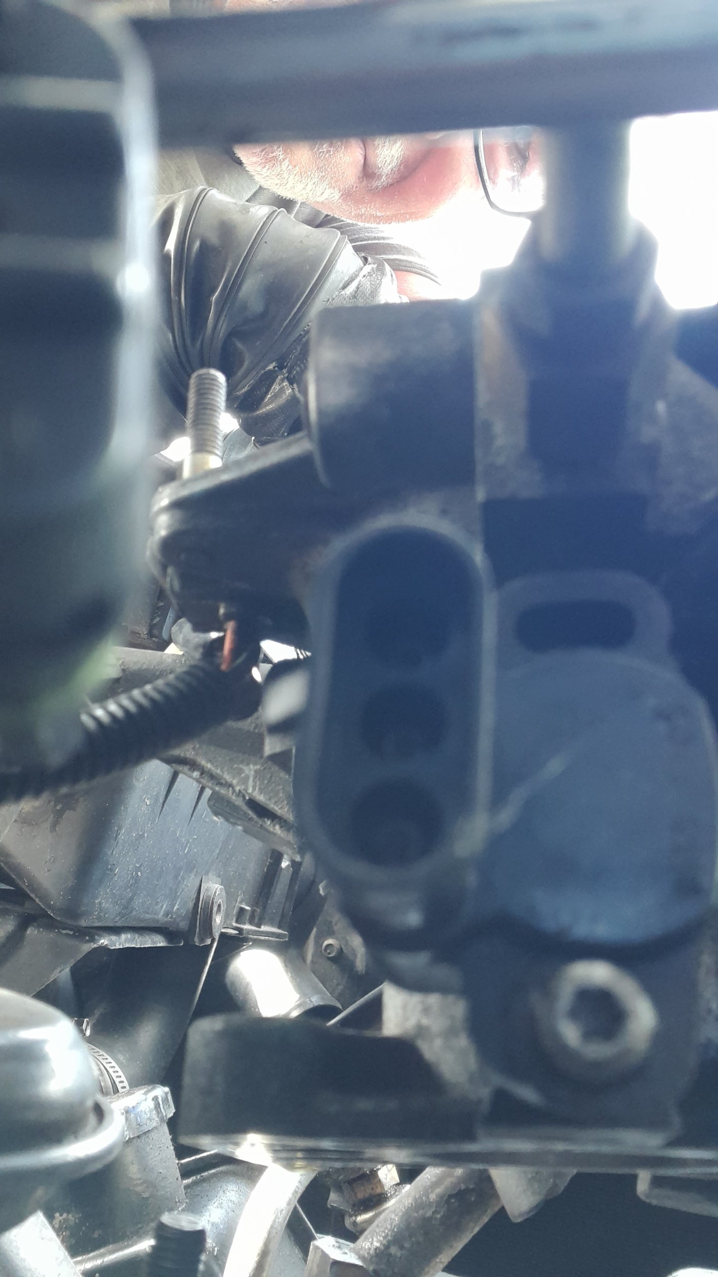

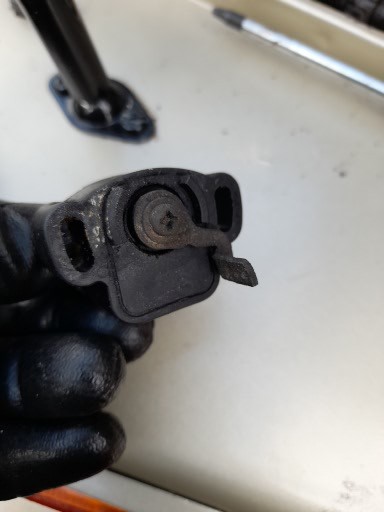

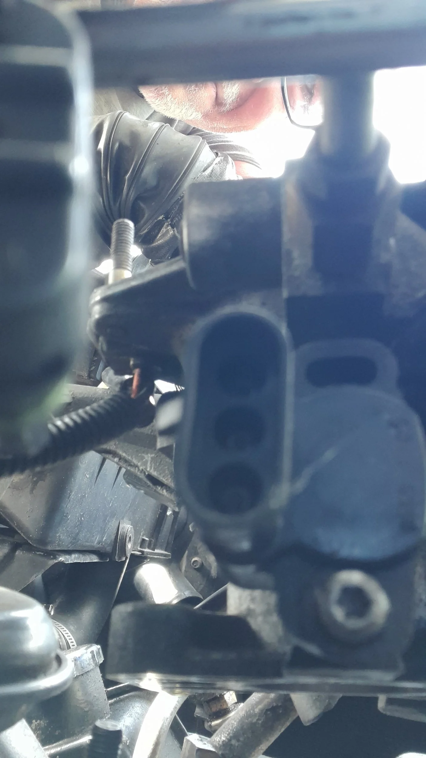

Another thing to do whilst you're down there is make sure the Throttle Position Sensor is working freely and rotates enough. Your bay is a little dirty so the TPS may need a quick clean up and you're good to go. It's directly behind the Throttle body and under the shiny fuel inlet pipe - a little fiddly to extract but it' s worth a check if your puling the TB out anyway.

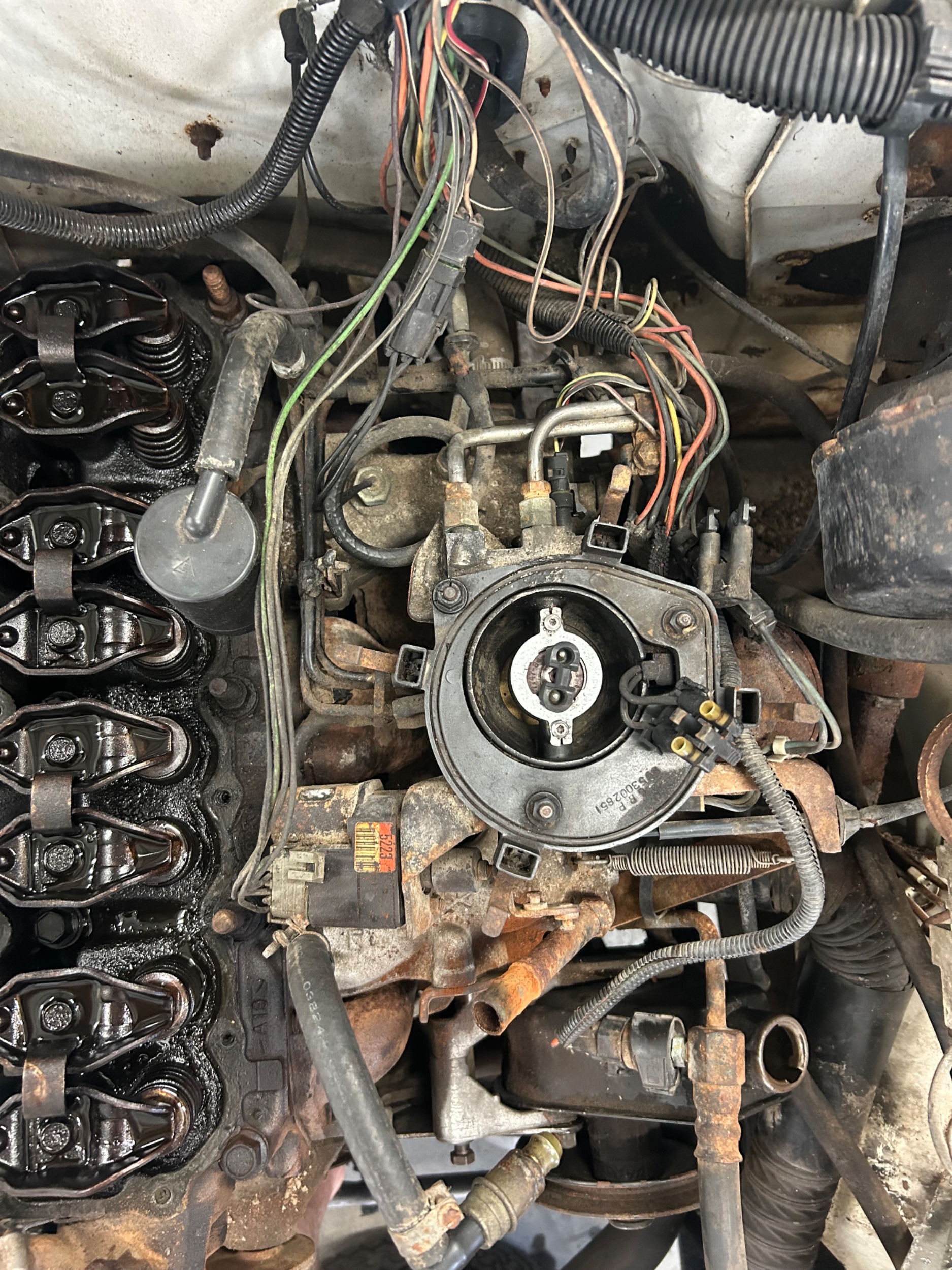

Here's my 1989 one looking a little worse for wear.
and here it is in situ from behind..bolted to the rear of the throttle body.

...edit - you mention that it's flooding pretty bad. This possibly indicates what I mentioned in the bit above. The power to the injector is always on and as I recall comes over from one of the the two yellow boxes on the passenger side of the bay / or one of the two relays bolted to the side of them. You should be looking for at least 9v hitting the injector on the live wire. The ECM via terminal 21 is actually sending a negative and it pulses the injector off and on to create the fuel spray under high pressure. So the NOID lamp may be your best cheap tool at this point. It really helped me and you can always sell it afterwards.
