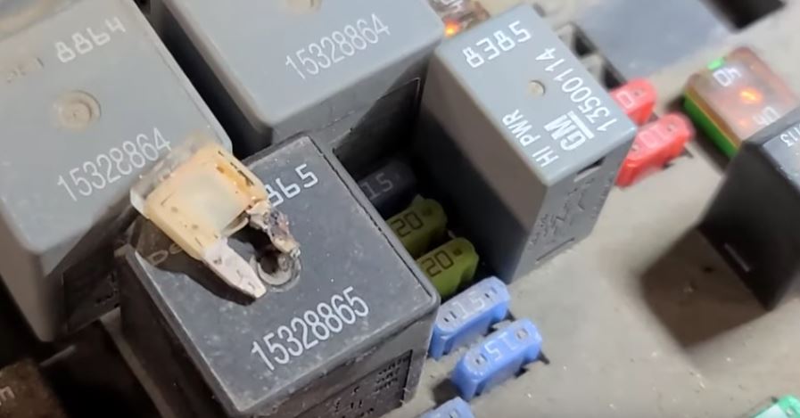

like this, just to show you how easy it is to fail. 30 year old cars fail in very odd ways, IT"S OLD, time and dirt + water and salt damage
FUSE damaged. (more than one , hint hint)
