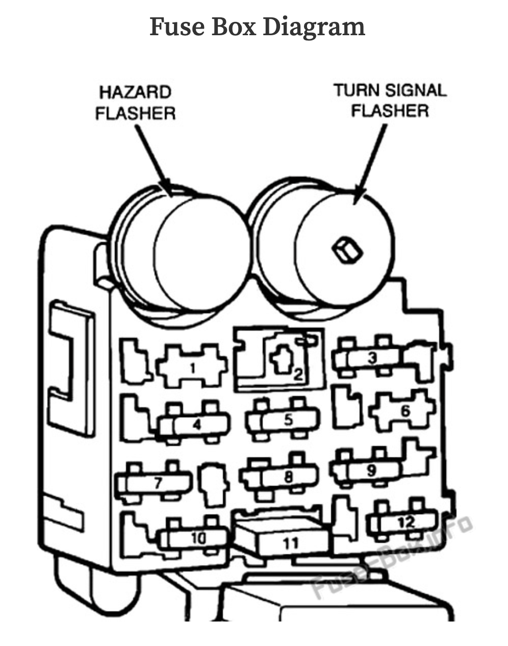

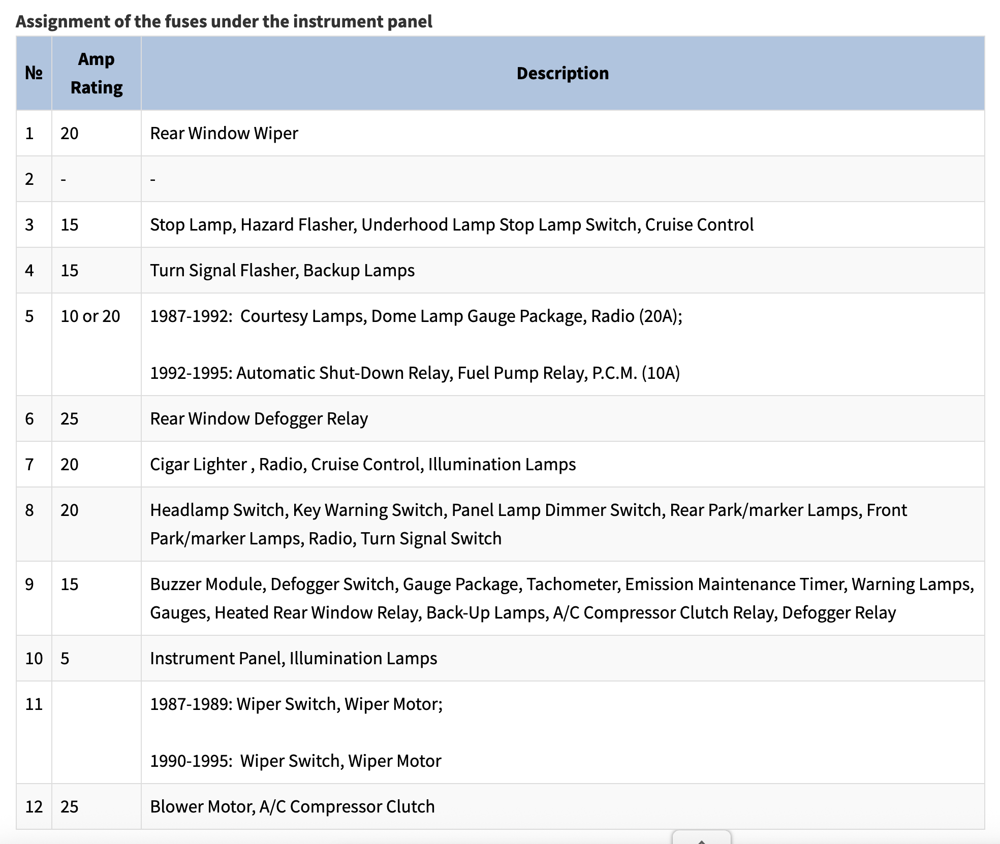

Thank you in advance. see photos.

It sounds like you’ve been methodical with your troubleshooting. Based on what you’ve shared, it sounds like you’re likely dealing with a fuse related to the engine management, specifically dealing with the fuel pump and computer systems.
For the 1995 YJ (2.5), the fuse that typically affects both the “check engine” light and the fuel pump operation is the “Engine Control Module” (ECM) fuse. You should find it in the fuse box under the dashboard. It’s usually a 10A fuse, but it could vary depending on your specific setup.
Given that you’re seeing no “check engine” light with the key in the ON position, it’s definitely worth checking the ECM fuse for signs of corrosion or damage. If you find any issues, replace the fuse and make sure the connections are clean. If the fuse is good but still not making contact, you might want to consider cleaning the fuse box terminals as corrosion can impact those connections.
Additionally, make sure to check any ground connections related to the fuel system; poor grounds can sometimes lead to similar symptoms.
Once you've addressed the fuse issue, try turning the key again to see if the “check engine” light comes on and if the fuel pump primes. Best of luck, and keep us updated on what you find!
