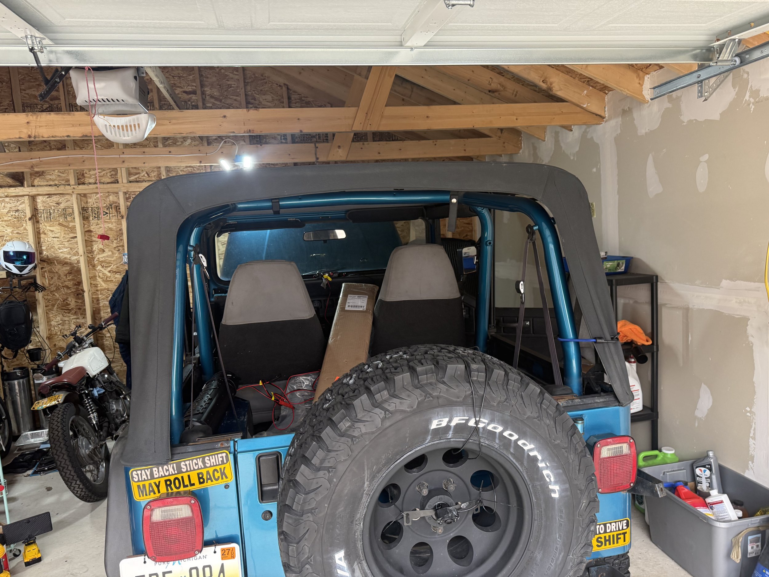

1993 YJ first build
Ledhed14
Feb 16, 2026
17
Detroit
Hello!
Making this post so I can track my work and share it as I go along.
I bought a decent condition 1993 yj. I live in Michigan. Told the owner I’d pay full asking if he drove it the hour it needed to go to get to my house. I considered that good enough of a test drive for me considering it was very cold and very snowy. It runs like a top and I can’t find any issues with it in the time iv owned it.
General look was:

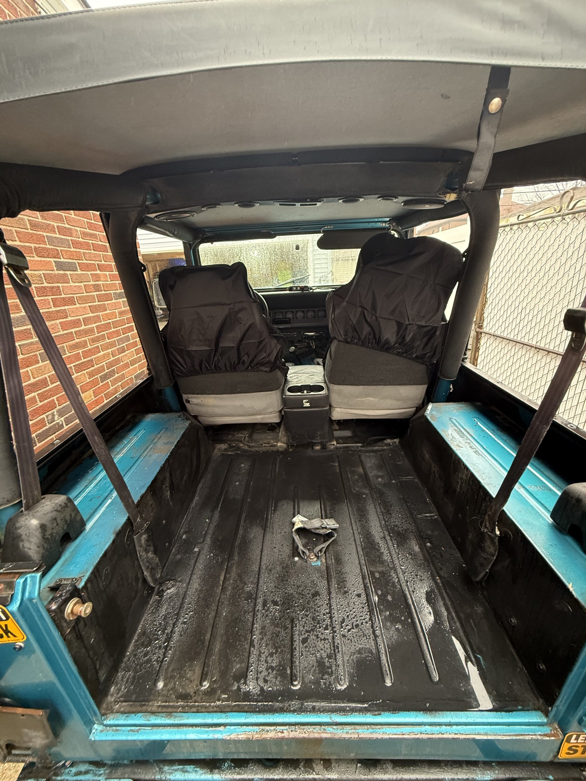

Interior was very dirty and well used
Back seat and carpeted wood needed to go
Missing the back window panel
rusted out fuel skid plate under it
Top and windows need replacing
Body and frame workable but some rust damage
Mostly stock as far as I could tell
Started with removing and cleaning everything I could get off it. Removed the rear seats, all window panels. Washed everything real good, sprayed some primer/ rust converter.

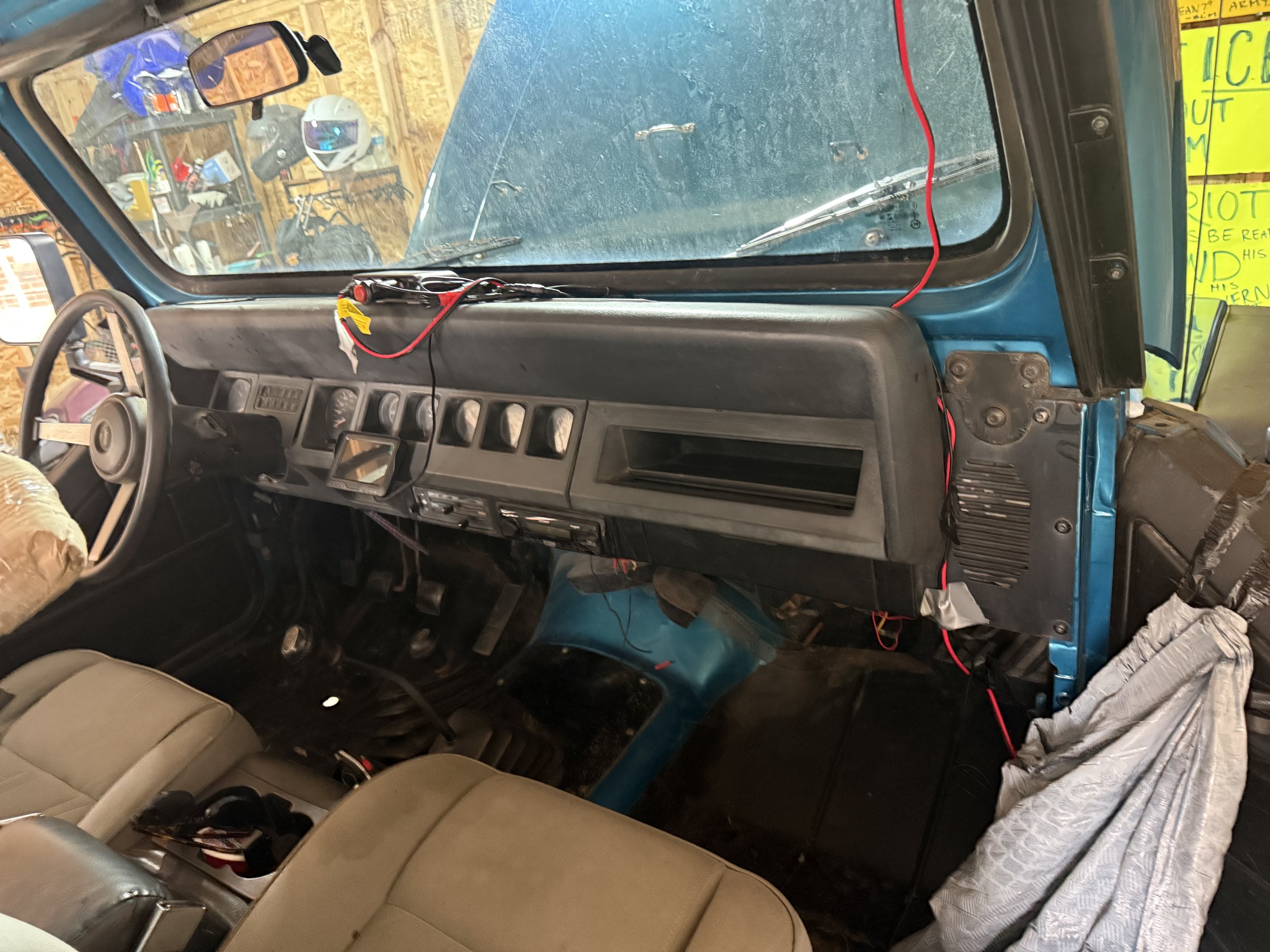

Next i started with electrical. Radio/speaker worked(pretty sure they are aftermarket) but the cigarette lighter didn’t. Removed the entire housing and installed a new power source, with an on off button connected directly to the battery. Location will likely end up being moved. Found tons of dead wires I know I’ll have to attack.

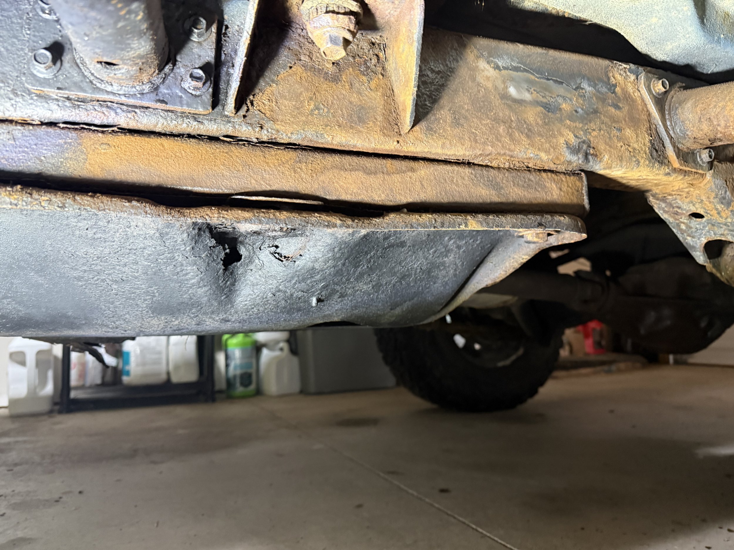

Next was the underbelly. There are issues, but everything around those spots are in solid condition still. I took a wire brush to what I could and sprayed it with rust converter. Might go back after and add bed liner.
Before: after a bit of light sanding
After:
Up next I’m bringing it to a shop to replace the skid plate, fuel pump, 20 gallon conversion, and fuel filter while he is under there. I know I could probably of done it myself but the labor charge was cheap enough and it’s a chance to find a good shop nearby.

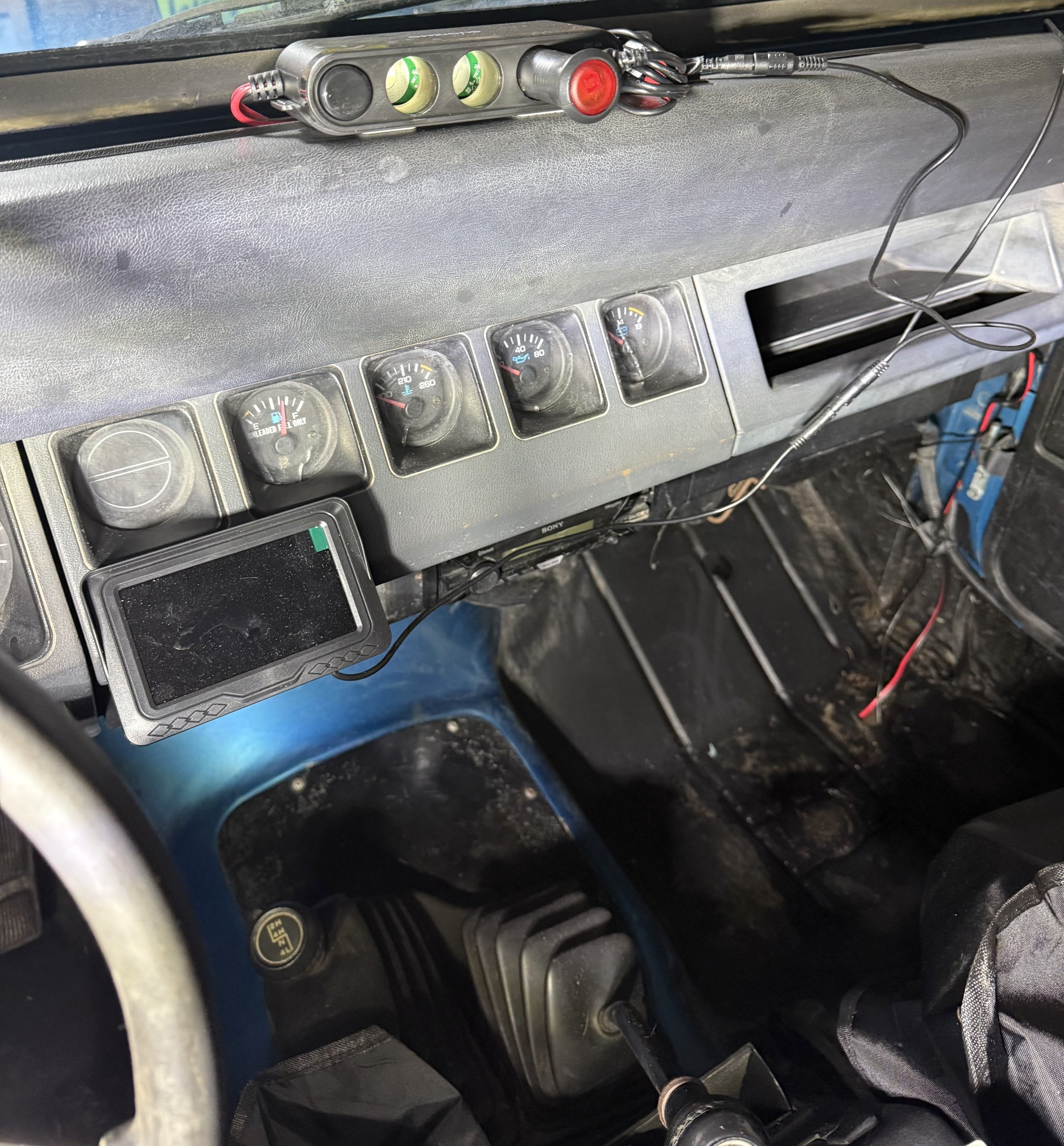

I was able to remove all of the zip on cage pads. Took a bit and needed some lube but got it done. Additionally I was able to remove the existing speaker and all wiring connected to it. Rat nest of wires has been dealt with! My current wiring is all temporary (hopefully). I have a few more wires to attach but I need to remove the radio first. If anyone has tips for this let me know.
Wiring Before:
After:

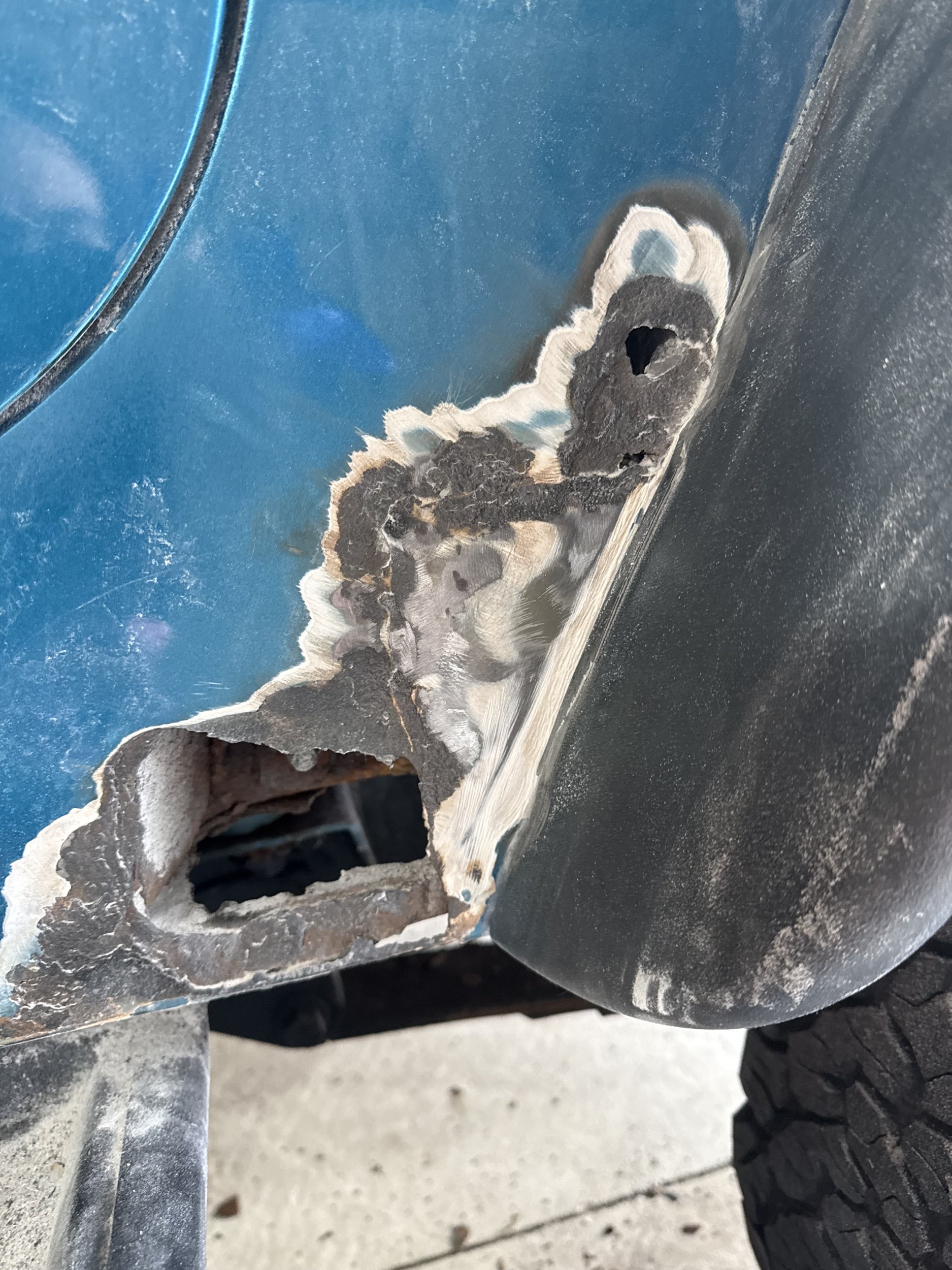

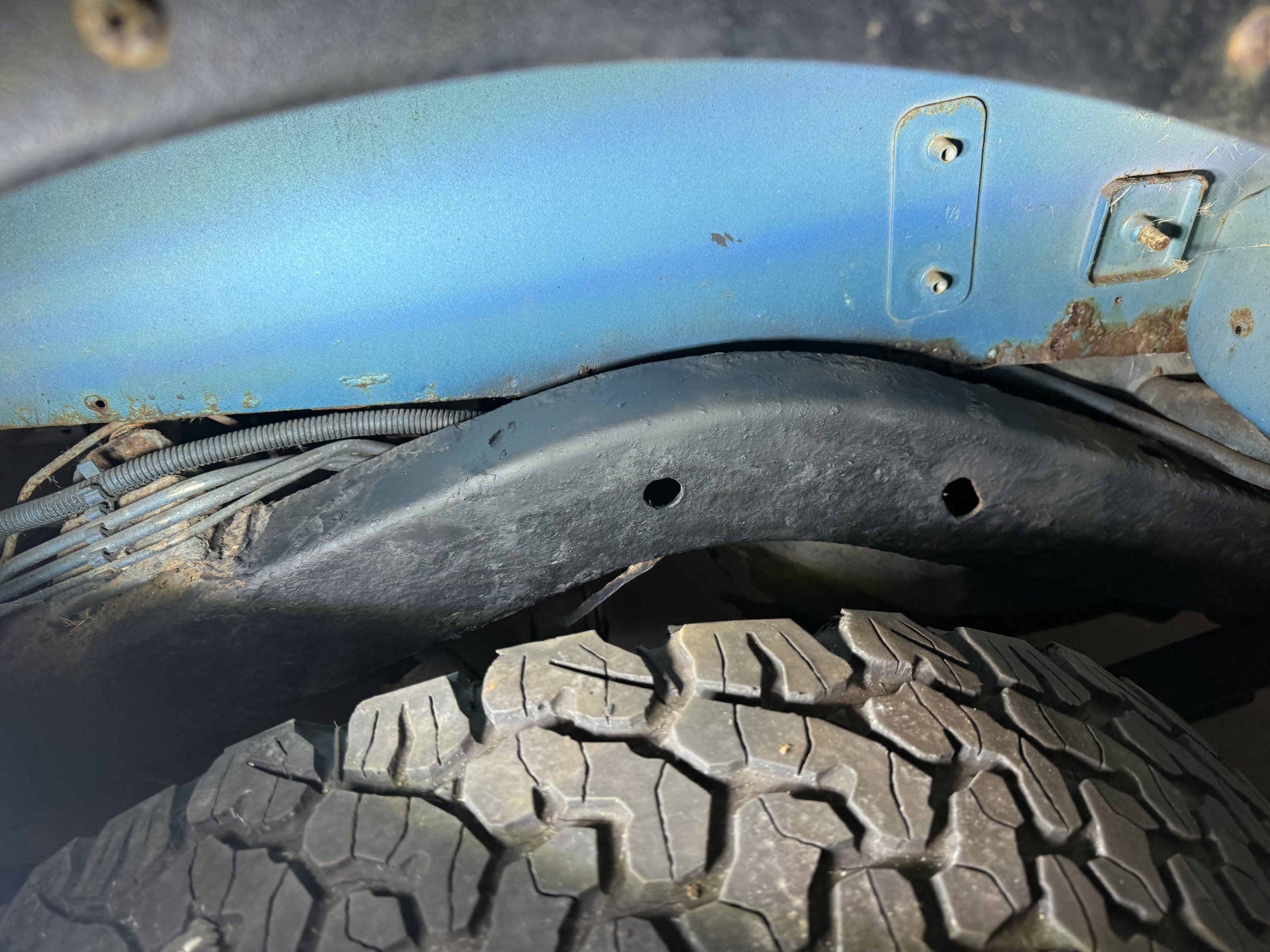

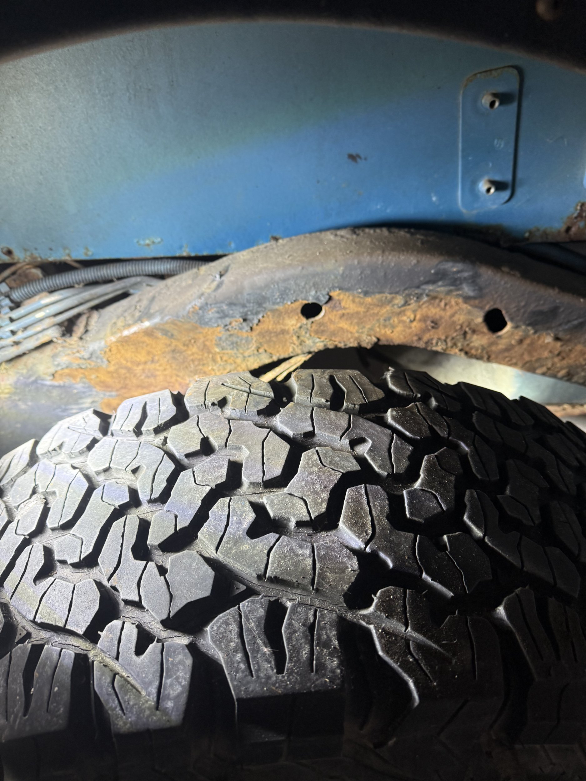

I also took on some rust removal. On both sides there is rust body damage directly under the doors towards the back tires. It was bondo’d over and painted but the paint was starting to bubble so I knew I had to address it when I bought it. It will be 90% covered by the rocker panel I have, but I want to get to and mitigate as much as I can before then. Using a magnet and a wire brush on my drill I was able to fully expose the extent of the rust. I wire brushed everything I could get off it and as close to raw metal as possible, and then sprayed with rust converter. Imagine this on both sides now sprayed with rust converter/primer. Color match Paint and clear coat on the way from scratcheshappen.com

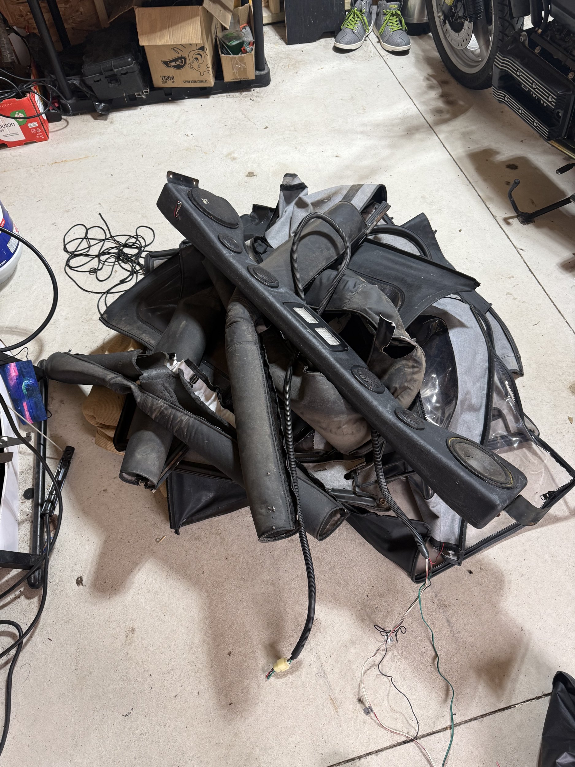

And finally the to go pile is really stacking up. I’m sure I won’t be able to sell much, but just seeing how much progress I have made by watching the pile grow.

Great work so far! I also couldn't help but notice the "flying brick" in the background of the last picture. I also own a 94 BMW K75!
Was the speaker bar still working when you pulled it? If so I may be interested in it.

Yes it was working but I can’t say how well. When I removed it I cut the cords(no big deal to just wire new ones to what’s left) and it has a missing speaker cover on one side. I’d sell it to you for a few bucks over shipping if interested. I’d love to have it salvaged instead of taking up space in my garage

I would probably put new speakers in it anyway. I'll send you a PM about it!

...Rat nest of wires has been dealt with! My current wiring is all temporary (hopefully). I have a few more wires to attach but I need to remove the radio first. If anyone has tips for this let me know.
Would love to hear more about the rats nest wiring and what/how you tackled or plan to tackle it...I am in the same position with a '91 - my wiring is crazy!!...but it is mostly working...somehow. So outside of the obvious of just cleaning that stuff up...and a goal of just stabilizing it and making it safe...where do/did you start? Or anyone who has been in this situation before...

You have my commiseration. I started by identifying systems I was replacing or removing. I removed the radio and speaker and replaced it with a giant Bluetooth speaker. Might be worth considering if you want to upgrade tunes but don’t care about 30 year old hardware.
Once I did that I just snipped and pulled. A ton of the rats nest was running back to the speaker. Removing that I was able to pull out a ton.
My goal for this is to be pretty bare bones, which I know is not always doable or what you are looking for.
I was left with a few cables that I was just able to hook up and under. So it probably looks better than it is!
