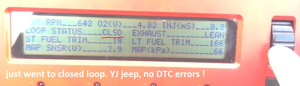

how ever I can scan this car with my OBD1 scan tool MT2500 (with jeep cartridge 1099) 'SNAP_ON" tools.
and see all DTCs live, even driving.
I can scan all the sensors. to see if one reads wrong , driving. or at any time, key on.
it can report outputs of relays dead, say to the pump.
or worse code 42 ! (the stall code)
I can see this and lots more with this great tool, $200 used cost.
it is a biDirectional tool ,it has an actuator test mode, for relays and injectors and more. ( new and or good 02 is mandatory 100k mile life span)
the right knob there, I scroll and see them all !
