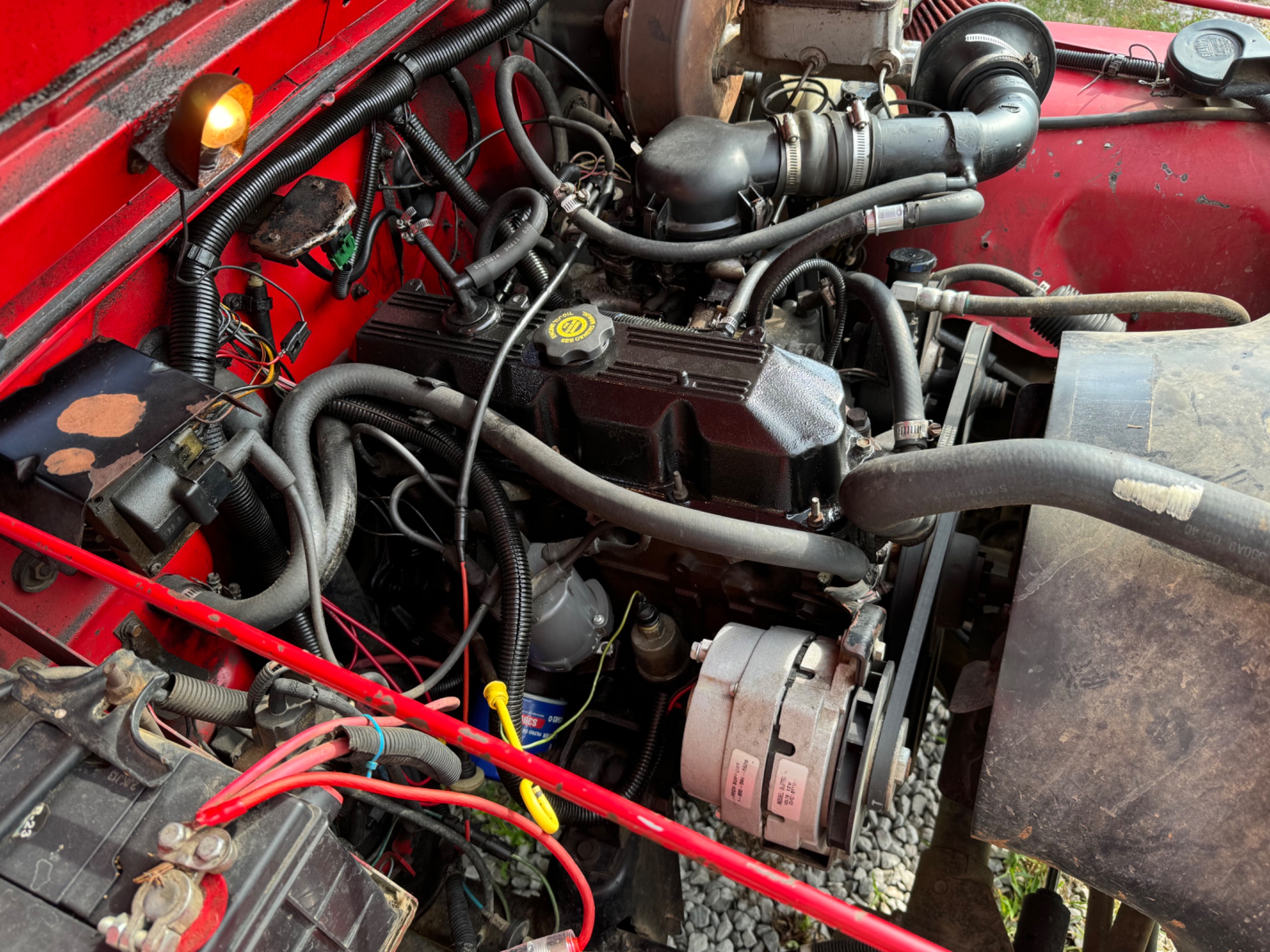

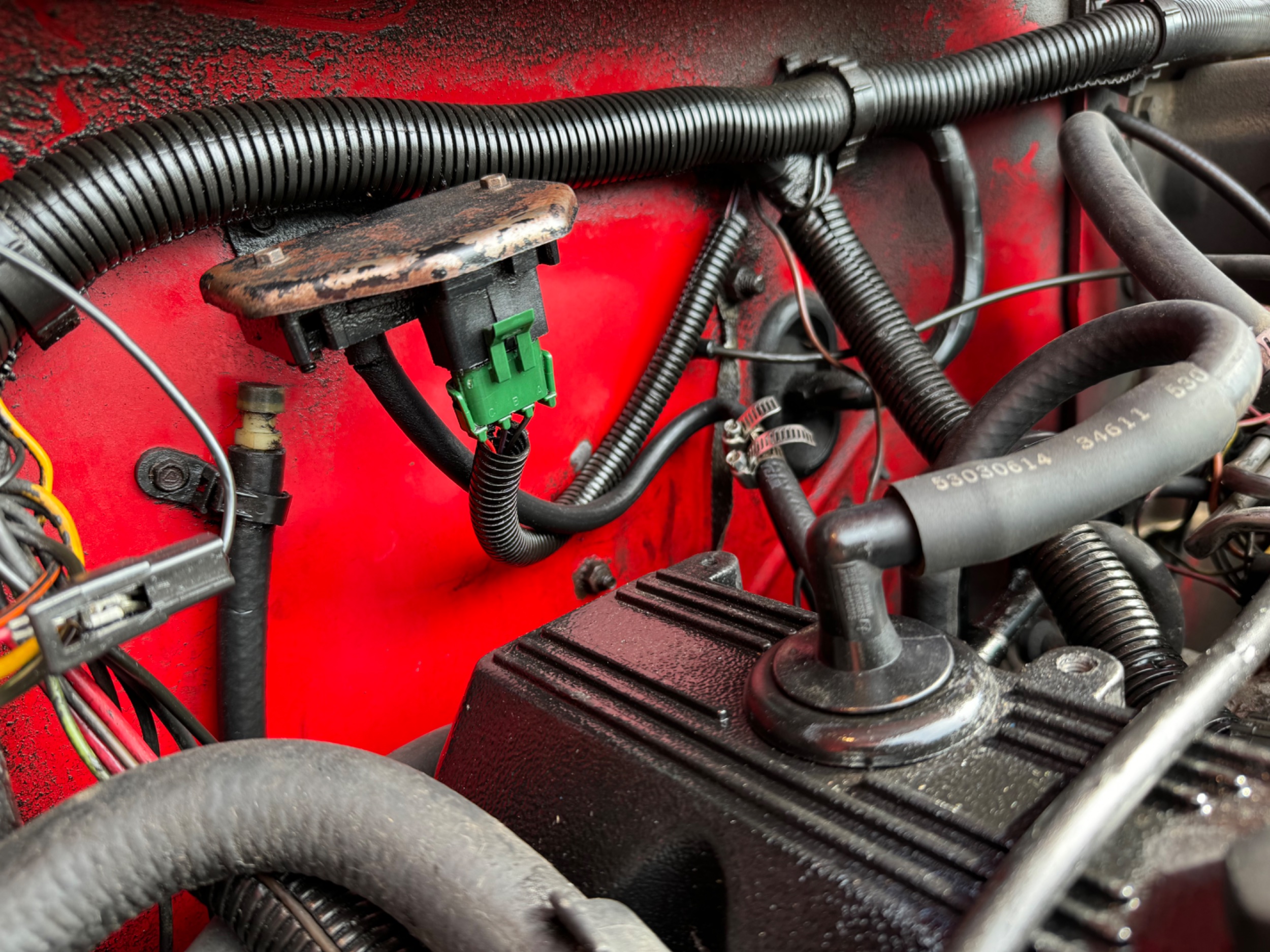

Right side - love that aluminum valve cover - no more top oil leaks, at last! Notice how I had to graft in the 1990 PCV valve which draws in crankcase fumes through the existing CCV orifice that was left in the valve cover. My 1990 uses PCV but 1991 and up switched to a metering orifice (CCV) instead. I also removed the 1990 “can” at the rear of the valve cover that perhaps helped filter air being drawn into the engine by the PCV system.

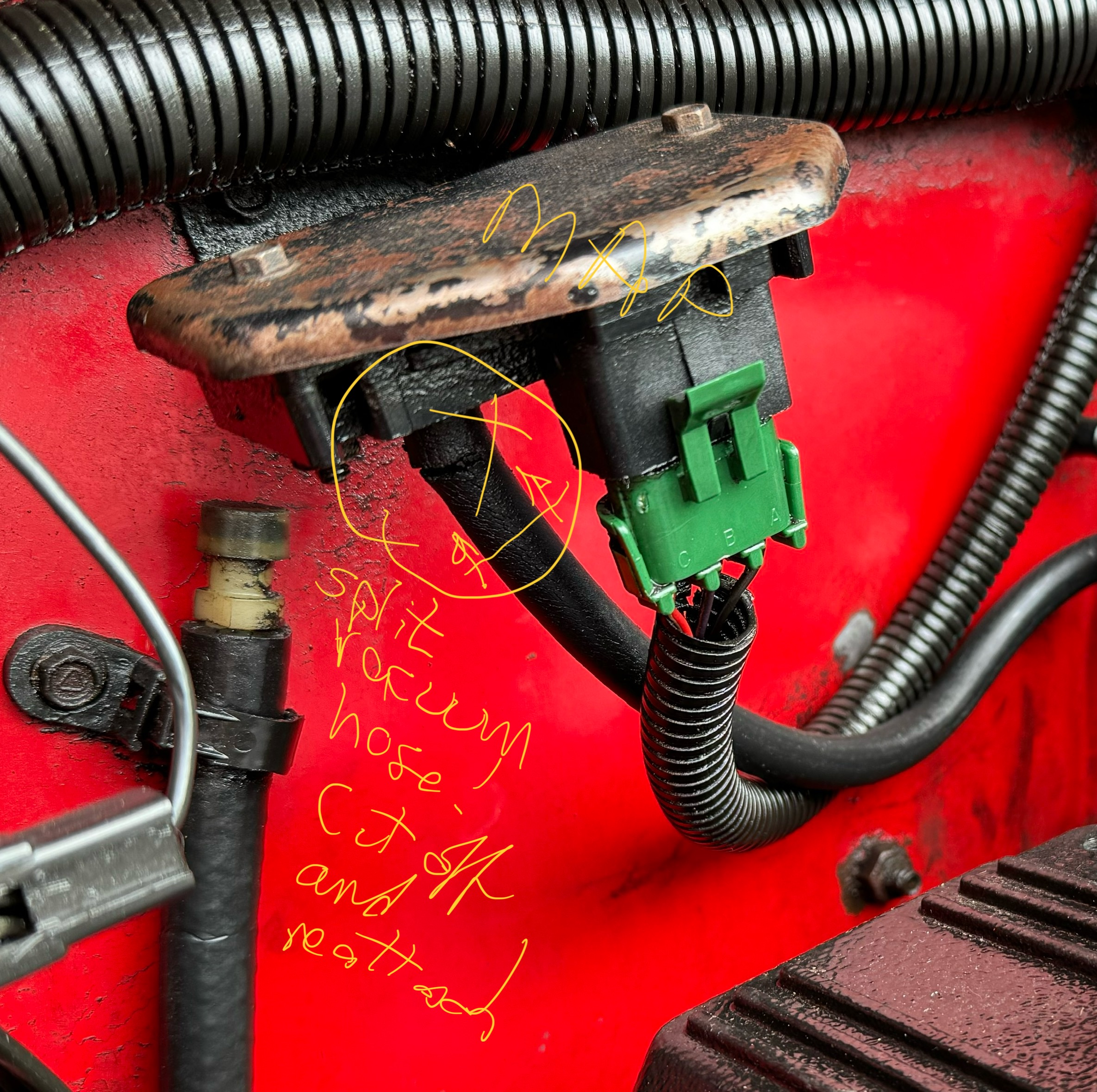

Kept the 1991 clean air grommet and used its “fat” hose to slide a smaller diameter hose from stock system, did similar up front. Note the MAP sensor on firewall. See that thick hose just below and left, secured to the firewall and having some sort of valve or cap on it? I think it is part of the vacuum system for the 4WD.

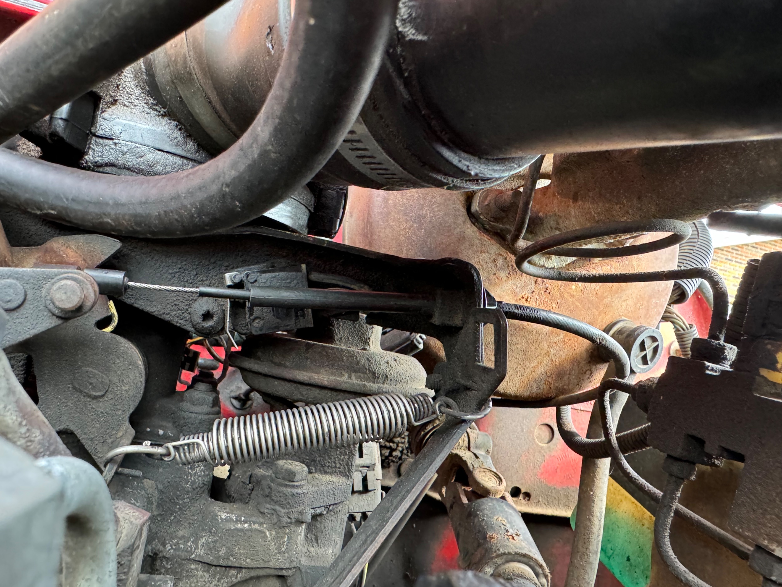

Front side of throttle body. Some sort of throttle switch, engaged only at WOT? If there is something more of a TPS, where is it?

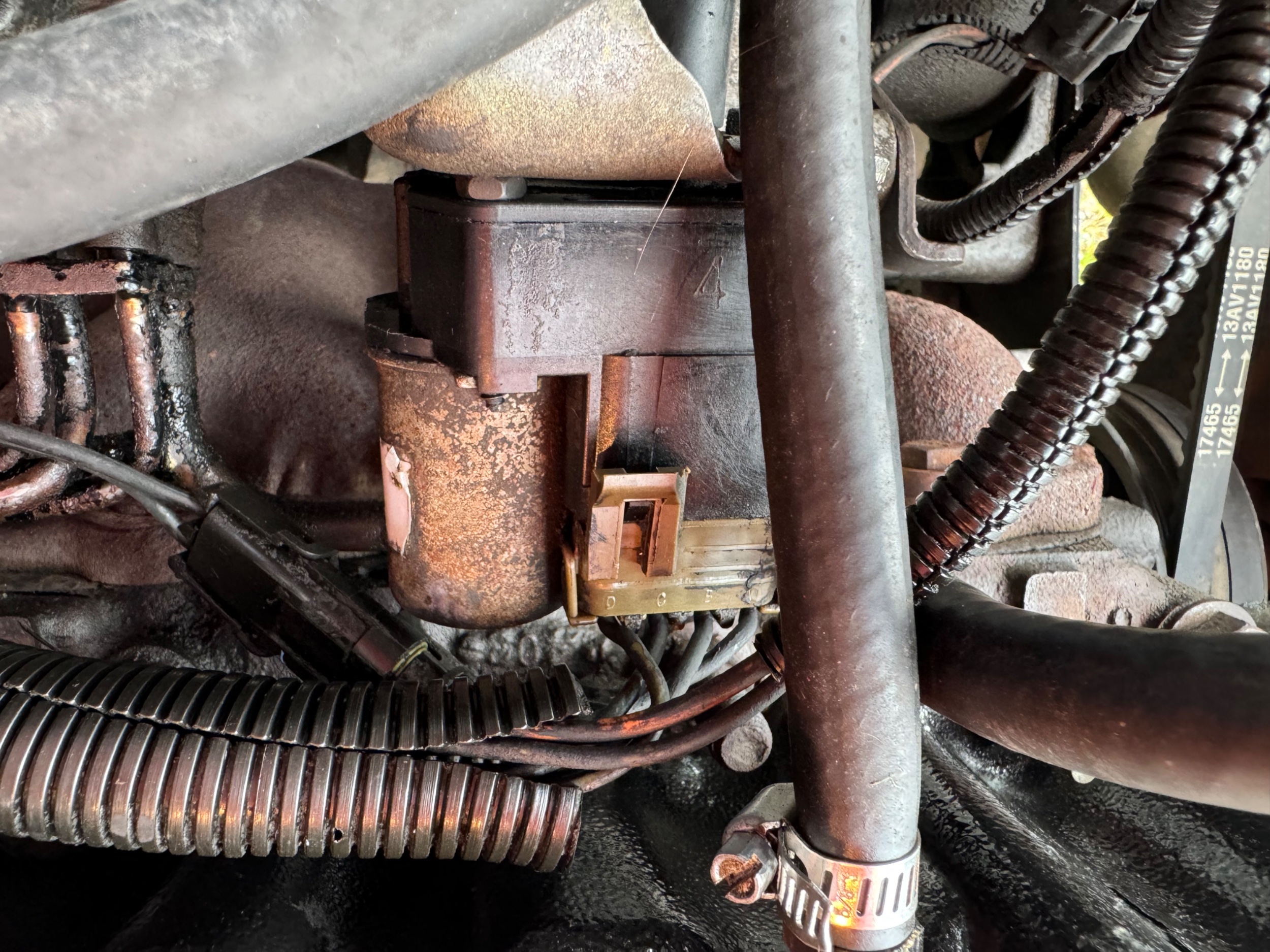

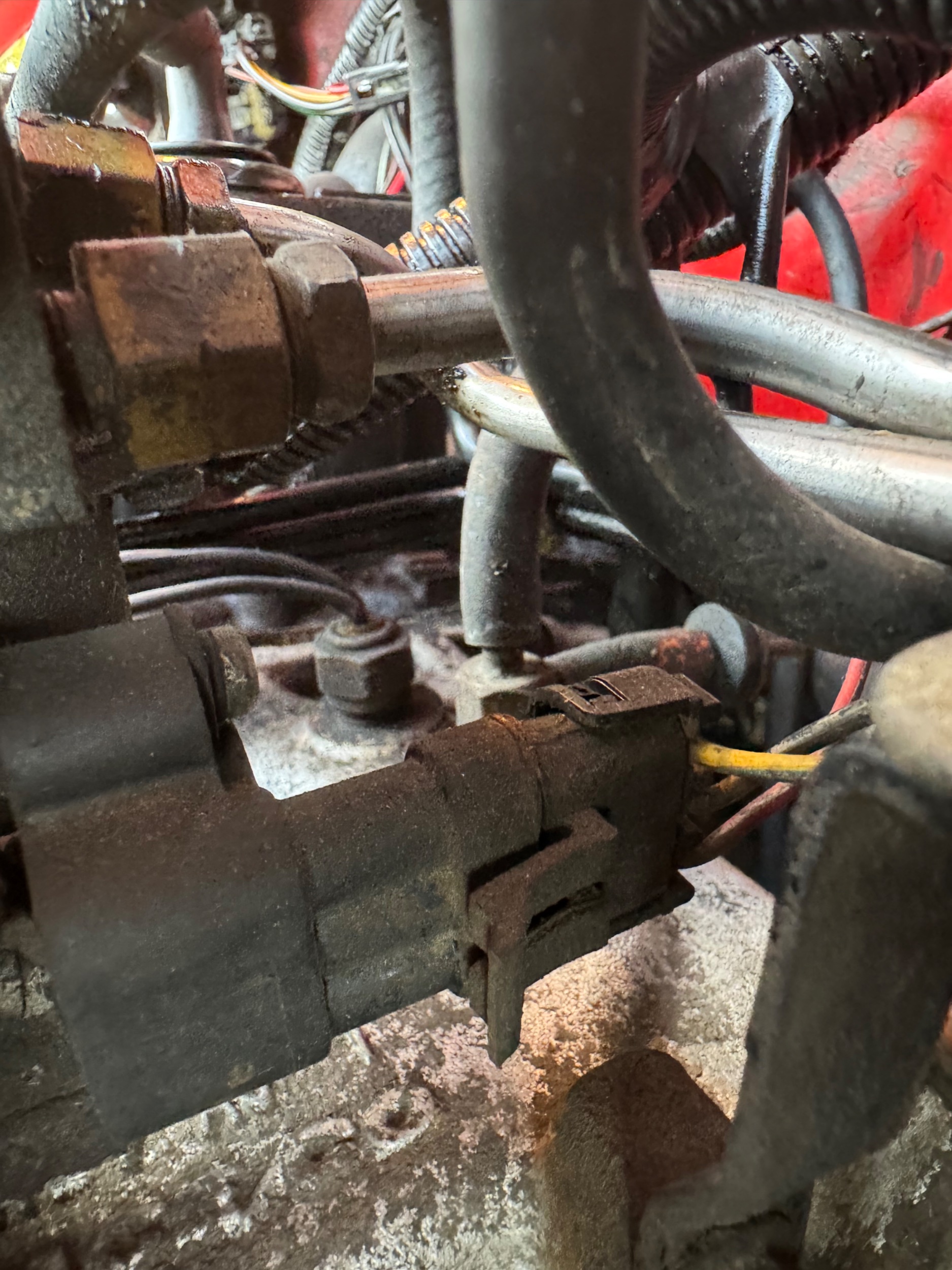

Detail view of the IAC, I believe? Do I remove this and clean it along with an orifice that it uses to allow air in as the PCM dictates?

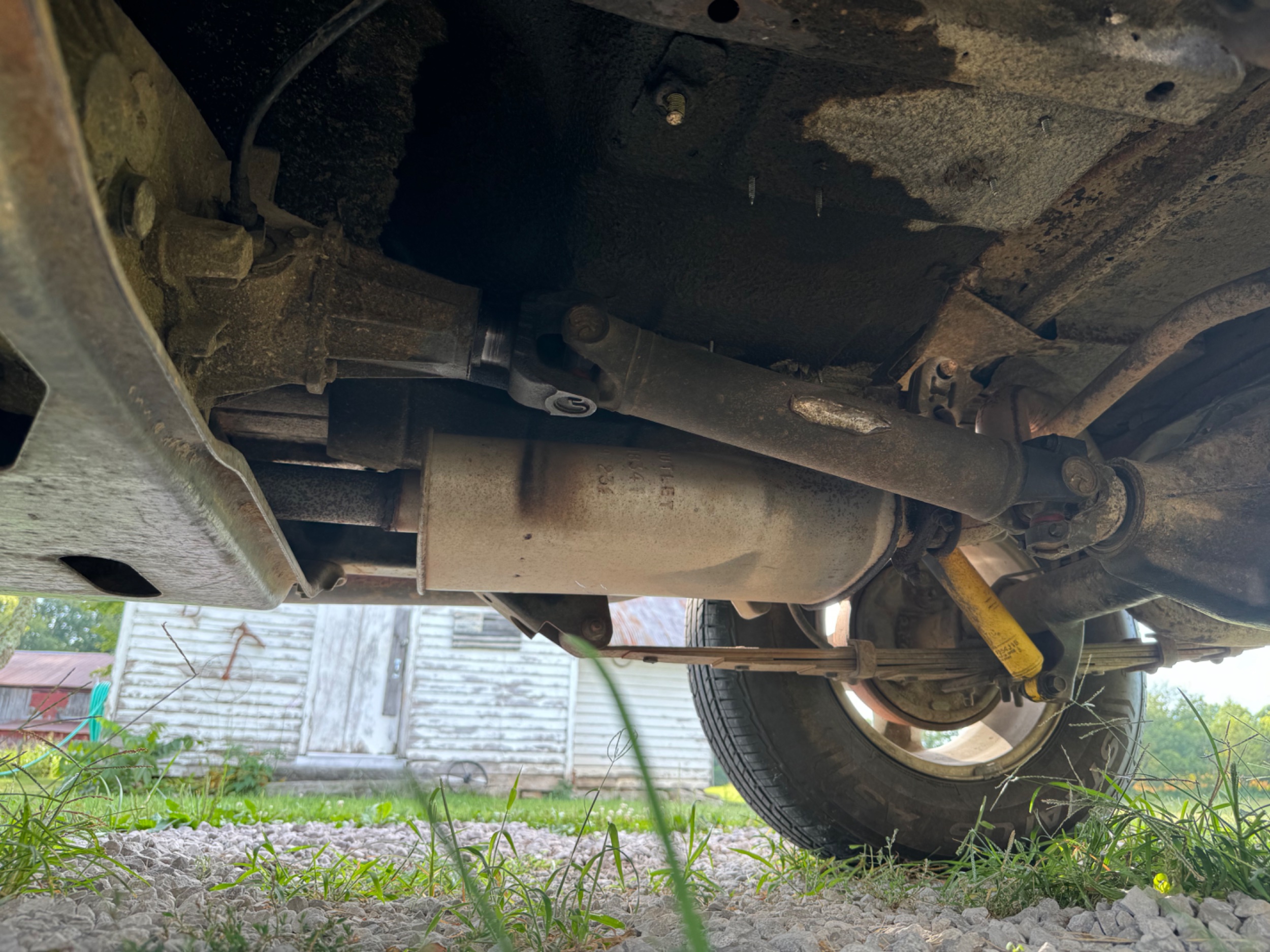

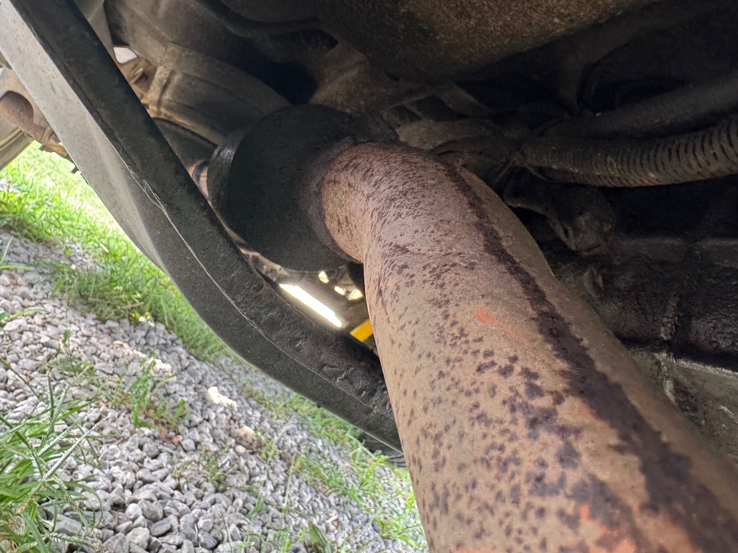

Exhaust manifold has an O2 sensor with 3 wires. There’s an open fitting at the front of the down pipe maybe three inches below the flange where it meets the exhaust manifold. I think they welded this opening shut as no gas escapes it. Note the crimped air tube running down from the EGR valve that perhaps used to go to that pipe opening?

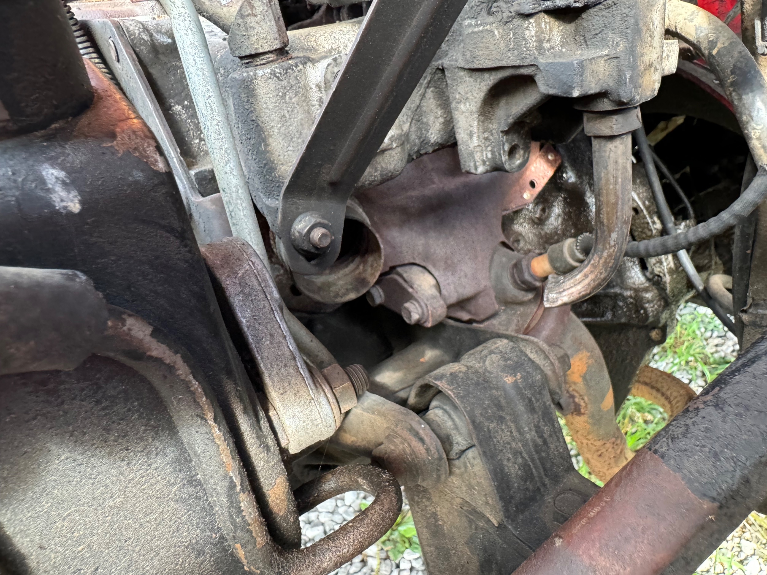

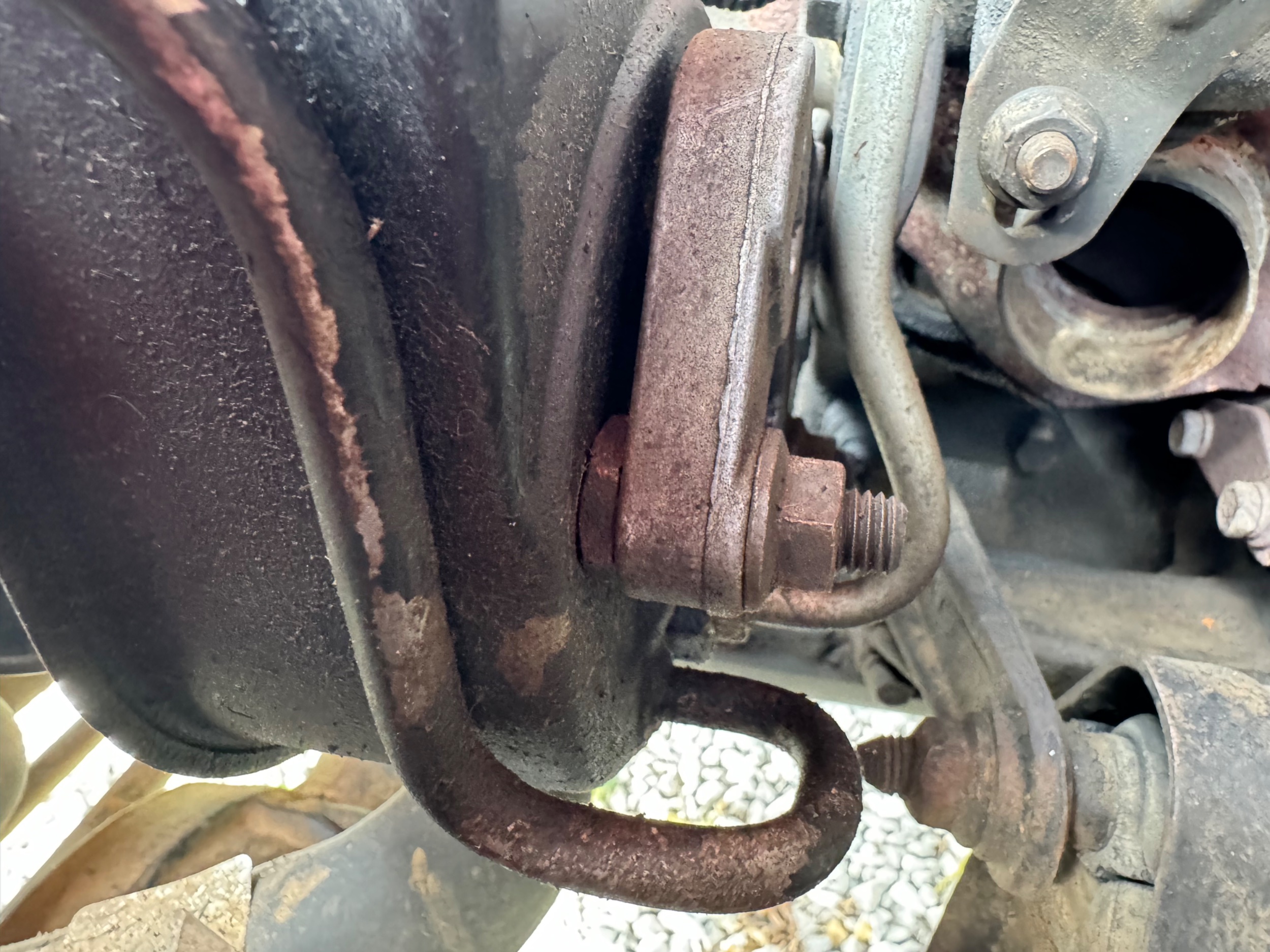

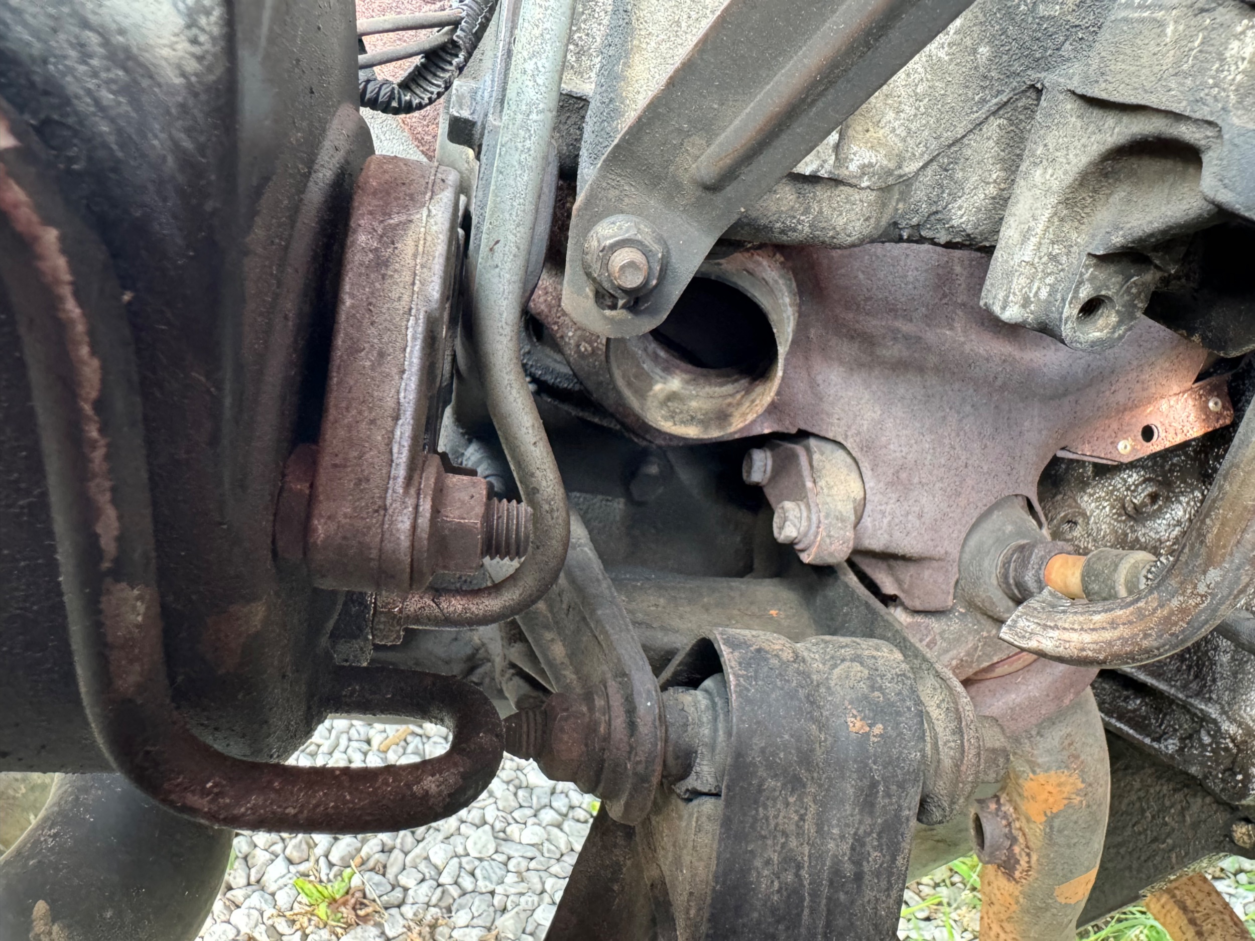

It sure was fun addressing the lack of power steering early on! Replaced just about everything involved including the steering box itself.
Another view of the exhaust area at the engine showing better the distance from the crimped air pipe to the opening on the down pipe.

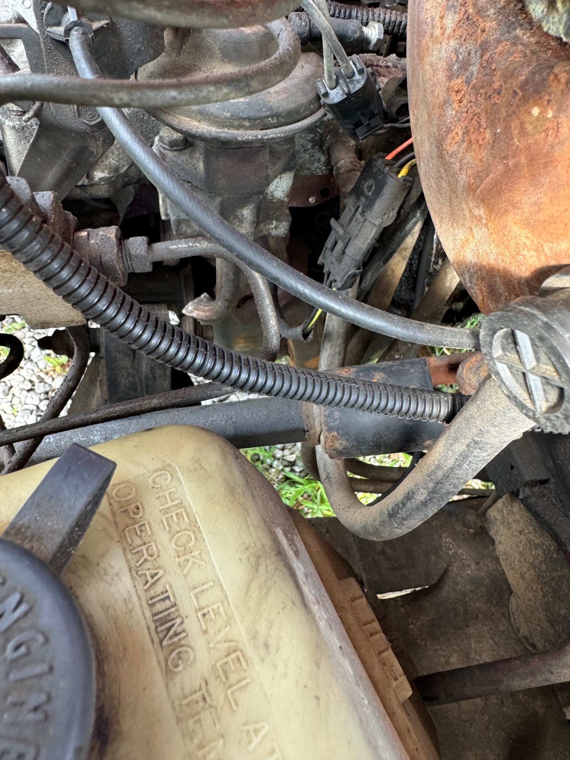

Top view of the EGR valve and its relation to the throttle body. The EGR valve has a block-off hose, so no vacuum gets to it at present. Unless the EGR has another way to receive and admit exhaust gas into the throttle body I’m not sure what good it would do to restore vacuum to it - as long as there is no vacuum leak elsewhere! Initial checks find no vacuum leaks anywhere.

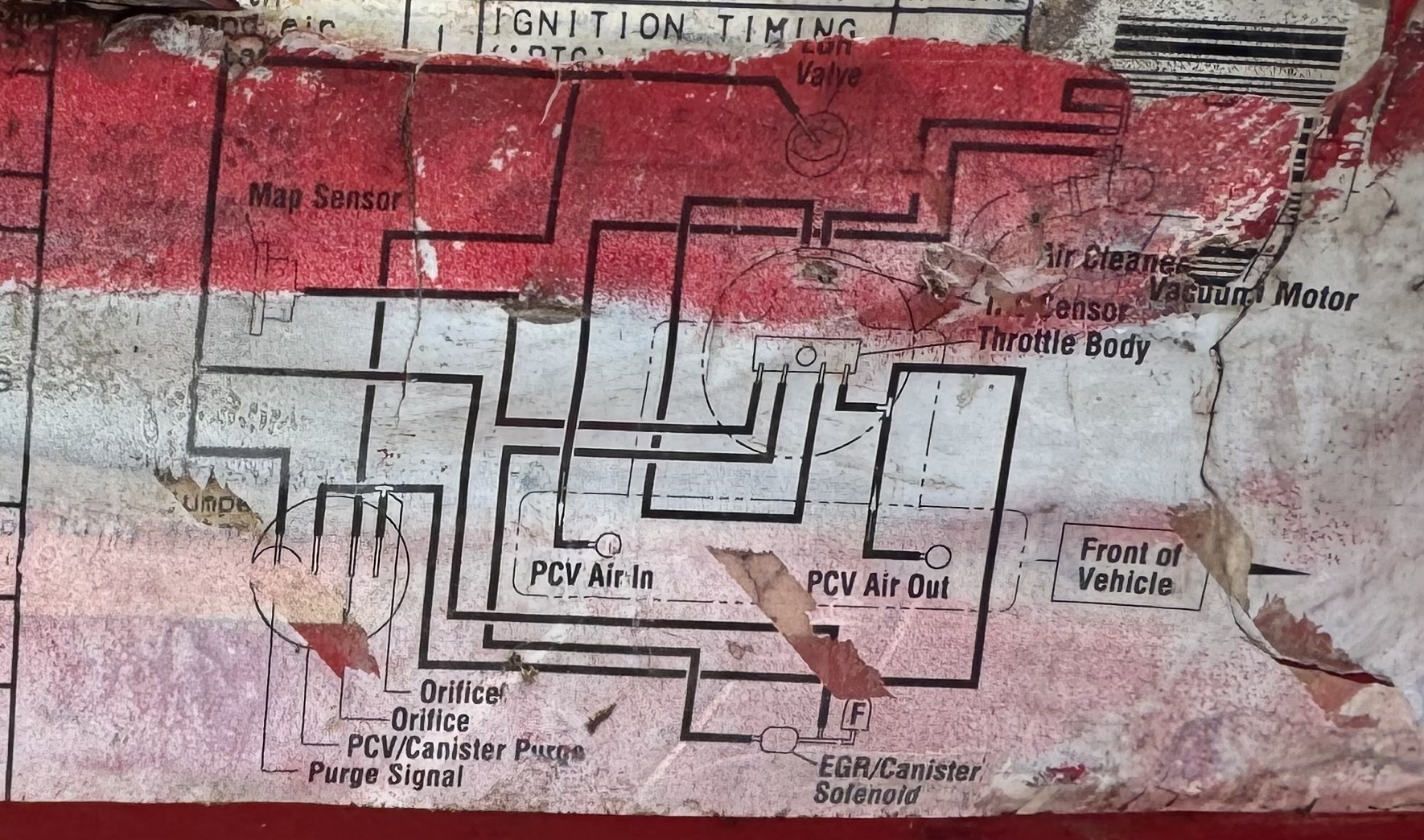

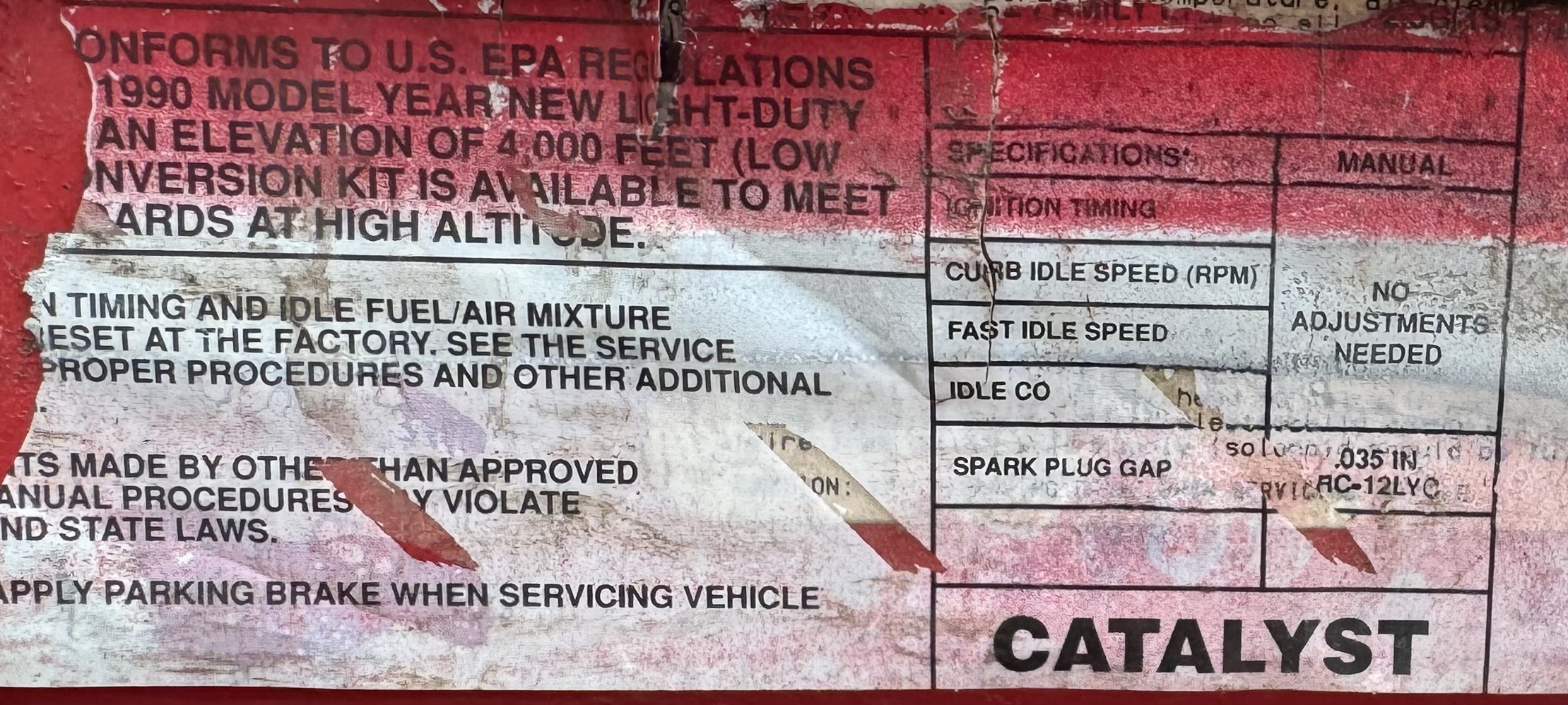

Here’s my factory emissions label - was glued in the proper location on a replacement hood! Original hood was crushed after a tree fell on the Jeep - per the prior owner!
