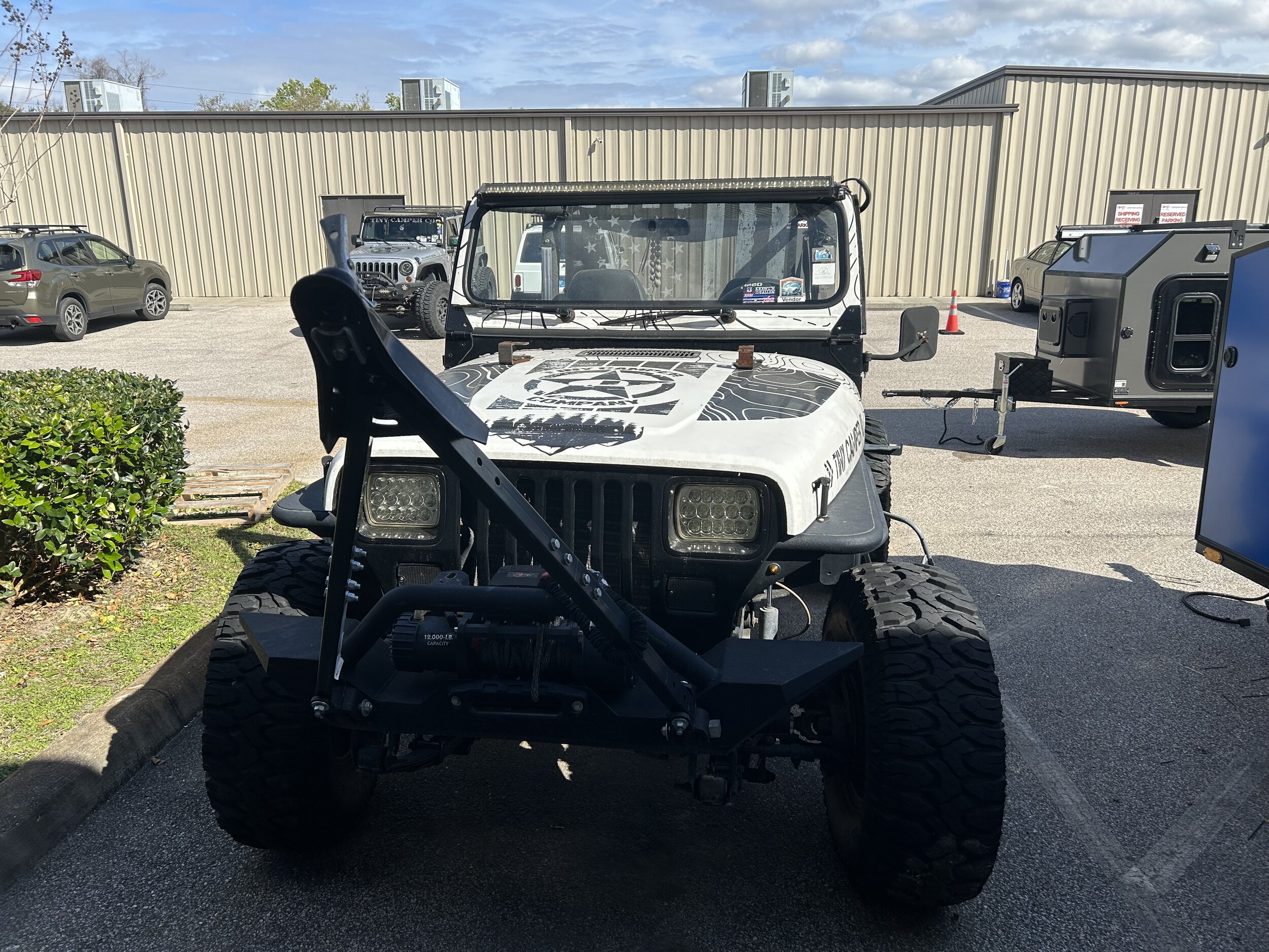

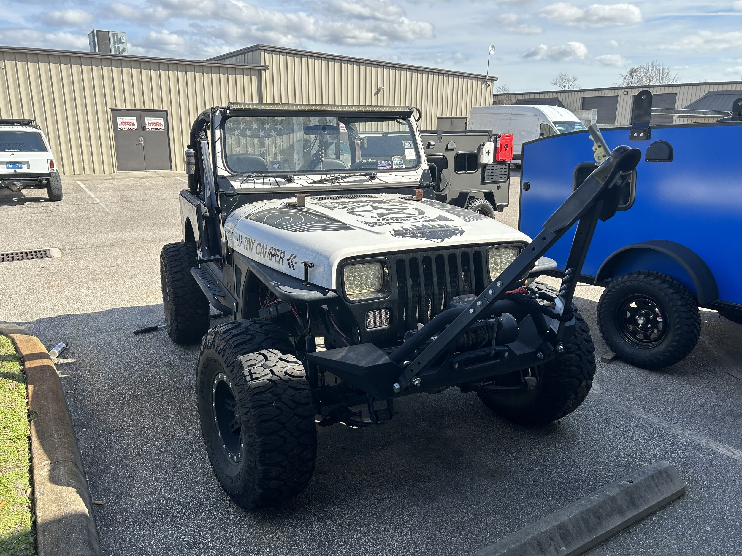

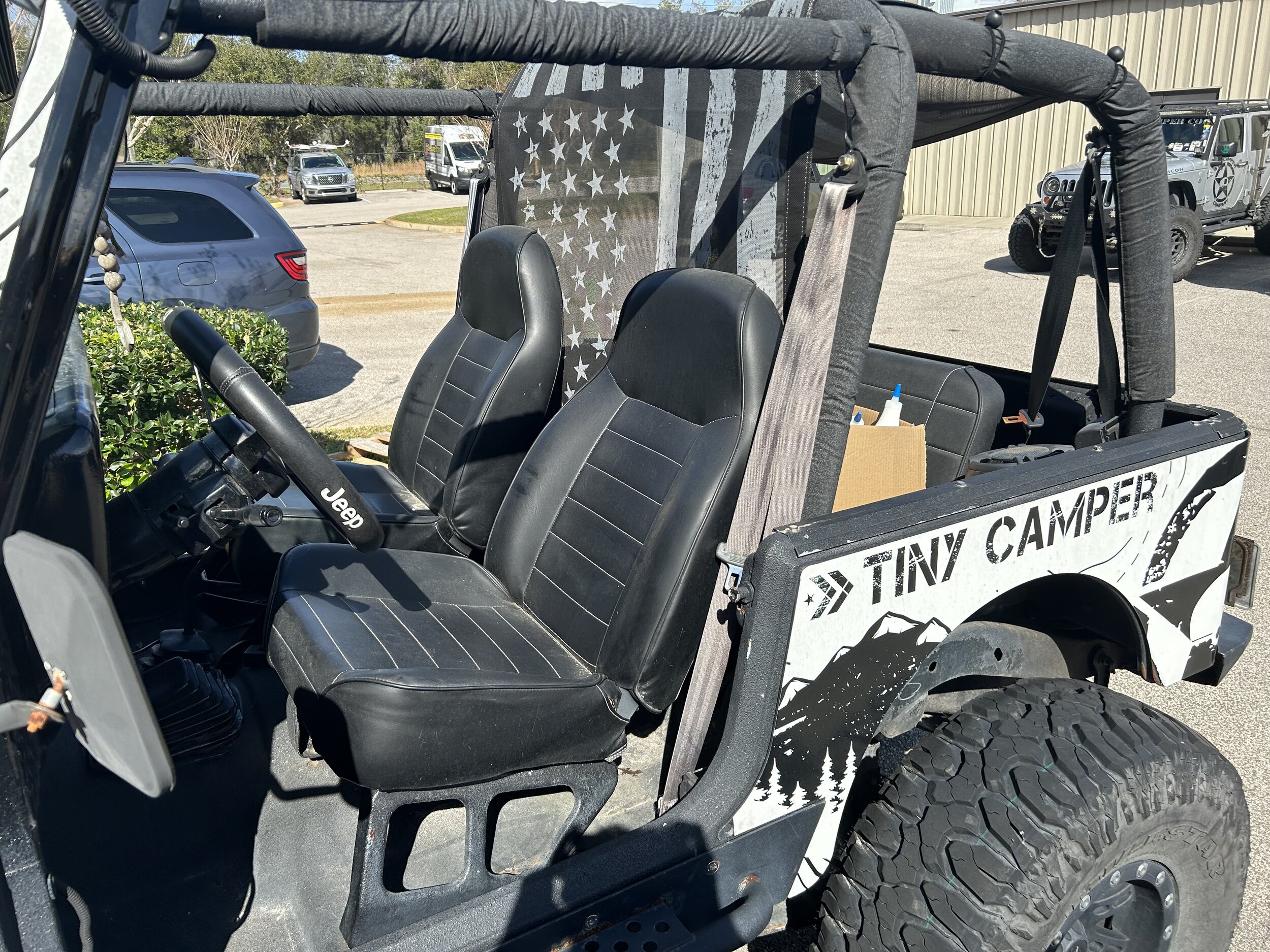

I took pictures of the outside right before I left but forgot to take a picture of the burnt up fuse box. He’s replaced the fuse box and has some wires in some out but is saying it’s not the right fuse box or something. For those who were wondering (sorry I didn’t specify before 😅) it’s a straight 6, 4.0L engine. The car has some rust here and there but not to bad. If I can figure out how to post pictures here I’ll do that. Also, it doesn’t look like the fire effected anything but the fuse box
Here's some pics
