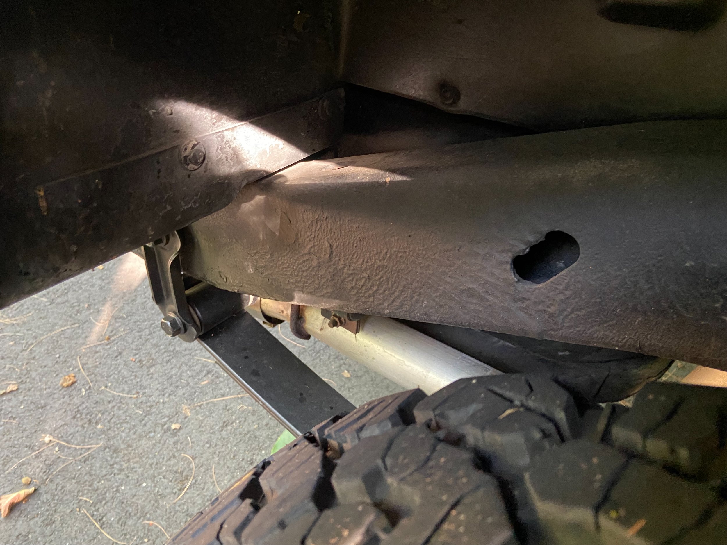

This is the rear leaf spring aft mount detail. The area around the shackles is prone to corrosion. Just to the left and above is the aft most body mount. If you ever plan on installing a body lift or replacing the bushings, proceed with caution as these bolt are prone to corrosion and can snap off when trying to remove them. I recommend that if your bushings are in good shape to leave them alone. This goes for all of your bushings.

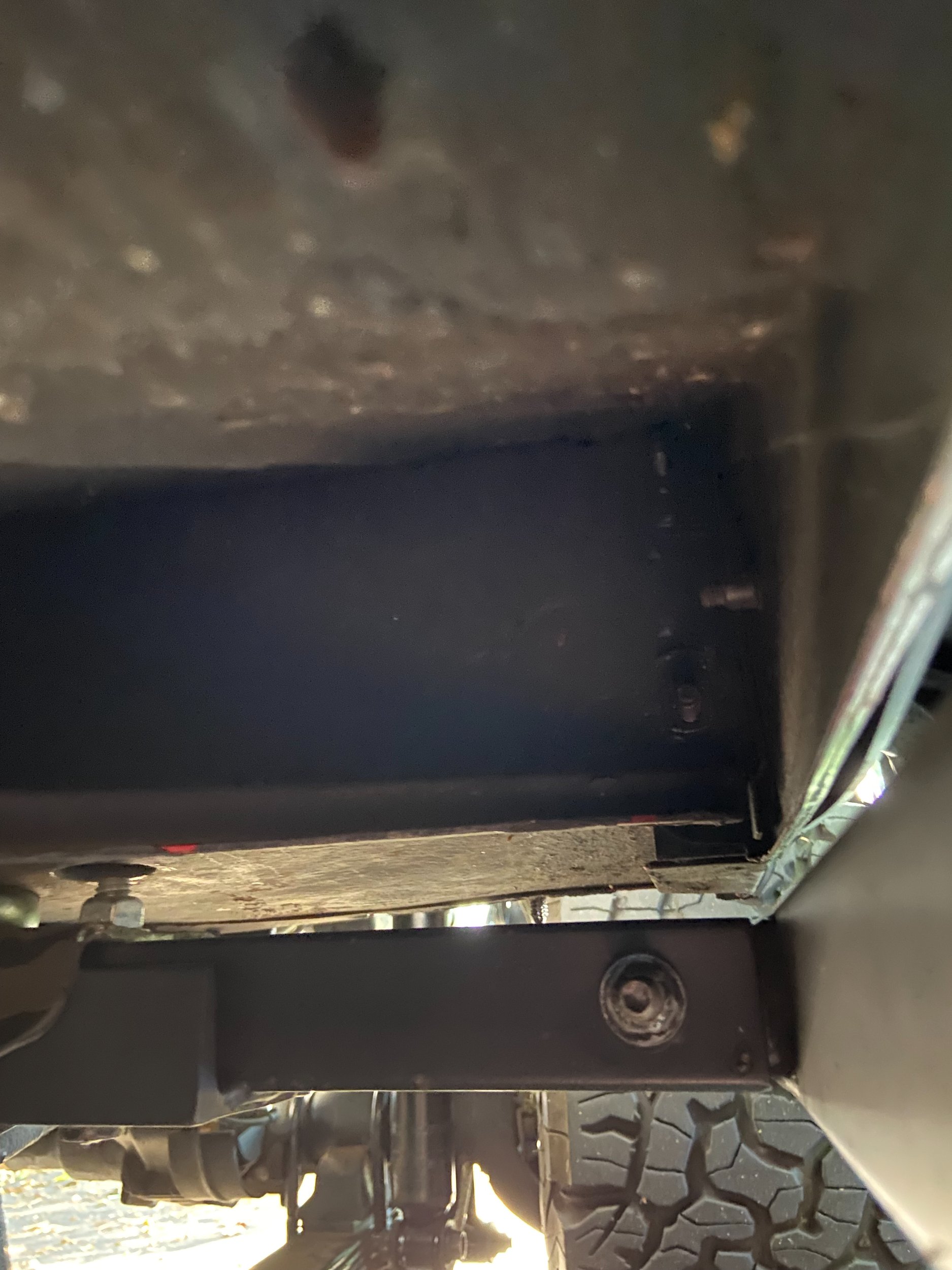

This is the frame cut-out located above the back wheels. They're put there in order to strap the Jeep down on the transportation trailer when delivered from the factory. If your YJ has been wheeled a lot in it's past life, chances are water got in there and over time may create rust from the inside out. This is a good place to apply the spray Will was referencing since it displaces any water and coats the inside of the frame..

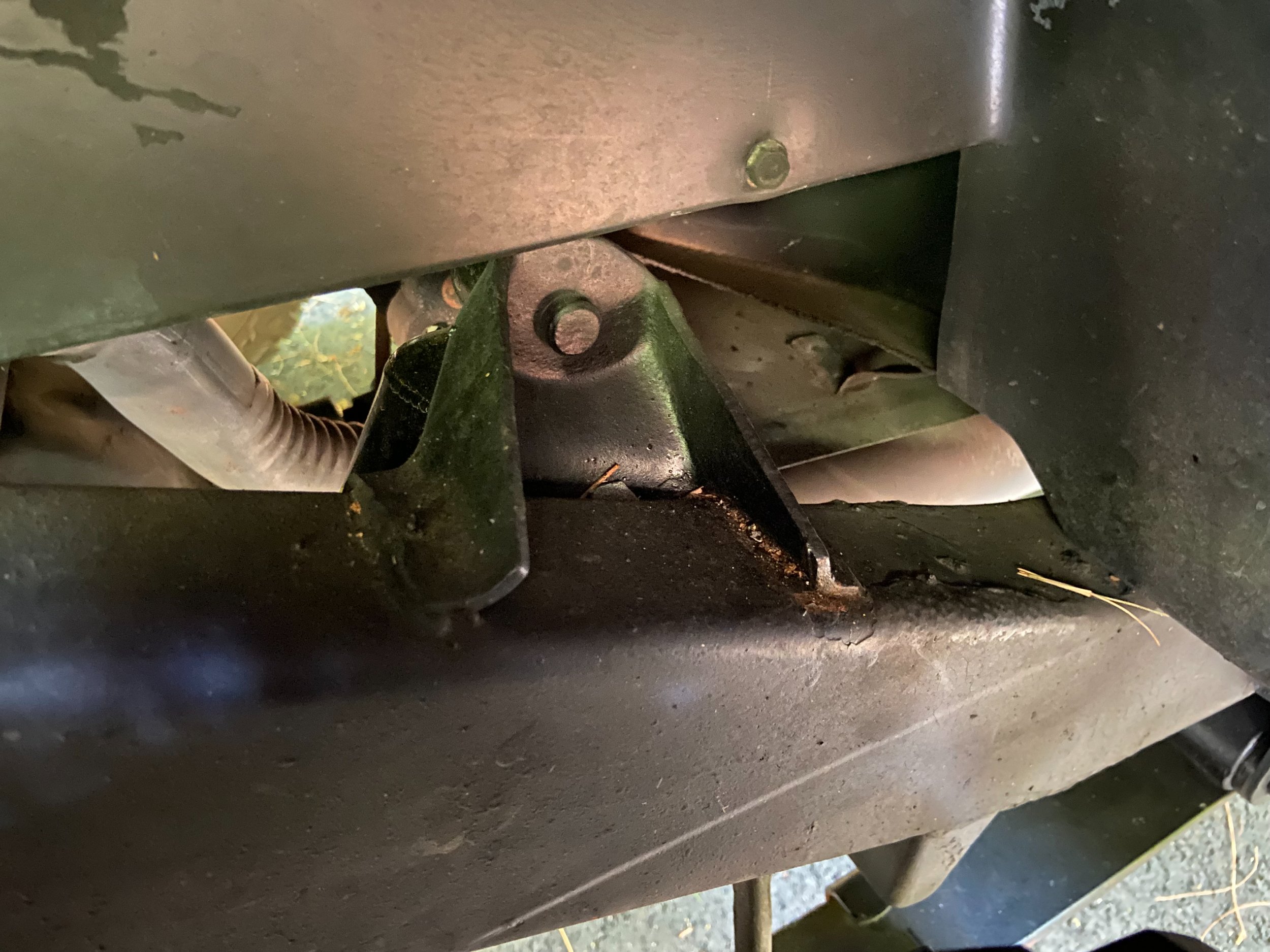

This is the rear shock upper mount. It's welded to the frame near the back wheels and forward of the axle. Water can pool up in the void and create rust.

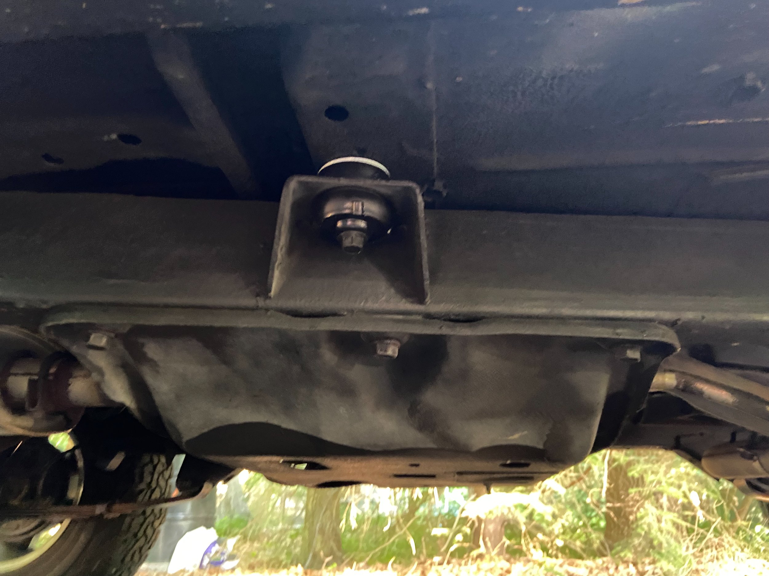

This is your transmission pan which is attached to the frame by 3 bolts on each side. It's easy to locate as it's installed to the frame below the floor pan just below the seats. The bolt areas are known to rust completely through. This not only serves as a skid plate but it also serves as the transmission mount. Use caution when removing these bolts for transmission maintenance (clutch change, etc). Note the body mount just above the pan.

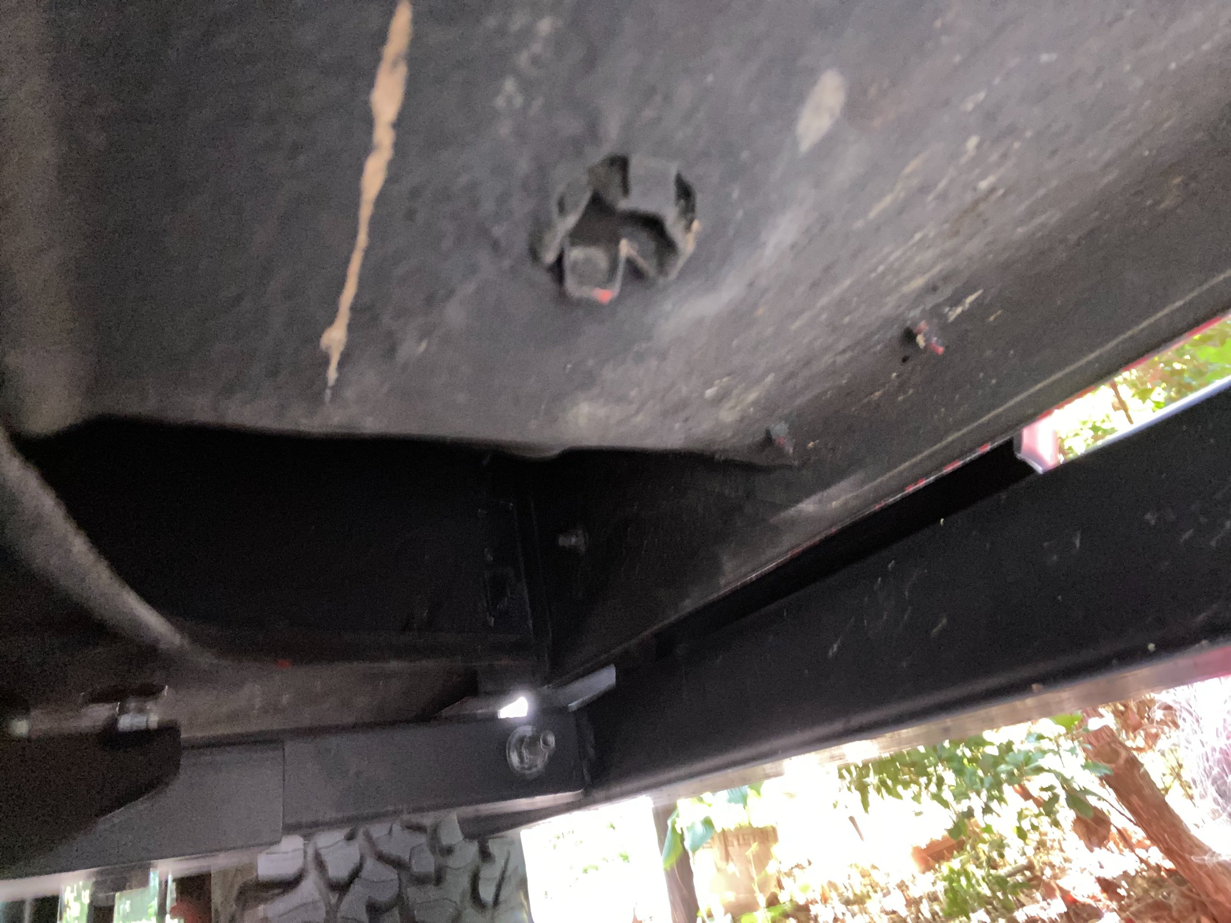

The next two photo show the area where the #1 body mount is located (looking forward). This area in just aft of the front wheels and is often over looked. There's somewhat of a shelf there and this is an area of the tub where corrosion can form.
