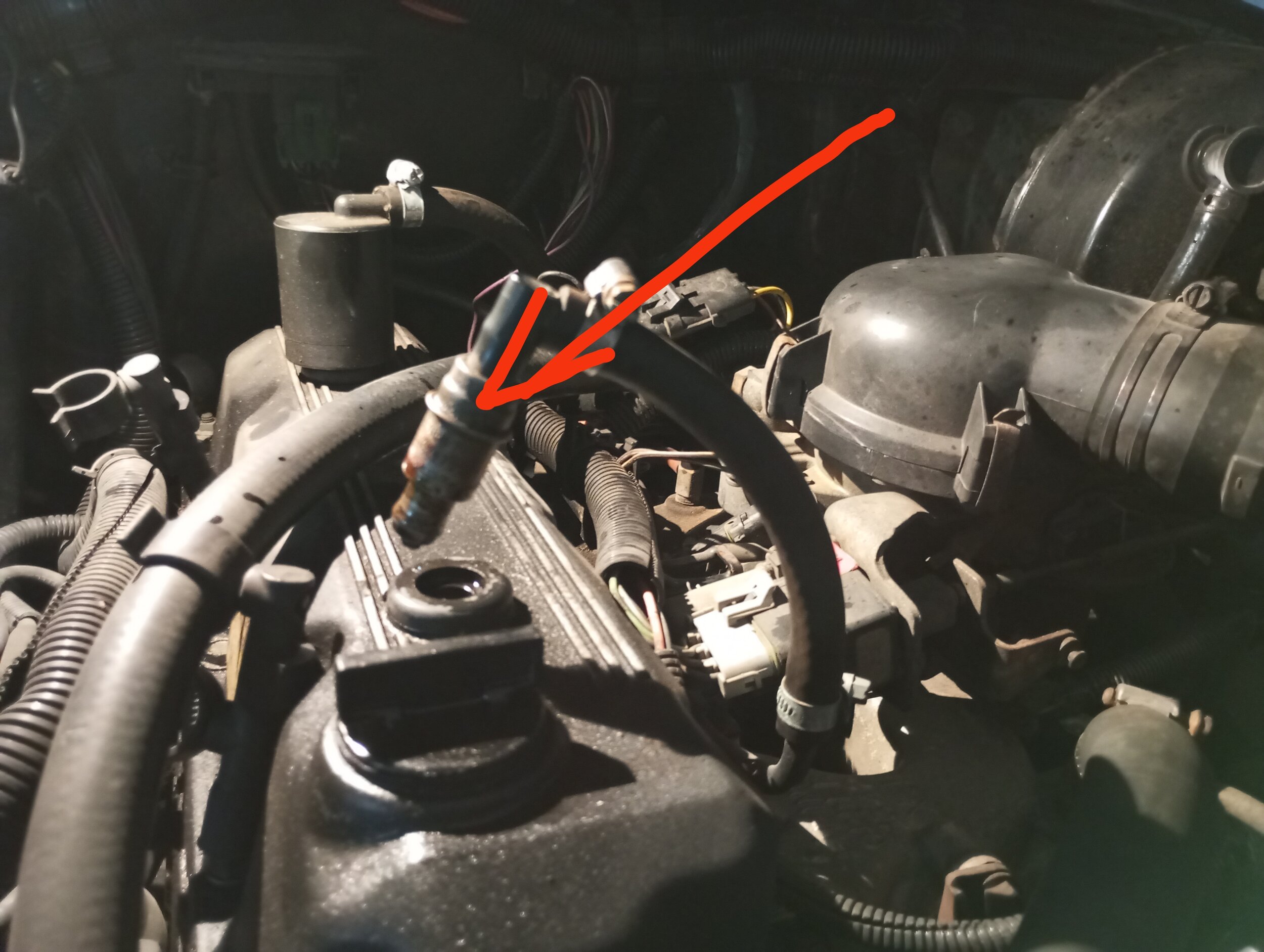

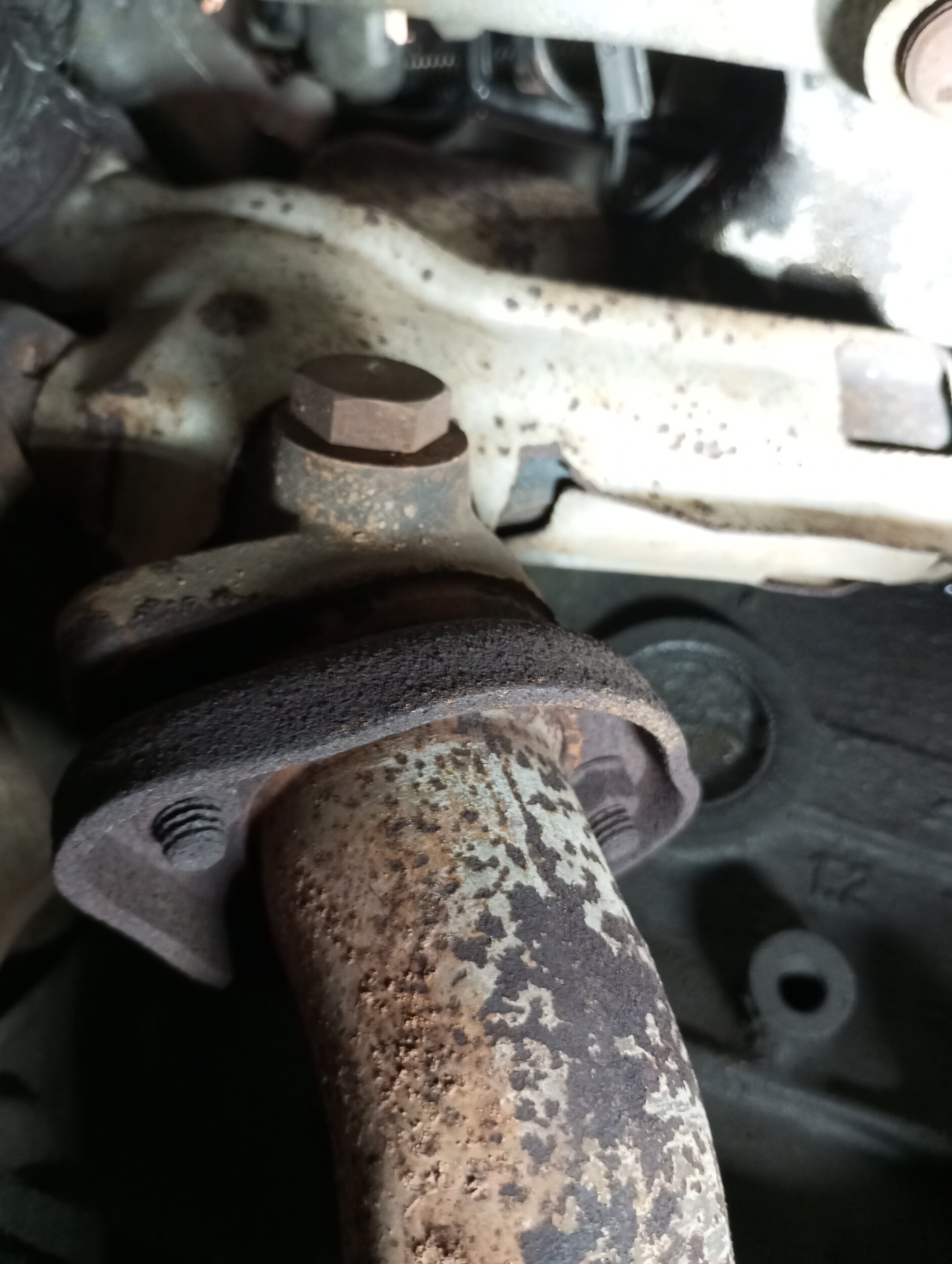

I recently failed the CO2 test, so I purchased a lambda sensor (O2 sensor) to replace the old one. I was surprised to find a nut where the original one should be. I've attached a photo.

I can't tell you much about an export YJ as far as emissions go. Either your YJ didn't come with an O2 sensor (which is possible since it's an export) or someone removed it at some point in which case you'll find a harness for it somewhere if you look around.
But a new sensor does no good if there's no place to connect the wires to. Do you see an unused plug hanging down on the left side?

Have to assume the car was imported without an oxygen sensor.

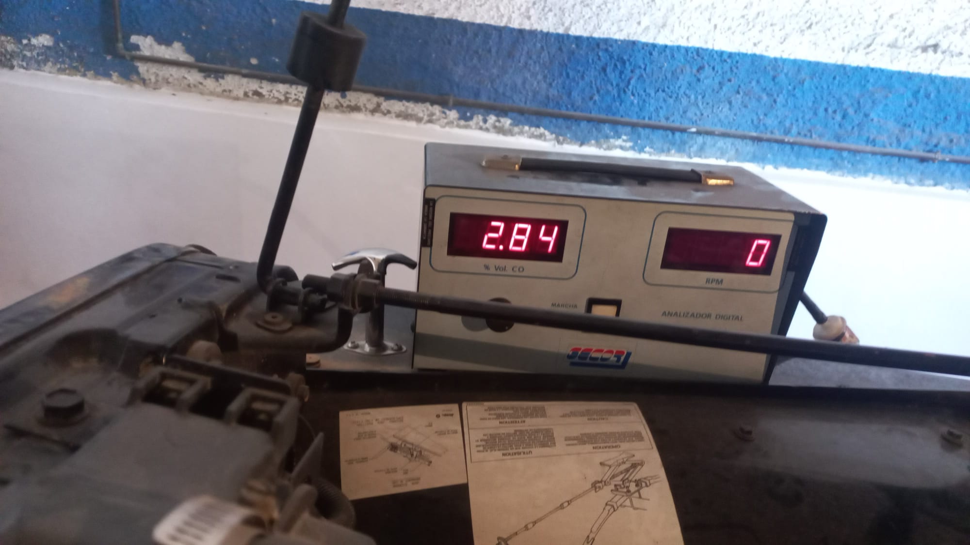

While testing with a gas meter, I realized that by releasing the vacuum line, I was able to significantly reduce the CO2.
