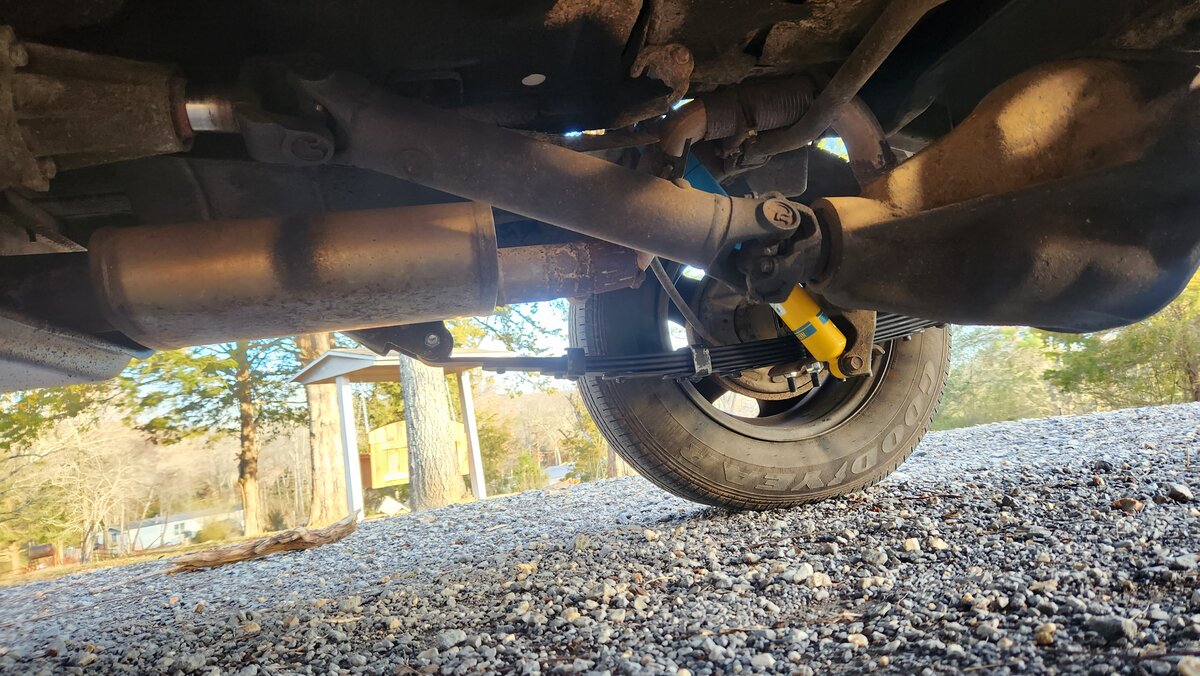

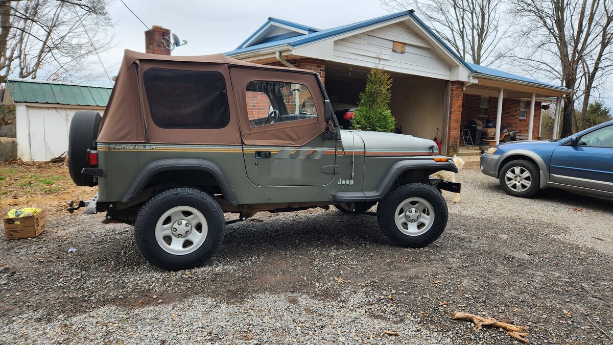

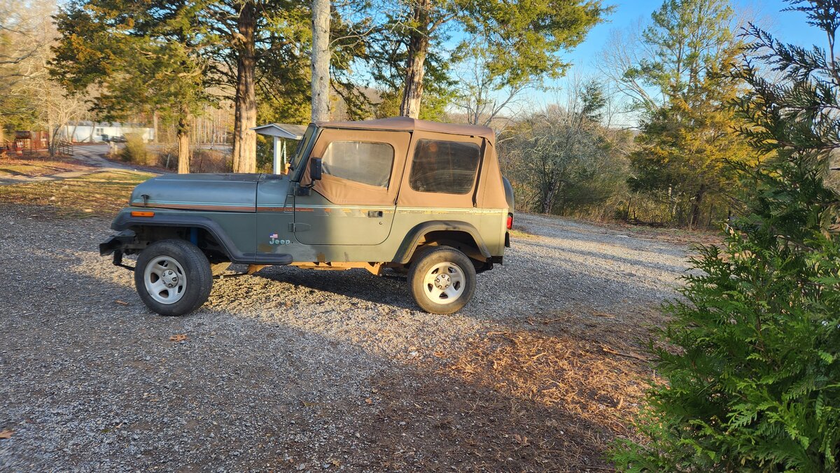

You were right about the springs it lifted the jeep a bit. Wish I had a before and after. Death wobble is completely gone though!!!!!! Jeep rides much better. However a new problem has arrived. I'm getting a lot of driveline vibration over 45mph. The new rear leafs have one extra leaf than stock... do you think I could remove it and maybe lower the jeep a bit? Or what would be your recommendation? Thank you so much
I actually just finished everything last night! Except ball joints haha.View attachment 120993 You were right about the springs it lifted the jeep a bit. Wish I had a before and after. Death wobble is completely gone though!!!!!! Jeep rides much better. However a new problem has arrived. I'm getting a lot of driveline vibration over 45mph. The new rear leafs have one extra leaf than stock... do you think I could remove it and maybe lower the jeep a bit? Or what would be your recommendation? Thank you so much View attachment 120992
Possibly, but if you don't do the same to the front you'll probably have some squat. Could try a transfer case drop and a small pinion shim on the leaf springs. I don't really like transfer case drops but that driveshaft angle is pretty steep.
You could try removing the lowest leaf on all 4 springs. I'm not sure that one is really providing a ton of lift though. Maybe, no way to know other than experimenting. I suppose it could make a bigger difference than it appears, as it overall stiffens up the pack which prevents the Jeep from settling as much. That alone may get you to drop down a tad (maybe half inch?).
Looks good otherwise.
Well after some research I guess I might do a slip yoke eliminator and a new driveshaft... I really dont want to do a t case drop. I also wonder if the slipe yoke eliminator will be a bad idea if the leafs loose tension over time and drop down to "stock height". Also I wonder if I will be able to use the slip yoke eliminator if that happens? Will I have to pull it off? Thanks!! Here she is with new tires. Went from 215 to 235. I believe it helps the jeep a lot. Once I figure everything out I'm going to post all the P/N and places I bought the parts from. Might help someone...
you’re sitting probably 1.75”-2” higher than stock. They aren’t going to drop down to stock height. Even if they did, you can make adjustments for that later. Your driveline is pretty steep, based on that the SYE will work well and it will need some pinion shims to work properly.
I am on 33" tires and a 4" lift and do not have SYE. Everything works and flexes as it should. I have a custom trans support, which helps the driveline angle some, but not much, less than an inch of change. I do not have extended motor mounts either. I wouldn't worry too much about a SYE. Soft top looks great by the way, I have the same one, mine is old and tired, but I only use It for storage so its okay.
