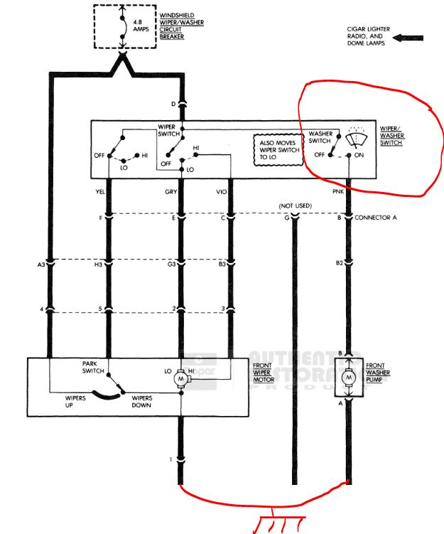

it all gets down TO how bad ,washers are wanted TO WORK. ( JUST 4 PATHS MAX TO CHECK)
THE FIRST SCHEMATIC IS JUST 2 PATHS TO FAIL. PINK WIRE. OR THE PUMP A GROUND NOT 0V WASHING.
THE TEST IS SUPER EASY,. WITH A METER, dMM SET TO VOLTS. EASY AS PIE. (WHILE WASHING )
well that is in the switch (stalk)_ BAD ,WIRES, AND GROUND, HERE.
diagnosis is easy only finding spare parts this old hard. endless now. (fiddly parts bad , custom to 1 year jeep)
the manual FSM is free, chapter 8k covers this cleaRly

if you just look you see only one possible failure and 8vdc out was bad so now you know why.
8v at pin b2? was it?
the intermittent is near the same. for washers
non: my post assumes actual wipers work ok..

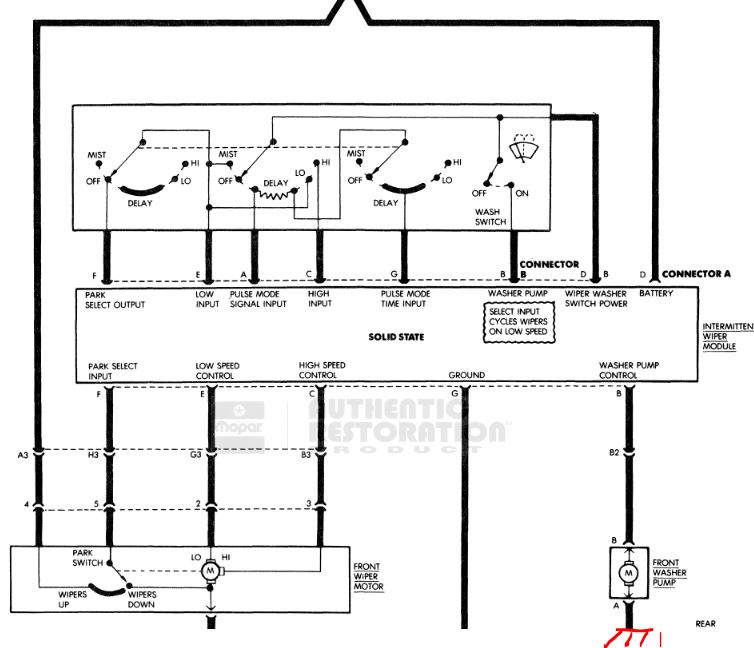

the delay words tell you it is the below option new. car.
as you can see the module can fail too below,

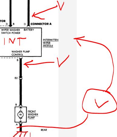

check waster volts first. at b2, 12vdc, washing , 14v running engine, if are.
G ground 0vdc.
so checking pin B (conn b or BB ) must be 12vdc in wash mode.to he pump motor and pump motor pin A IS 0V.
then all pins checked related, that means gounds are 0vdc, washing.
connector A is not labeled correctly below, but you will find it.
4 PATHS TO FAIL, WASHOUT bb
MODULE FAILURE
OUTPUT TO PUMP WASH DEAD. OR NOT 12VDC WASHING
OR PUMP GROUND NOT 0V;.
ONLY A CHEAP VOLTMETER FINDS THE CAUSE, VOLTAGE DROP OR DEAD, OR BAD GROUNDS, ANY CAN FAIL AND DO OFTEN, 30 YEAR OLD.

the hard fix above is that old and rare wiper module for intermittent option.

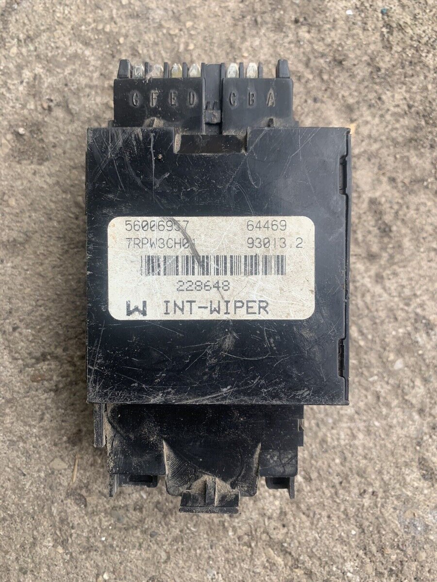

i'd never hot wire this model with DELAY feature, ever. it is solid state, and rare as hens teeth.new, used sure.
called int-wiper on the label it.

connector B measure
B and D. volts., yes jeeps drawing here is stinks, no colors and A /B connectors not clear.
i think CONN B is female and CONN A is male (at module)
both are 12vdc running pump washer
