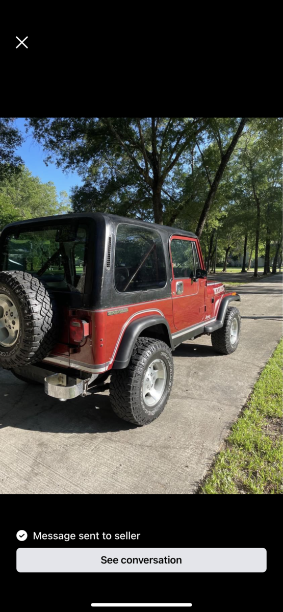

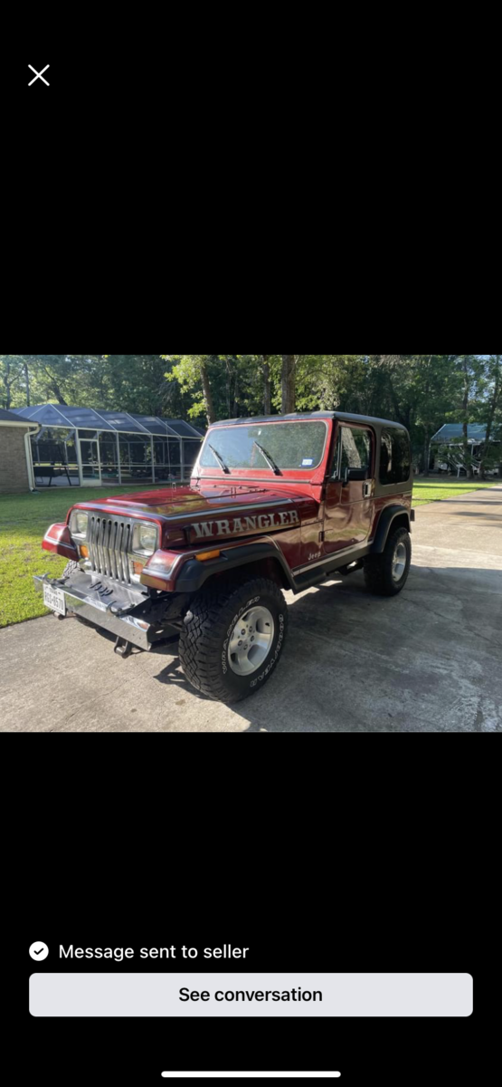

Hey guys. I picked up my 87 YJ recently and I was wondering if any of you have a regular preventative maintenance schedule you follow. The jeep has 174k miles and is in great shape. I’m hoping I can stay ahead of issues by proactively maintaining my jeep. Any help would be appreciated. I’ve included a few pics of the new ride because I’m proud! lol
