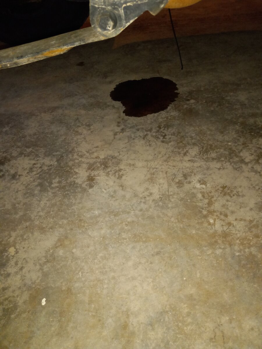

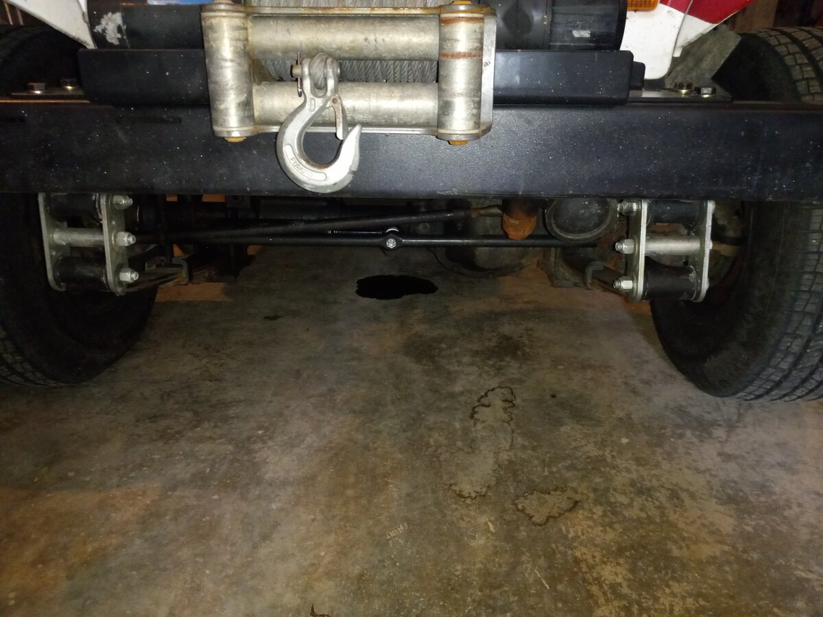

I moved my Jeep into the shed to get started on the RMS change. I haven't had a chance to drain the oil.
I haven't touched or moved my Jeep since Sunday. Here is my oil puddle for the past 6 days.
Is this enough to say this is the main spource causing me to refill about a half qrt to a full qrt of oil every two weeks?

So you went for a drive and parked it and that what you get? That significant amount and definately noto helping diagnose the loss. Do make sure its not a bad drain plug gasket,or bad V cover. be a heck of a lot easier then a RM job. Regarding the oil pressure. if its like my 91 Id pull the cluster and where that flat connector plug is clean the tabs like new. I also used a pair of needle nose pliers to flatten out the tabs as they had groves in them of sorts where the contact were made. My OP gauge 95% of the time said 60 all the time with the occasional needle flutter to 40. After the cleaning of the tabs,adding a additional ground wire it then said 40 at speed and almost 0 at idle after warmed up, it also corrected my volt gauge being in the red most of the time. I got tired of farting around with it and installed a mechanical gauge. So with the factory and aftermarket OP gauge I see 40 max at speed and 0 at idle and on the other its 55 psi at speed and 20 at idle.
Now the part you dont wanna hear. Id also ignor what I post because Im 99.9% sure its not your issue. I have a 89 Bronco with a 302. Drive/cruise unloaded at 55 and the O/P was low at 35 (engine was tired)hit the gas and it would shoot up about 10 psi. Let off the gas as It basically coasted down a couple mile long grade while commuting to work and the O/P would go up to 60 or so. I tested it with a manual gauge as well with the same results. The only logical conclusion we came to was the either the cam was walking forward or backward due to a worn thrust bearing or bottom end bearings were so loose the same was happening somehow causing the issue. The only thing we could figure out.

I haven't driven it since last Sunday Oct. 24th. It sat in the shed for 6 days, so I really got to see how much it drips on it own. The drips are coming from between the trans and motor. I was prepping to do the RMS and oil pan, but we had a family emergency and didn't get to it. All is good with the emergency.
I have already changed the Valve cover gasket, because it appeared it was leaking from the backside. My oil pan is dented and it looks like it could use a gasket change. While I had that off I was going to go ahead and change the RMS along with adding a girdle.

I don't know if I would say it's "a lot" but it's certainly worth fixing. It's only going to be worse when it's on the road and the engine is sloshing oil all over the place inside the pan and under the crank.
I expect you will see a pretty dirty engine backside when you do your trans swap. Good thing is that will give you plenty of room to observe and clean up back there.
