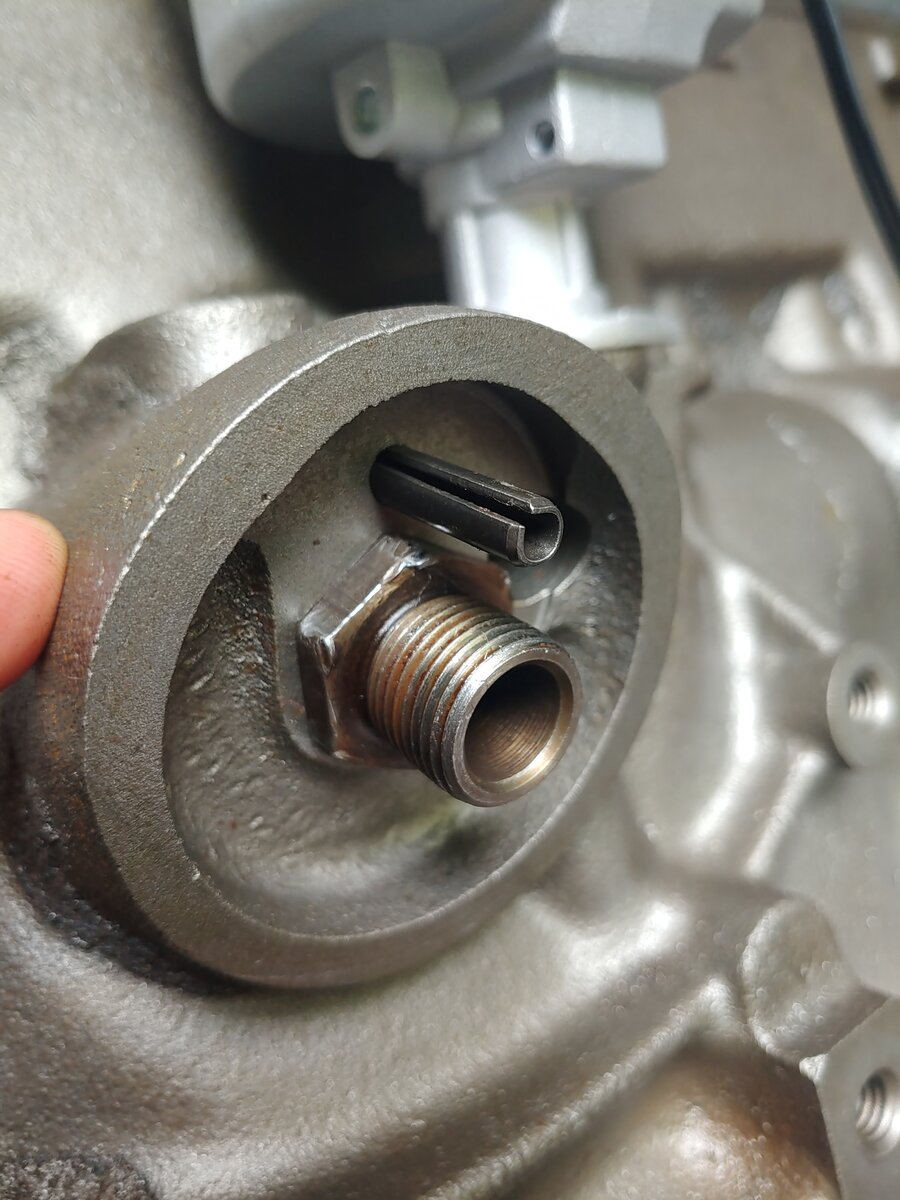

Gate New Member Joined Jun 11, 2020 Messages 4 Location Fort Riley, KS Jun 29, 2020 #1 Got my new block back and this little shit is in the oil filter housing. Any ideas to get it out?
Flyer58 YJ Enthusiast Joined Apr 12, 2020 Messages 922 Location Magnolia, Texas Jun 29, 2020 #2 Just grab it with pliers and pull. . I don't recall ever seeing one. I see other photos have it so it must be needed

Flyer58 YJ Enthusiast Joined Apr 12, 2020 Messages 922 Location Magnolia, Texas Jun 29, 2020 #4 Gate said: Thank ya Click to expand... Well I just found out it's an oil filter adapter guide pin to keep the adapter straight if you want a vertical filter. I have a screw on filter so it's not needed. Reactions: Chris

Chris Administrator Staff Member Joined Sep 28, 2015 Messages 29,889 Location Florence, AZ Jun 29, 2020 #5 Flyer58 said: Just grab it with pliers and pull. . I don't recall ever seeing one. I see other photos have it so it must be needed Click to expand... Yep, X2 to this.
