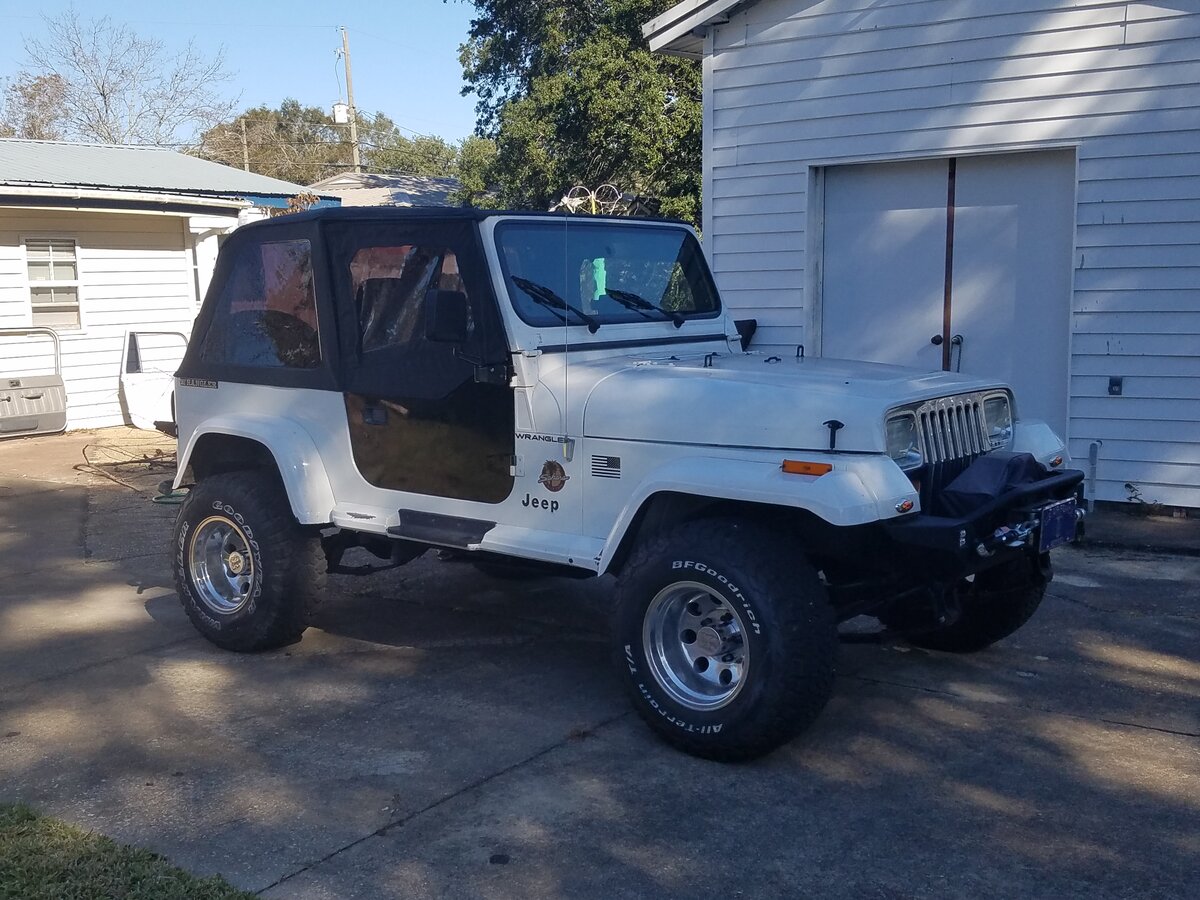

Hello,
I'm new here. I bought a 89 YJ 4.2l a few years ago. The body and chassis are in great shape (California jeep). the engine on the other hand needed work. I was able to get it running and driving good, until about a year ago. It has progressively gotten worse since then, on to the issue.
When it started happening it took a lot longer before it was a problem, now 10 to 20 miles is all it takes sometimes less. It starts and runs fine for the first 10 to 20 miles, then it hesitates, sputters, and will stall at idle. I can restart it and it will sit and idle fine, give it gas and it sputters or stalls. if I push it to far, I have to let it cool for 30 minutes to an hour before it will start again. it acts like something is getting hot and causing a problem.
