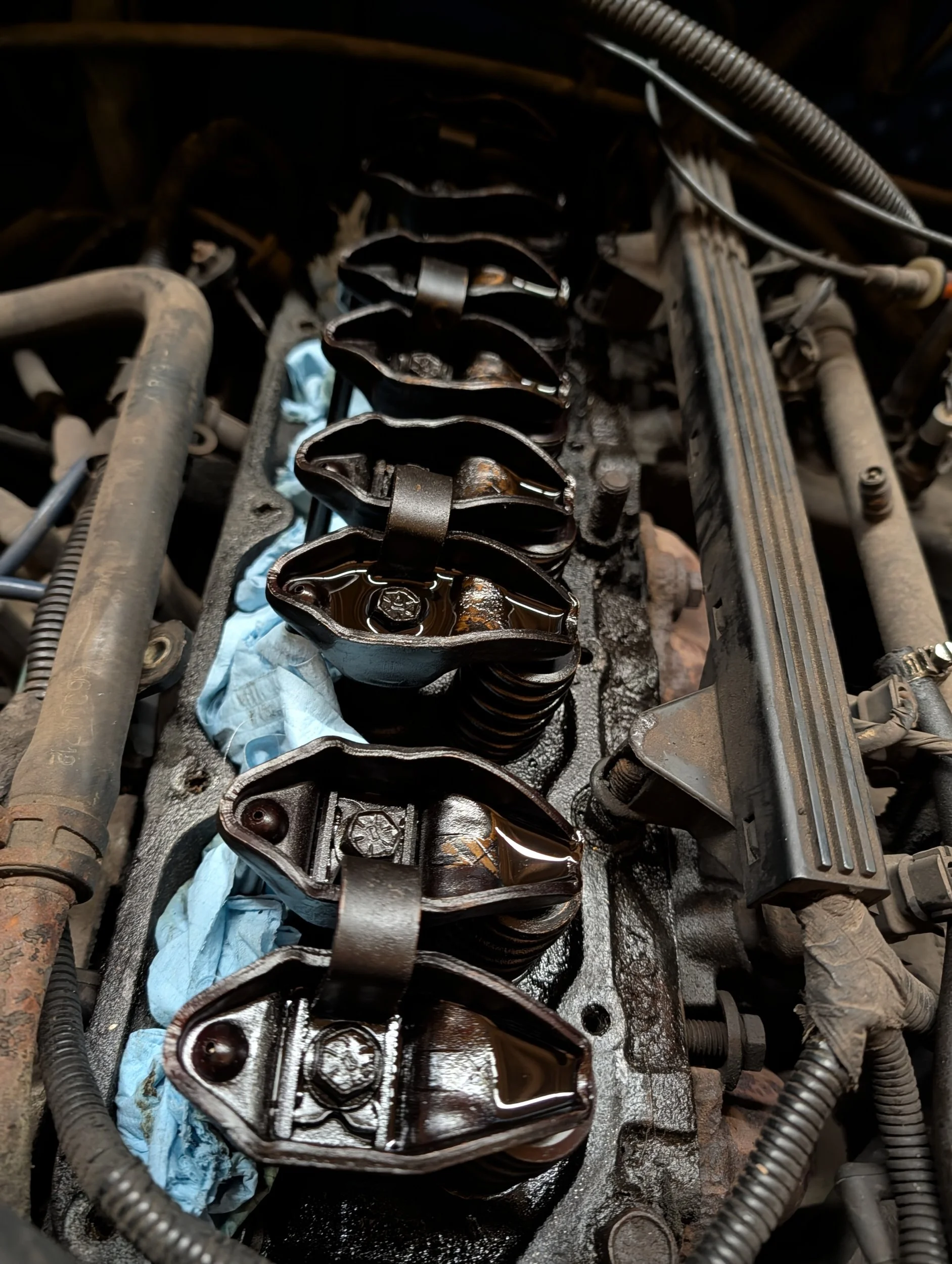

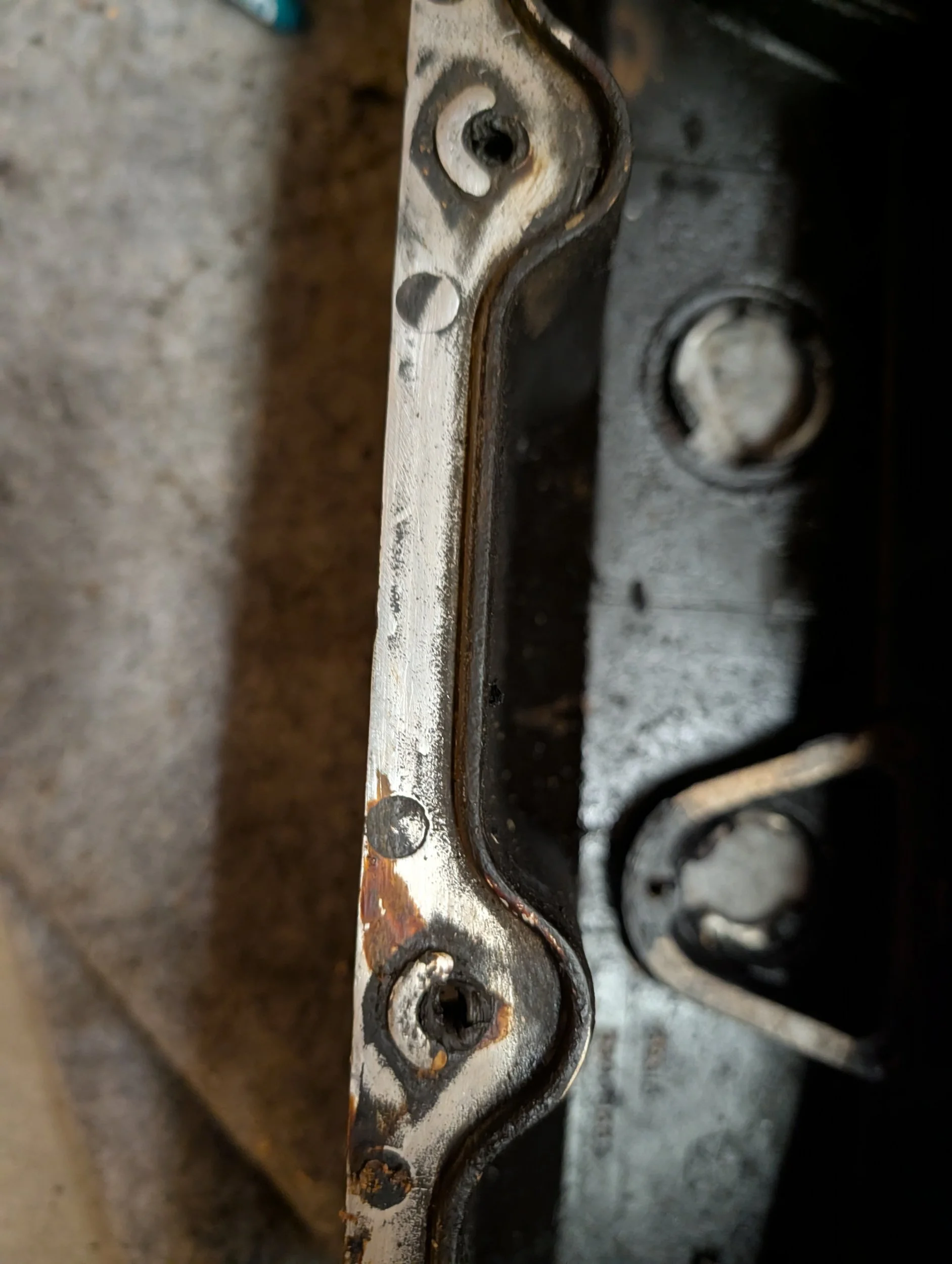

Hi everyone,
So I have a 1993 Jeep Wrangler with the 2.5. I have been replacing the valve cover gasket, and the mating surface on the head is black, and I have used a razor blade, steel wool, a brush, brake cleaner, and rags to try to get it clean, but it is still black. The valve cover itself is a lot cleaner, but there are spots that I cannot get shiny. What should I do? Should I just install my new cork vc gasket with RTV and throw it on as-is?
Thanks
As long as its clean thats OK. I will add I see many gob RTV on a gasket like a VC, and then slap in on and tighten the poo outta the bolts. Surely you notice how slippery RTV is and when the above is done it ends with the gasket sliding out of place. What I do is a thin coat of RTV, lay the gasket on the cover, use bolts, pins or?? to align it and keep it in place with the VC holes and let it dry overnight. Then install it on the head with a thin bit of RTV is you want or with no sealant.
I personally have had good luck using small wire wheels made for use on drills or 1/4 inch impacts. Have also used these for cleaning up head gasket mating surfaces. Was suggested this by a machinist, you absolutely do NOT want to use a 4 inch high speed grinder with a wire wheel. I know that from personal experience.
Reactions: blackdh319
Try 80 grit sandpaper backed with a small block of wood. Gaskets are made to seal with out using Sealer. Use a Stright Edge on the Valae Cover to check for a smooth flat surface. Tighten Valve Cover Bolts to Specs , usually 100 INCH Pounds or just tighten by feel. start with the center bolts and work to the out side, tighting each bolt a little at a time. Don't over tighten the bolts or you'll warp the thin cover and cause leaks . Use Rtv Sealant as a last resort. Hope this Helps" Merry Christmas Everyone".
