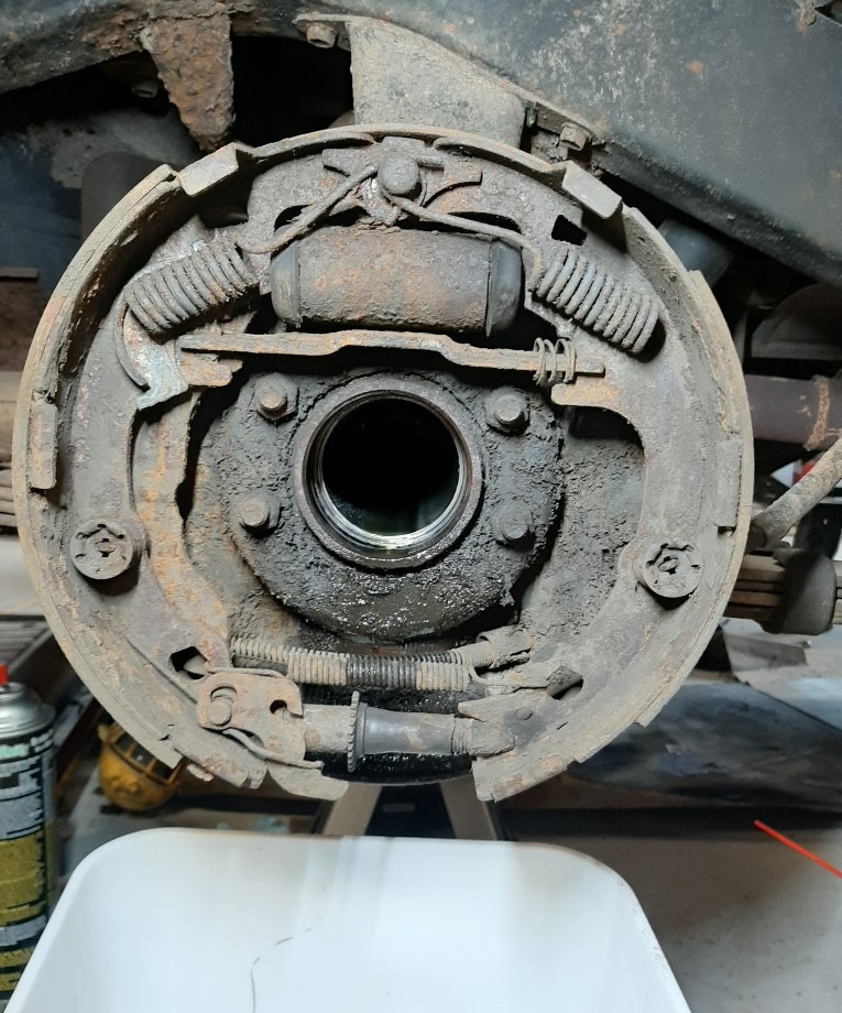

Here's the mess I was faced with, others will probably see worse. Pull it all out and clean up the backing plate.

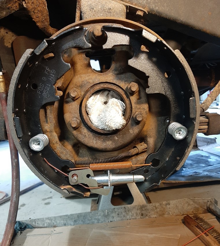

I installed the brake adjusting lever and it's retaining spring before installing the shoe but this step could be done later. No difference.

At this point it's much easier to install the brake shoes onto the backing plate with the two retaining springs than trying to hold everything in place with your hands and feet. Next add the adjusting mechanism and lower spring. Be sure the lower spring is stretched between the LARGE holes, not the closer small holes.

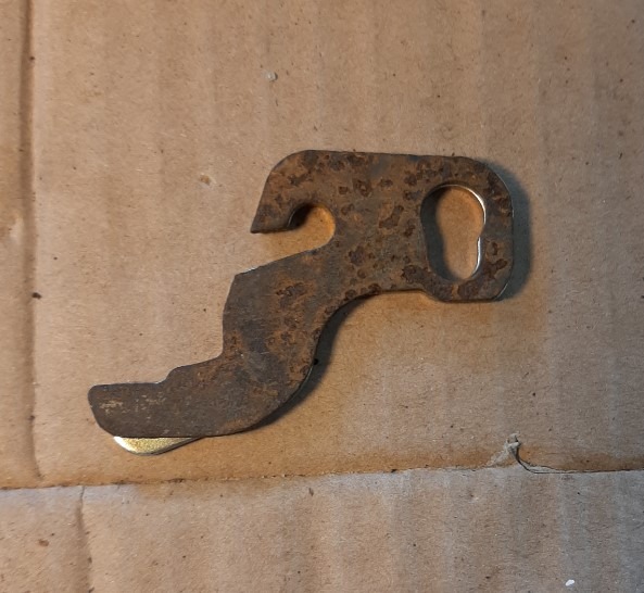

Reading through dozens of reviews about the new brake hardware kits you'll see quite a few that say the new adjusting lever is too big and scrapes a groove in the drum. Well, yes it does have a slightly different shape but not enough to hit the drum or even come close (Drumroll) when installed correctly.
You can see in this pic I overlapped the levers and there is a slight difference along the bottom edge, but again that's ok.

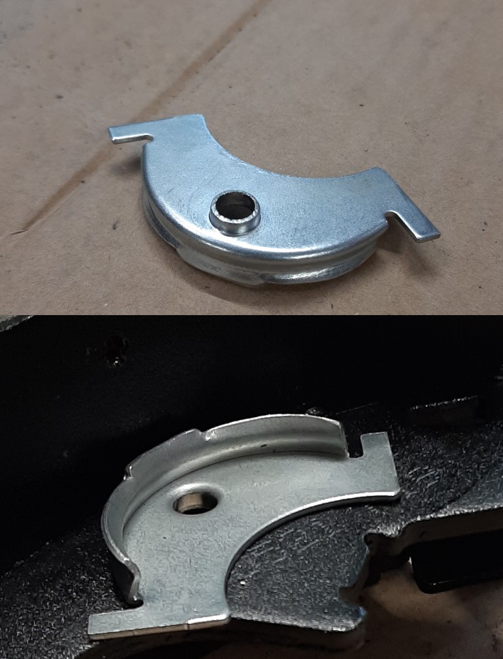

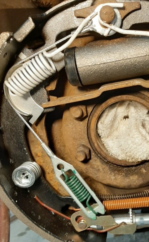

Make very certain the emergency brake lever behind the rear shoe is fully hooked in place at the top of the shoe. If it's not hooked the lever and shoe will not be flat against each other and the upper cross bar and little spring will not fit.
This next part is about the curved adjusting wire guide and this is what's so critical at getting it right.

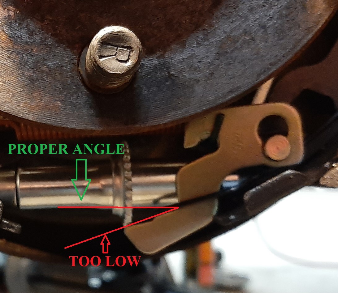

The curved guide had a round portion on the back side that sticks out and fits into the hole on the brake shoe. When installed correctly the curved guide will lay flat on the brake shoe and is hooked in place by the spring.
What happened to me several times and most likely everyone else who had a problem is the curved guide becomes unseated out of the hole when attaching the spring onto the top post. When this happens the adjuster cable will have too much slack and not pull the adjuster lever up into position. In most cases the lever won't even touch the adjuster tooth wheel and never work properly along with scraping a groove in your drum.
When installed correctly the cable should be taught and in the groove around the curved cable guide, not pinched under the guide. When attaching the spring end of the adjuster cable to the lever simply push the lever up with one finger and hook the cable spring into it's slot on the lever. Much easier than trying to stretch the spring onto the lever. The adjusting lever should sit level and engauge witht the adjusting tooth wheel.

I am trying to re-install the original Dana 35 in a 95 YJ that I bought. It has been swapped with a for 8.8 that is in very bad shape (grinding). The replacement axle that I sourced is in great shape but it does not have the original brake hardware. I have been able to find all of the parts except for the parking brake lever that sits behind the rear shoe? Does anyone know where I can get one?
