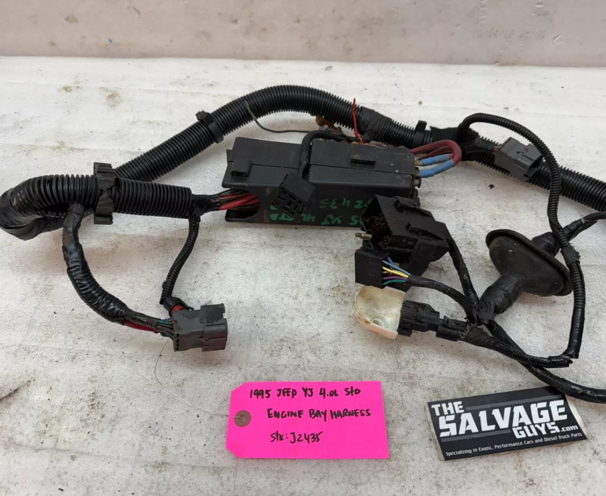

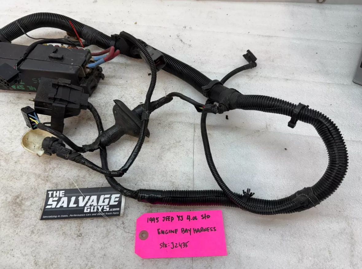

Here is a picture of the harness I purchased. Does it have what I need?
