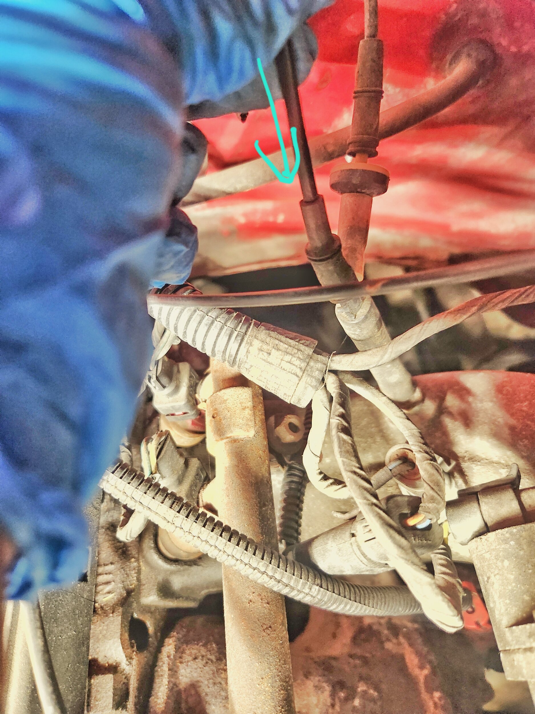

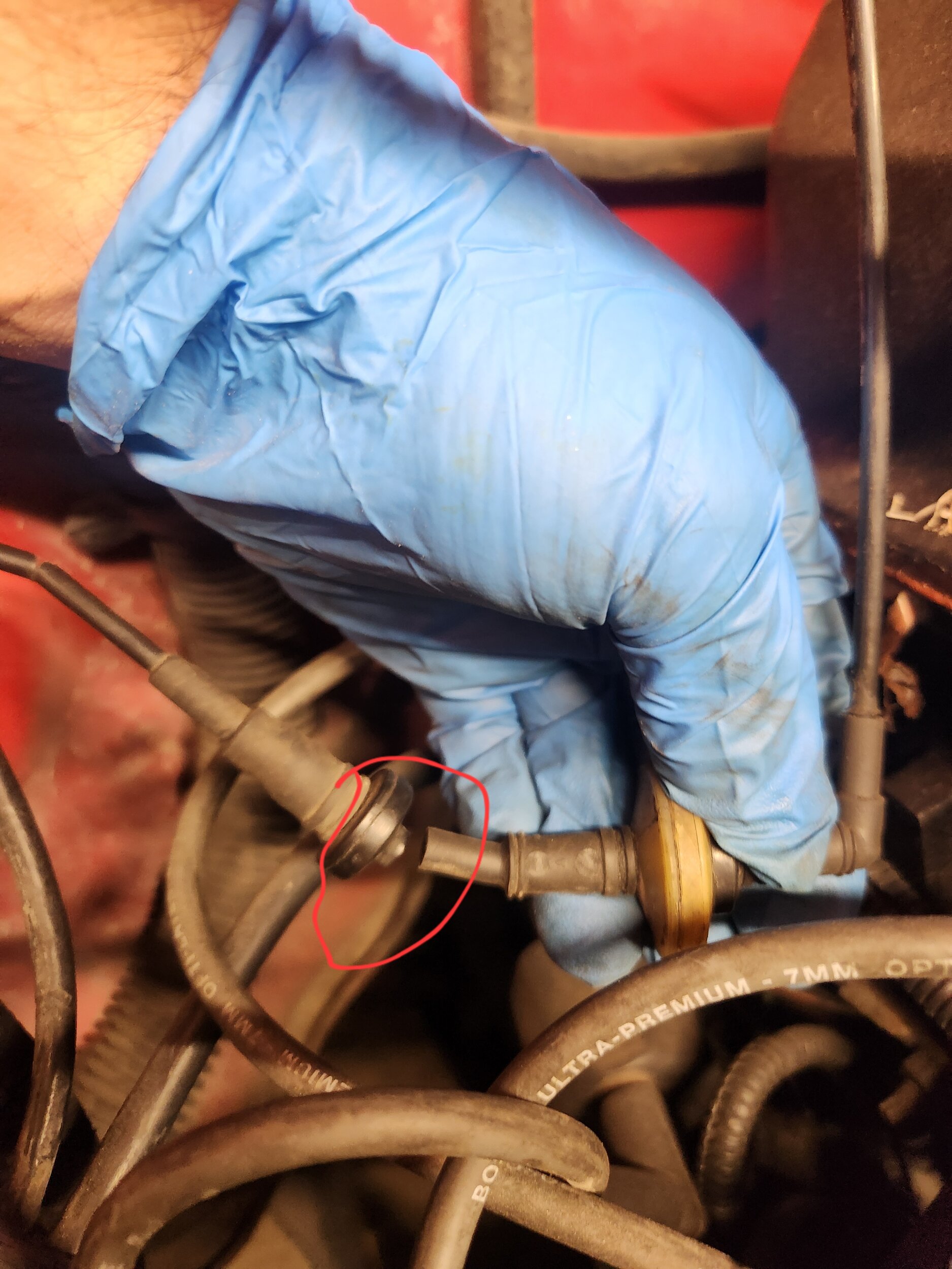

Hey all, first time poster here. Got a new to me 95 YJ Rio Grand, great shape overall. Can someone help me identify a vacuum leak? Picture attached shows vacuum tube that broke, and where it leads to on driver side of engine.

Its a check valve basically. Ive nabbed a few off other vehicles over the years at junk yards. Finding t hat particular one for a YJ may be a bit of a bear. IIRC its either for the 4x4 or the heater controls. Have a look at Dorman 47170.
