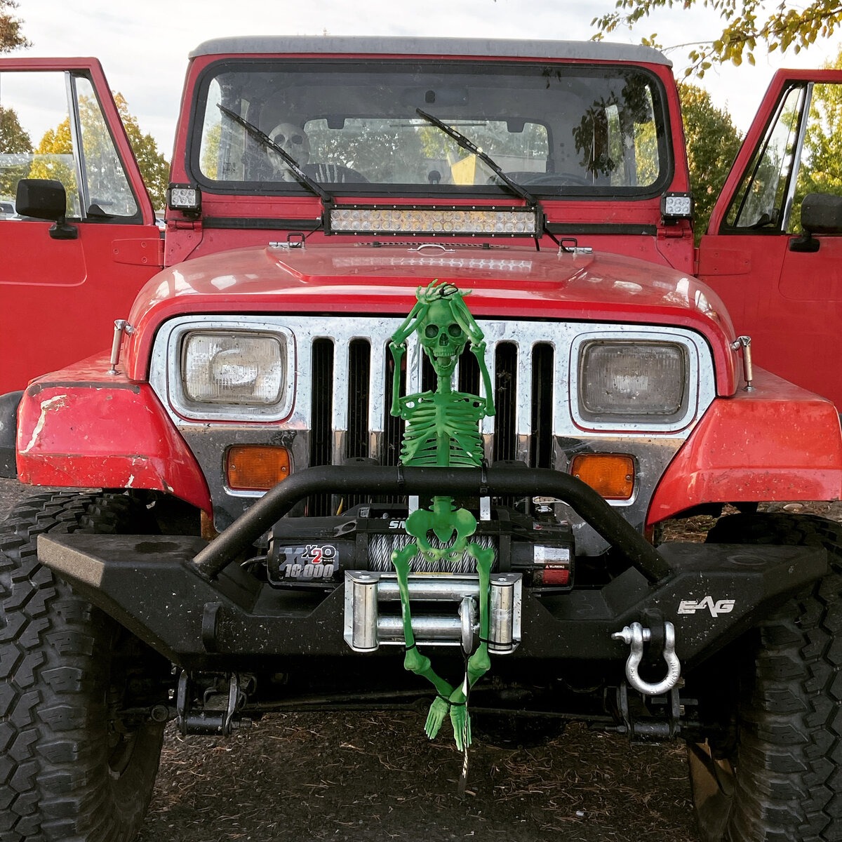

If your looking for something simple and away from the stock look and keep it cheap I have on mine a eab bumper that I will say is super easy to install and has the mounts ready. Takes me about 10 minutes to put it on and go.
