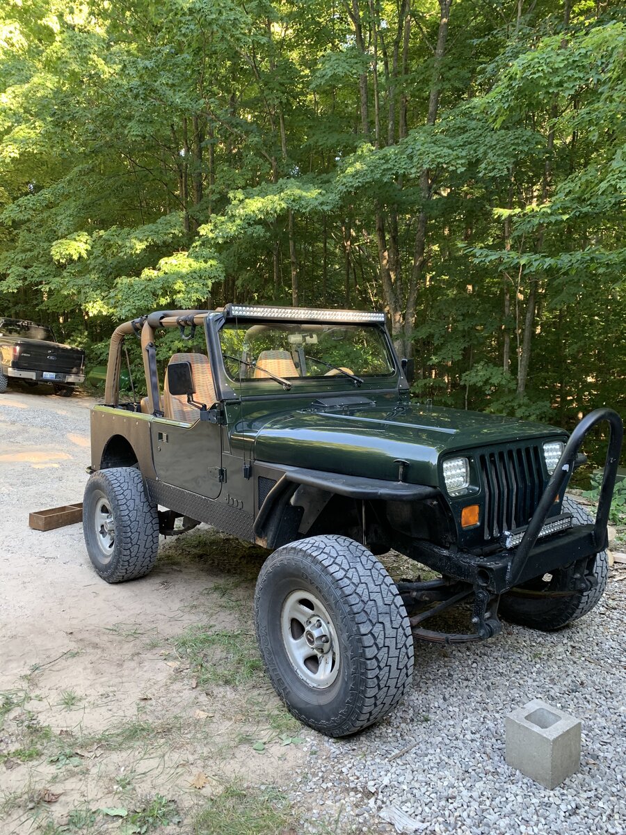

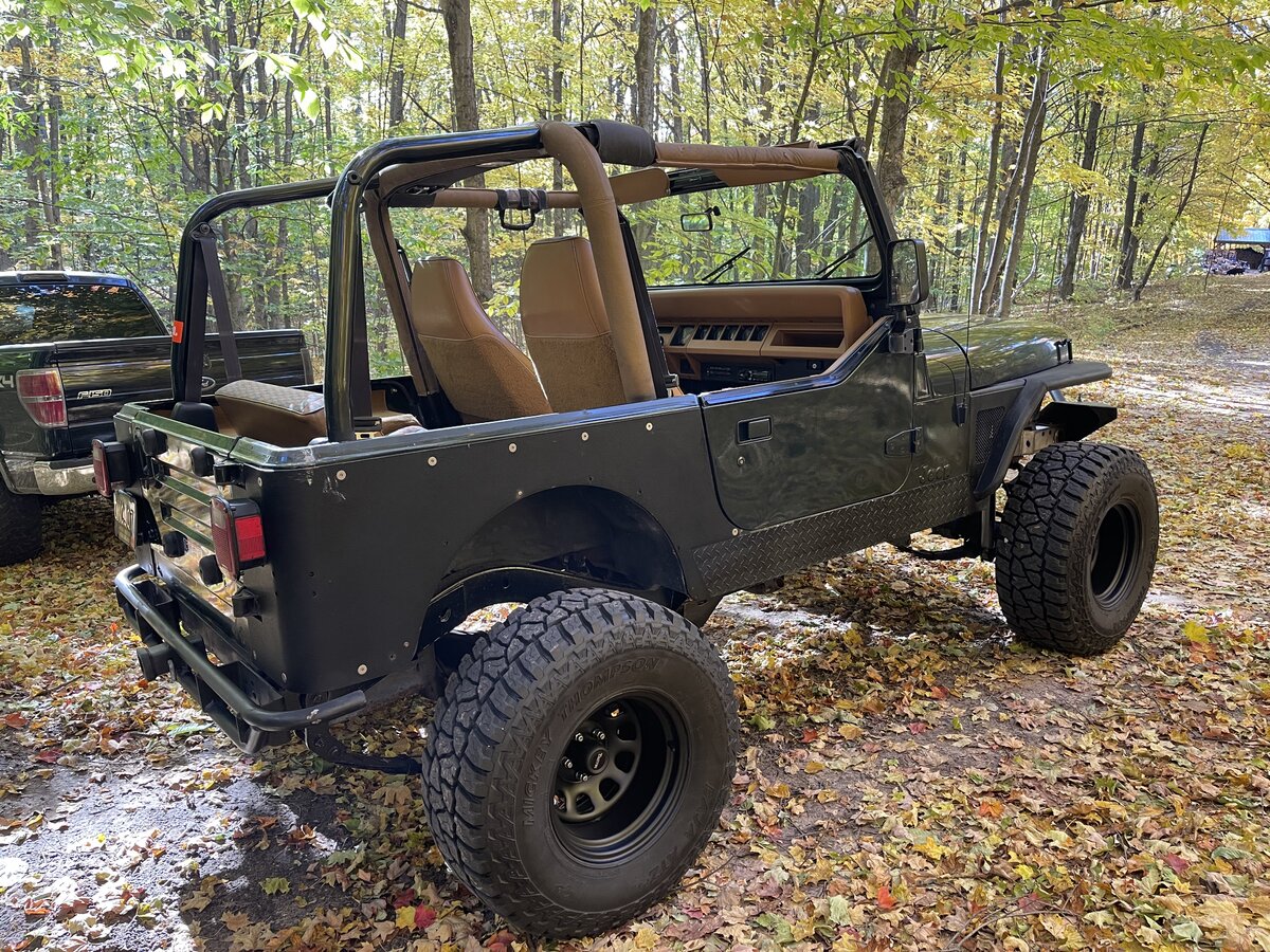

New to the Forum. I have a 95 YJ with a 2.5 and the 5 speed AX5. It is lifted 4" with a rough country kit. I'm on 33x12.5/15's on a 15x10 Tactik wheel. Mickey Thompson ATZ P3 tires. It was was originally Hunter Green? I think that's the name. It's the newer green now, from the TJ era, and painted pretty poorly. I have the tan interior which is in very good shape. The frame of the Jeep was awful when I bought it. Poorly patched. Just awful. That is almost all reconciled now. One more chunk to do and it will be more replacement sections than original frame. Has a soundbar and JBL sound, and a Kenwood head unit. Thats about it. Ive changed a lot since I bought it, i'll add a picture from when I bought it to now, black wheels are the newer photos. I have a hardtop and a tan soft top as well.

Nice Jeep! Well done. I am new to the Jeep world and also just joined the forum. I have a 95 emerald green that is completely stock, and I am looking for some inspiration. For one, your seats are super rad, where did you get those?
Thinking about a 33" tire on a 3-3.5 lift from BDS, and also have the 2.5 w/ AX5. Does it drive alright? I have read some stuff about being under powered.
Then one last question; from what I think I have learned, boomerang shackles are super rad. But I see you have two different orientations pictured? From what I read the last picture looks correct, but I really don't know. Is that a part of the rough country kit? And are you happy with the rough country lift?

Thank you for your kind words. This Jeep has been a project. I come from XJ's and TJ's, so this is new territory for me too. The interior is a stock interior, that somehow survived the pervious owner. Not the most sought after seats, those would be the green Saharas. But they do look good. There's a VIN code for this interior, I'll take a look tomorrow and see what it is. I'm sure someone on here knows it off the top of their head.
You shouldn't have problems with cruising and light off-roading with 33" tires, the Dana 30 in the front will be your weak spot. There are a million solutions for that. Different axles, axle shafts, gearing, and so on. But for most uses, 33's are just fine, but don't expect the world out of the Dana 30. A 3-3.5 lift will fit those fine, and BDS is a great quality company. You don't have to go that high-end, even. Something lesser will do the same job. Hence why I have a RC on this Jeep.
Drivability, yes, it's underpowered. I can cruise 55 in 4th gear on flat ground. I don't use 5th gear unless I somehow I get it to 70, which is rare, and I have 4:11 gearing. Just fine for a cruiser, but not a commuter. But my engine is tired, 215k.
As for the shackles, the first picture is "correct" the older picture with the huge stinger on the bumper, would be flipped/boomerang shackles.

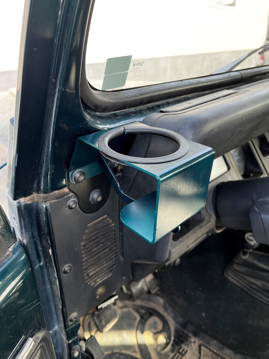

Good to know! I set a couple of saved searches. I also found some on ebay but they were pretty worn, I am going to try and hold out for a nicer set. I am still piling money but I did my first "mod"
Rattle canned it the body color and got a little rubber do-hicky so my tumblr doesn't rattle in the hole.... Next is the lift lol

Gotta start somewhere!
