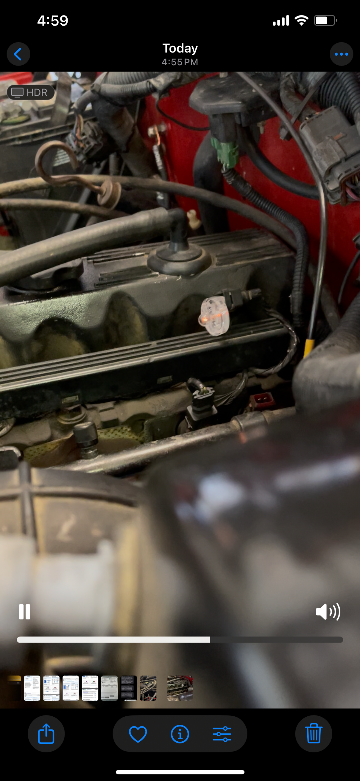

Thanks for the info. I’m about to use a NOID light to check for signal coming to the fuel injectors and I also changed the fuel filter this morning. Almost time to drop the tank and have a look at what’s going on in there. I’ll keep an eye out for the issue you mentioned. Thanks
So far I changed the fuel filter, which was overdue and swapped in a known good cps. Next up I will test that the signal is getting to the injectors…I like the idea of pouring fuel in the TB, but I am a bit worried about fire as the Jeep is in my garage.
Well, it looks like the fuel injectors are getting a pulse from the computer. Now I will see about dropping the fuel tank. Good thing I just fueled up. 😜

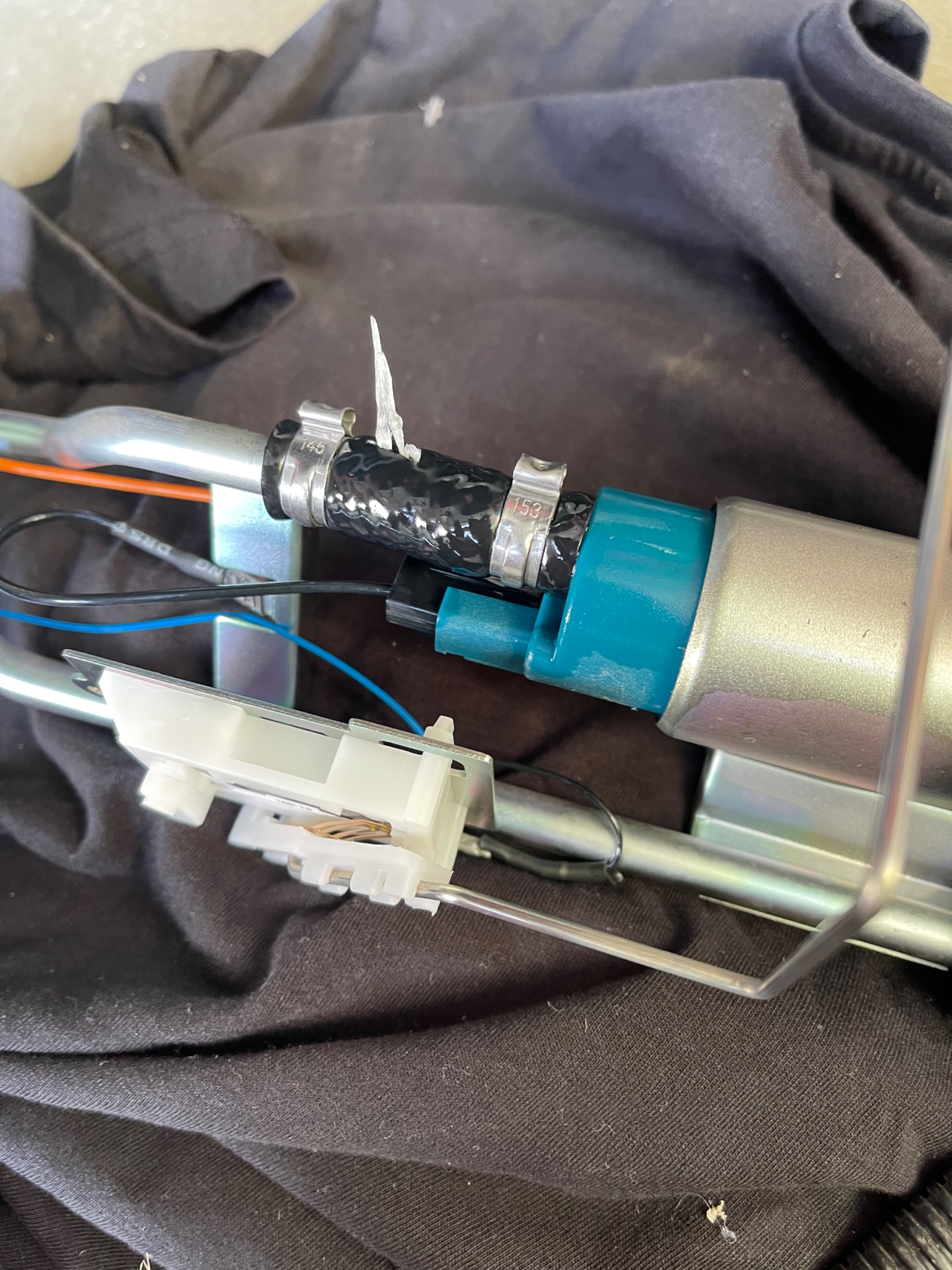

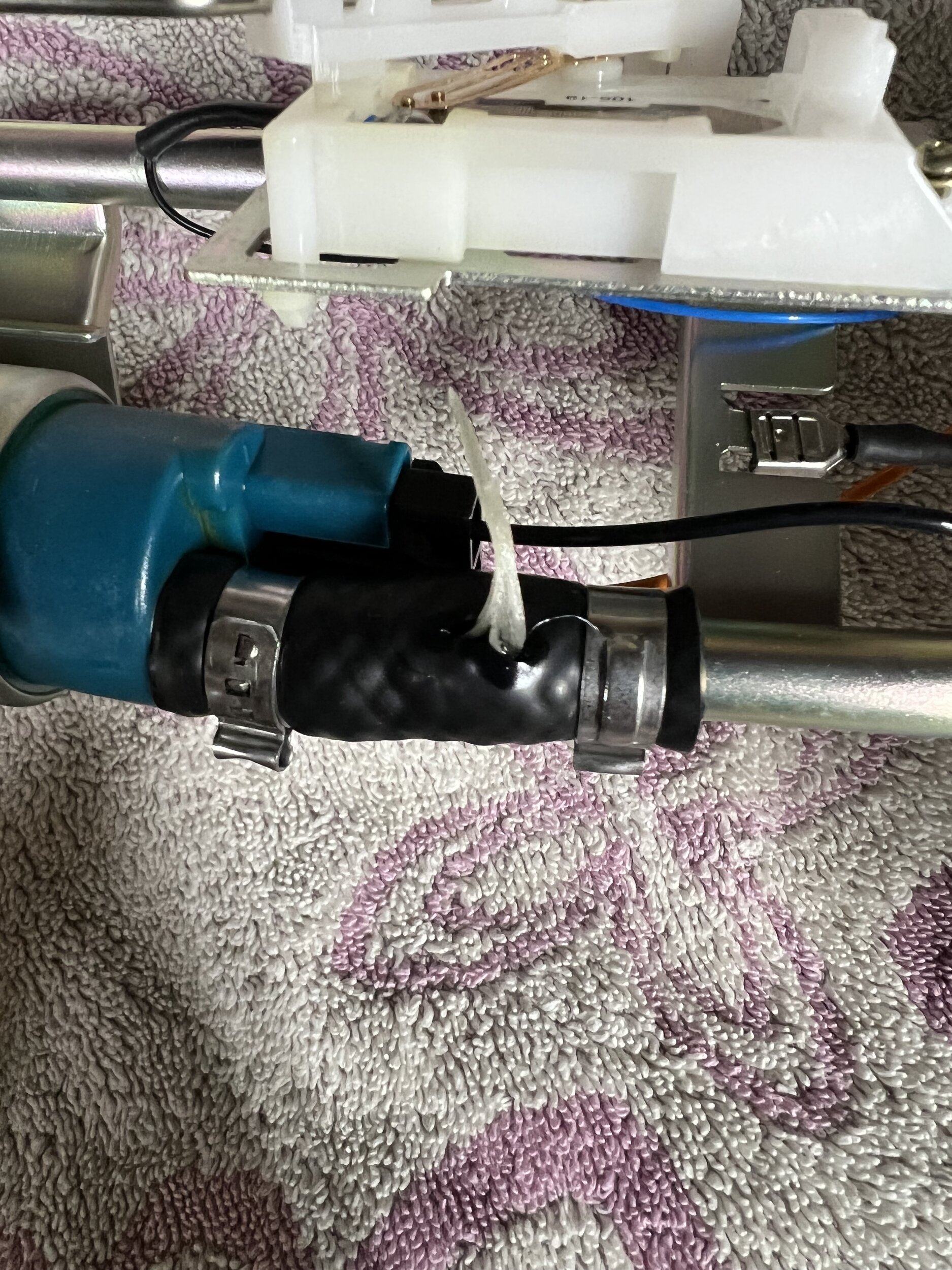

I dropped the tank and sure enough the hose from the sending unit had a split in it. Thanks everybody for the help. I’ll be back in business soon. I’m going with a Delphi from Napa this time around which comes with a decent warranty. Hopefully it lasts that long. my last one, which was from autozone and lasted 3.5 years.
