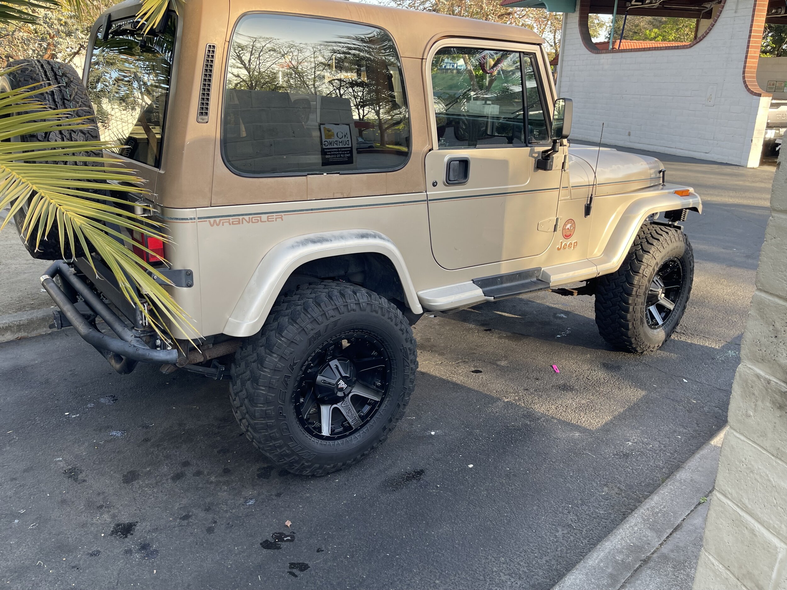

Hi everyone,
I’m new here, but not new to jeeps(this is my fourth one over the years). Anyway, I just bought a 94 Sahara, which came with 185/70R17’s(approx 32.8”) tires. I’m trying to determine if it has any sort of lift, as the jeep definitely sits higher than my previous YJ, which was on 30’s, with a 2.5” body lift. Can anyone tell by the way it looks?
I’m not too convinced with the current wheels and tire combo, and plan on possibly going with stock “Jurassic park” alloys with 30-31” tires, but don’t want to have the jeep looking funny(if it does have a lift), with too large of a gap between the fender and tire, when I make the switch to the 30-31’s.

Looks like maybe a 4-5" lift to me, especially with those tires.

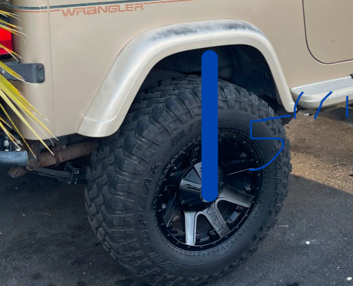

Thanks, Chris. Are you sure that you meant to say 5”?
5” doesn’t seem to be like much. Is this what you’re suggesting I measure?

Hard to say but that looks to be around a 4" lift. An easy way to tell if it's lifted or not is to look at the shackles and the leaf springs. You have stock shackles, so nothing to write about there, but your springs are arched significantly. Stock springs are almost flat. As such, you can pretty much always tell when it's stock vs not.

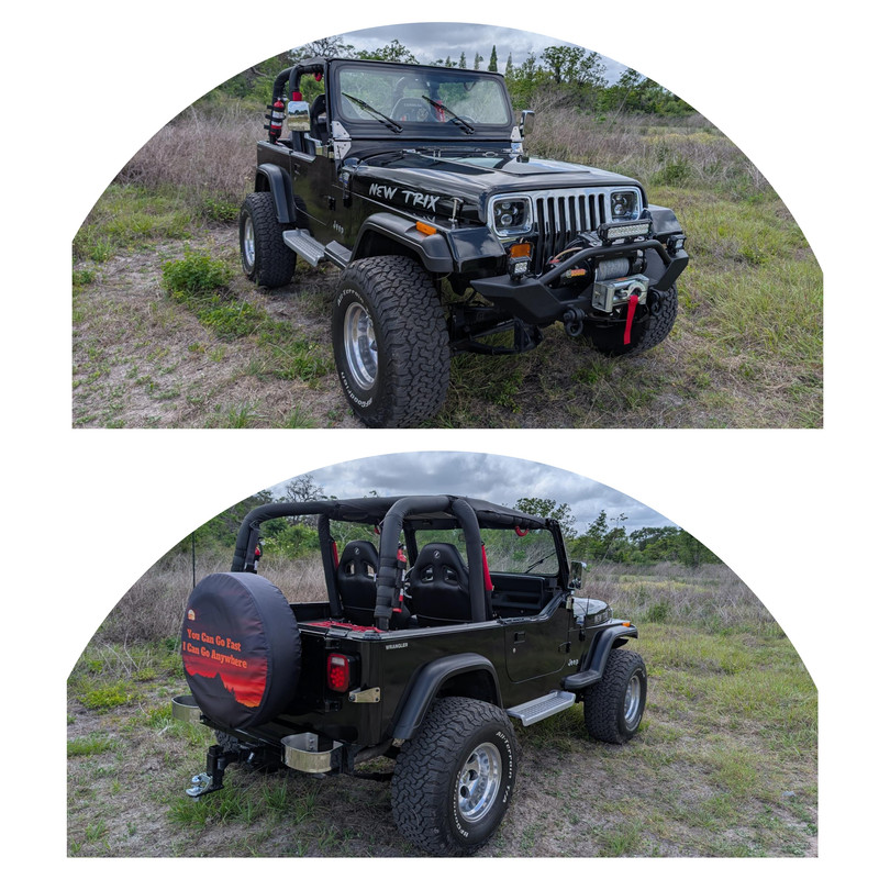

Looks close to a 4" lift to me too. This is mine with a 4" lift on 33's, the spring arch and fender clearance look close to what I have.
Thanks. I took some measurements the other day, and came to the conclusion that I indeed have a 4” lift.
I measured 24” from floor to rocker panel with my 33’s. I read that stock measurement is 18” with 29” tires. So that’s a 6” height difference. Subtract 2” for the difference between tire size(tire diameter difference is 4” total, but only the side making contact with ground matters for this calculation, therefore subtracted 2”).
