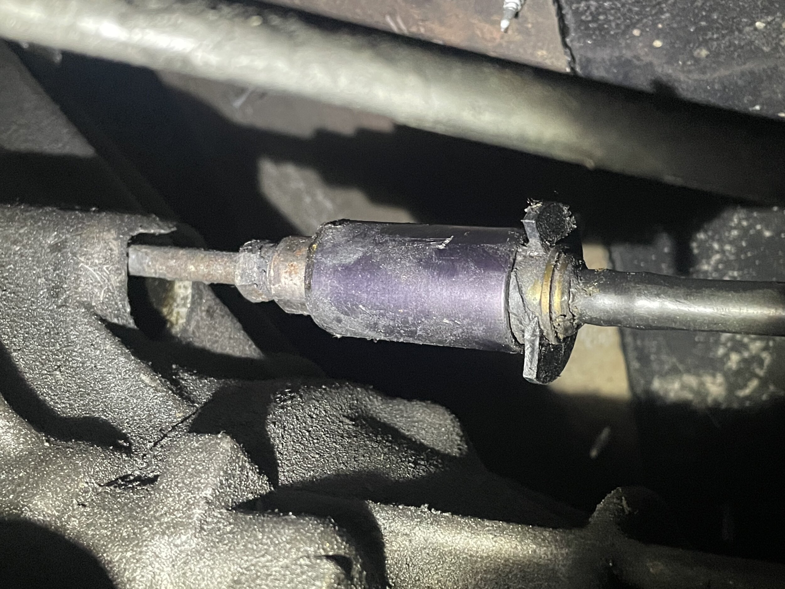

I'll try it out tomorrow. I just crawled under to look at the slave and find this... Not what I was expecting. Am I insane or isn't there supposed to be bolts and a plate to mount this to the transmission? It's just hanging there!

That is the bleeder for the slave and yes you can move it around. The line hanging off it is not stock as IIRC it had what looks like a brake cylinder bleed valve at the tip only.

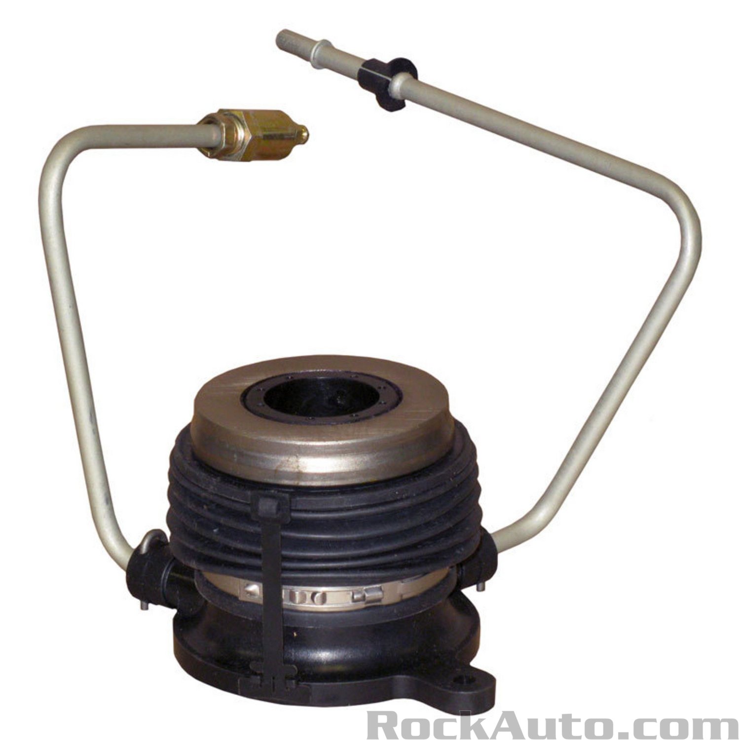

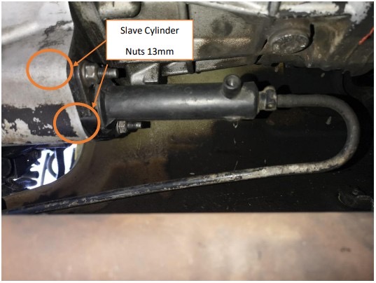

All the pics/videos I’ve found to learn how to do a clutch master cylinder install look like this… Why does mine just sit in an open hole in the bell housing?
One of the down sides of early YJ's, as well as many other vehicles, is the slave was installed inside the bell housing. Unless your was changed you wont see the slave, only that stub sticking out the hole in the B/H. The YJ was changed to external slave in 94 IIRC. There is a way to put your on the outside but IMO its not worth the hassle but thats just my opinion. The pic is the jewel inside the bell housing.

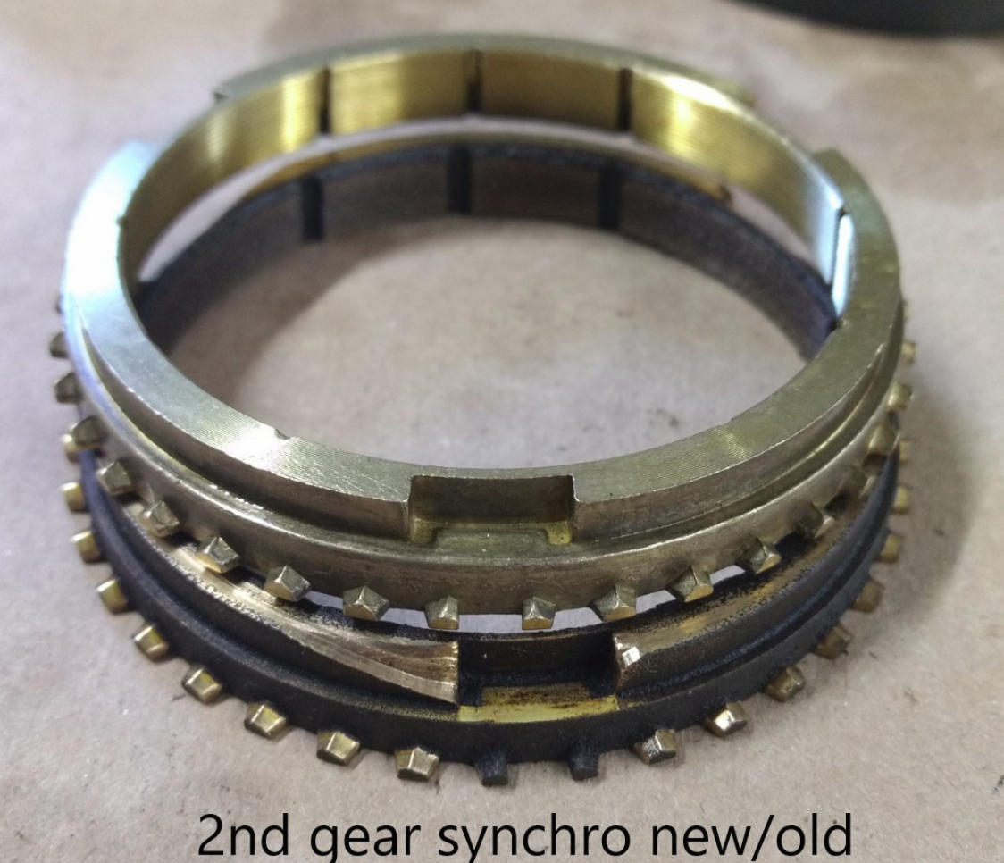

Also check the transmission fluid level. It may be low or never changed at all. The synchros are made of a sacrificial metal that wears out long before the gears do and 2nd gear is often the first on to wear out. In several different vehicles, I've had to start the engine while in first gear and shift through the gear pattern just to get me home after the clutch quit working. If the synchros are all good and the RPM's are equal, the gears just falls into place. If the synchros are bad they will almost always grind when shifting.
This is what I found with 2nd gear.
