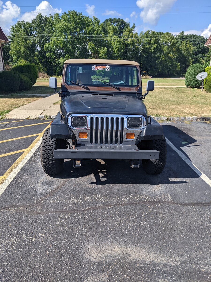

This picture is how I got it. I'll post more picts as necessay or by request if anyone reads this or cares.
