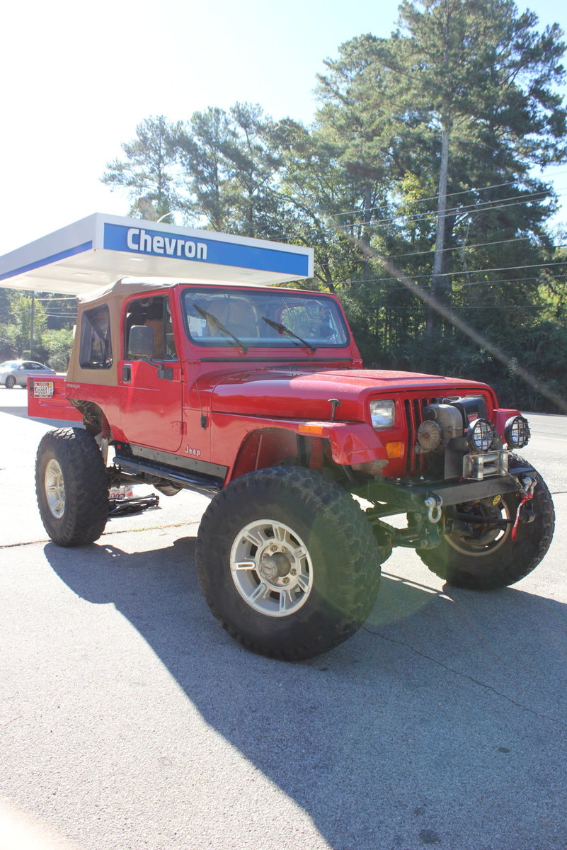

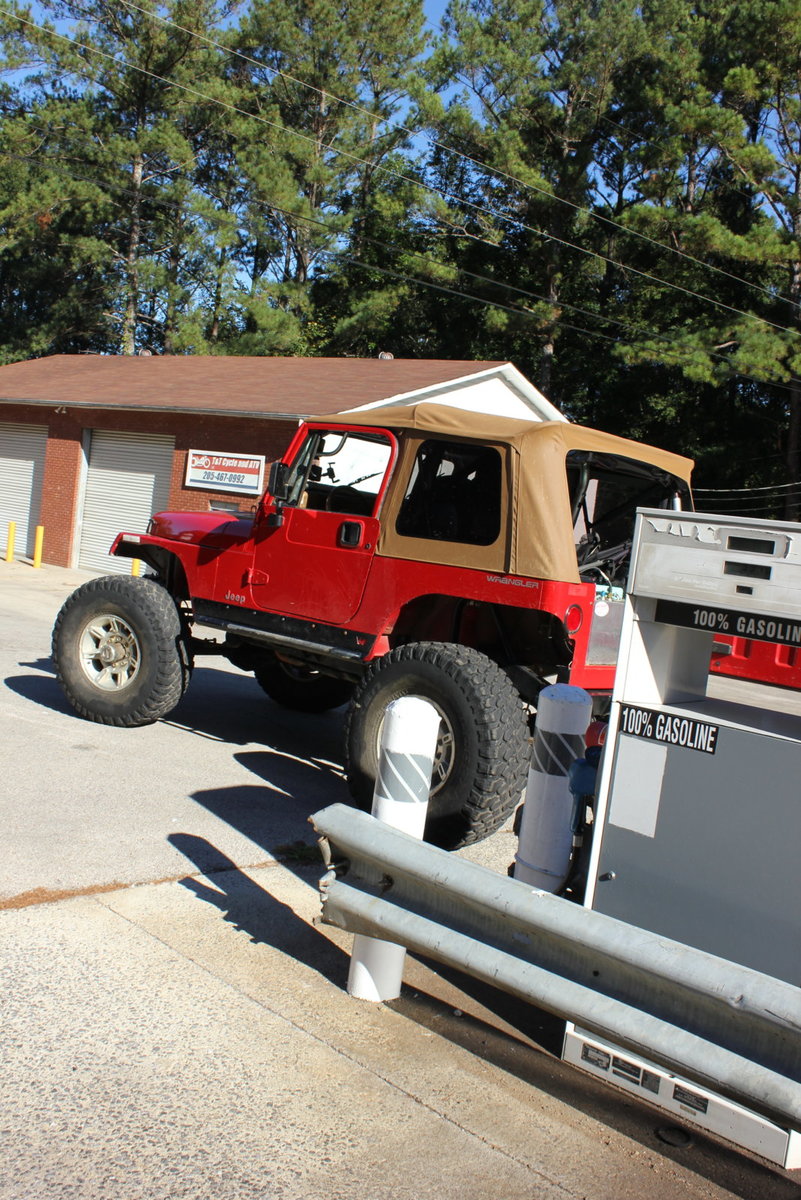

Riding from Birmingham Alabama in a 1994 one ton YJ via the back roads to hit the trails at Coppinger Cove, Tenn to do some wheeling and camping. Hunting for rock gardens was our main goal. All on a whim with my brother.
~300 miles via the back roads, red label 38s, one tons. No interstates on this trip.
94 Jeep Wrangler YJ running factory 4.0, factory AX-15 manual trans, Dana 300 twin sticked, XJ leafs for the rear wheel base stretch, wagoneer leafs for the front wheel base stretch, Dana 60 front, GM 14 bolt rear, 38 inch sticky’s.

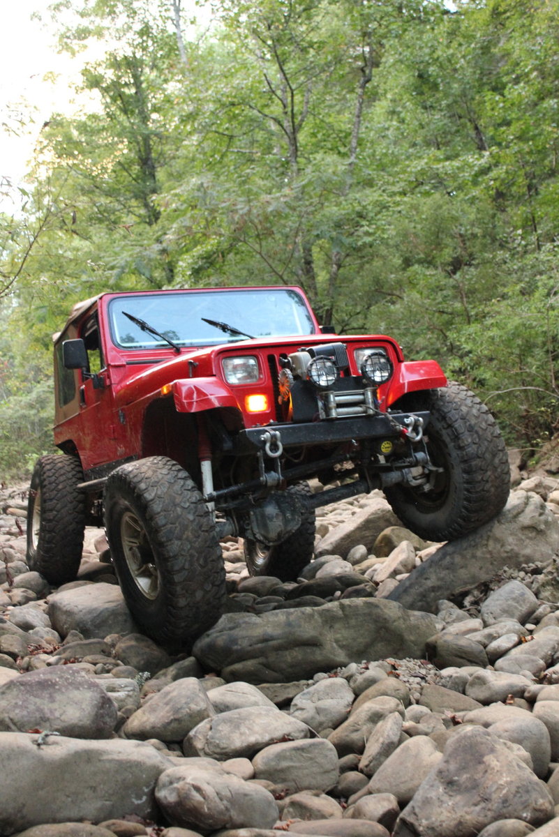

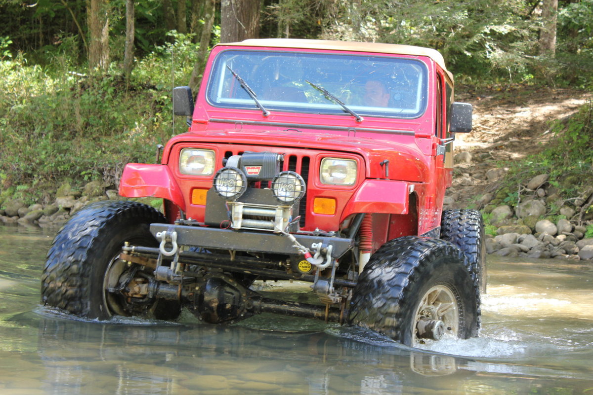

The Falken WildPeak M/T stickies really hook up even as worn out as they are :(. This Jeep is really built well, it drives and brakes straight. The custom Alcan spring over springs provide a nice ride and rides better than a factory SUA YJ over bumps with the extended wheelbase and the Rancho shocks.
The factory 4.0 and 5 speed pull the one tons and 38’s great. The Jeep will pull and cruise at 70mph just as easily as my stock YJ and doesn't wonder in the lane.
The Detroit lockers in the Dana 60 and GM 14 bolt work great on the street and the trail. The lockers never left us without confidence to tackle any trail we pointed it at Saturday and Sunday.
We mostly wheeled the trails in front wheel drive via the two speed Dana 300 and it makes it a HELL OF A LOT EASIER to get in and out if tight trails, turns, as well as walking the front end back around if you get sideways on a climb.

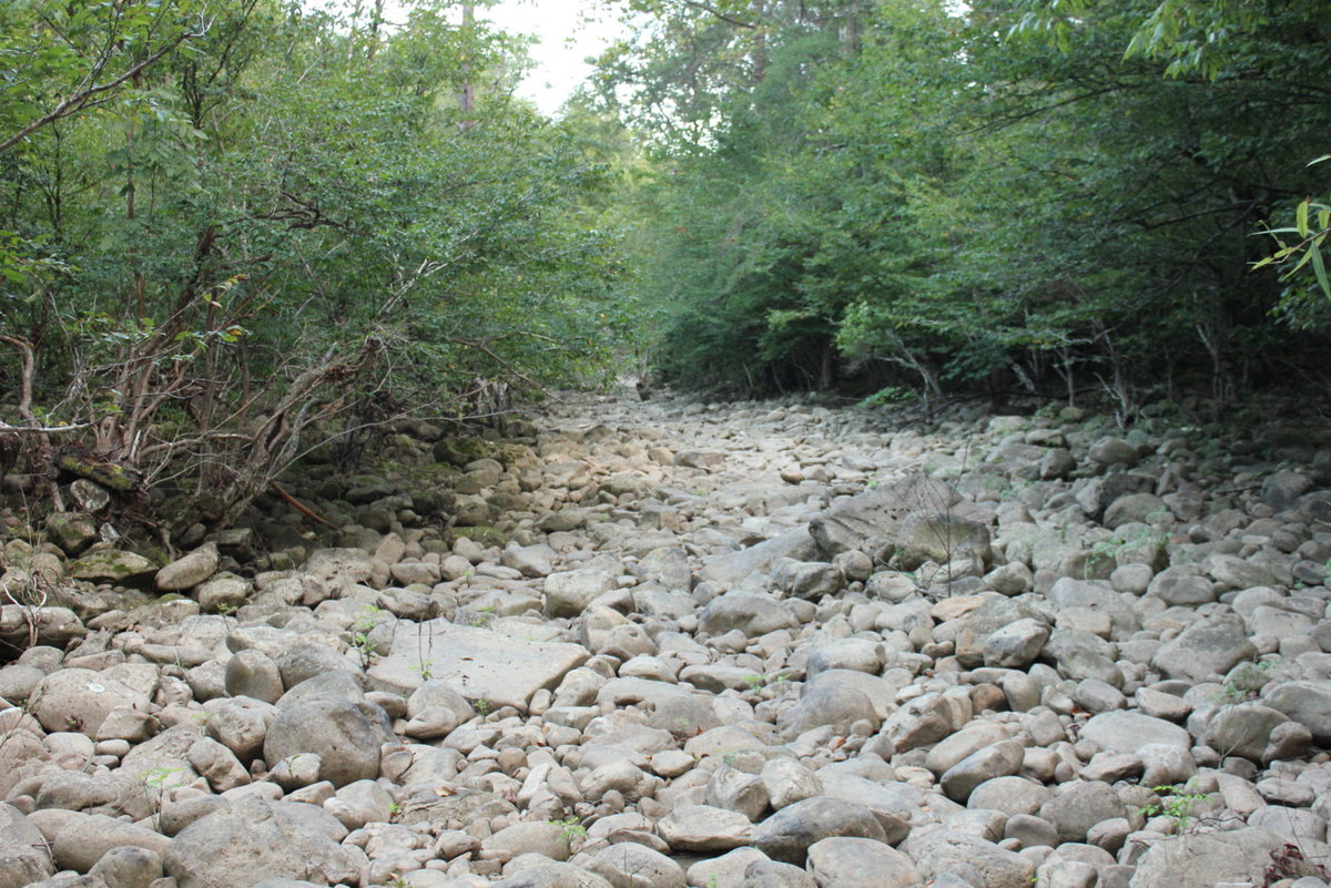

While I was out there I immediately thought it would be the ultimate spot for a factory or near factory TJ/LJ to wheel. It’s hours and hours of wheeling and the trail runs mostly parallel to a beautiful stream that’s really blue and clear. There is also a cave you can wheel in that is huge but I have yet to go down that trail. The sheer amount of rock gardens and the quality of them is insane. Best part..hardly any mud, as the bottom is mostly rock as you can see in the photos.
We saw tons of RZR’s and a few Jeeps throughout the trip. As we were leaving some really nice TJ’s were rolling in on one tons and 40s. Small axles just dont cut it down South, Dana 44’s can be found for cheap around here.
I highly suggest camping like we did somewhere along the trail. As we spent all day wheeling and still didnt get near the end of the trails as darkness approached.
Ask me any questions you might have. It honestly is the best trail riding I have seen for a Jeep.

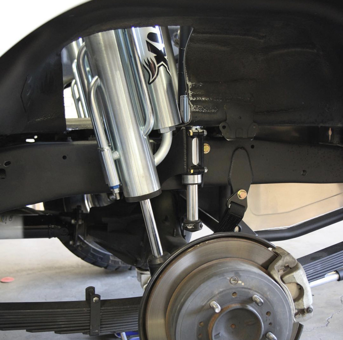

Leafs ride a rougher. They are meant to hold their arch especially if arched like a SUA lift spring.
They provide a harsh ride if I am being fully transparent. If you had the choice, stick to TJ’s and LJ’s. The YJ is dead simple though when it comes to building it. You dont have some of the suspension geomtrkes to factor in like anti squat and link separation that you find in the TJ/LJ/JK/JL world.
Having a longer wheelbase and putting a flatter spring over the axle really helps with soaking up the road bumps/events.
Some leaf spring guys will run really high end shocks and even bypasses with leafs to build something that can provide a smoother ride as well as more articulation.
I have yet to ride in something on leafs with very high end shocks. But would love to have that kind of opportunity.
Coming off your last TJ build, you know for a fact that shocks and shock placement can be pivotal in ride quality.
I will add that once offroad with a big tire(lots of sidewall) and beadlocks, once you air down to under 10psi it rides a lot better.
