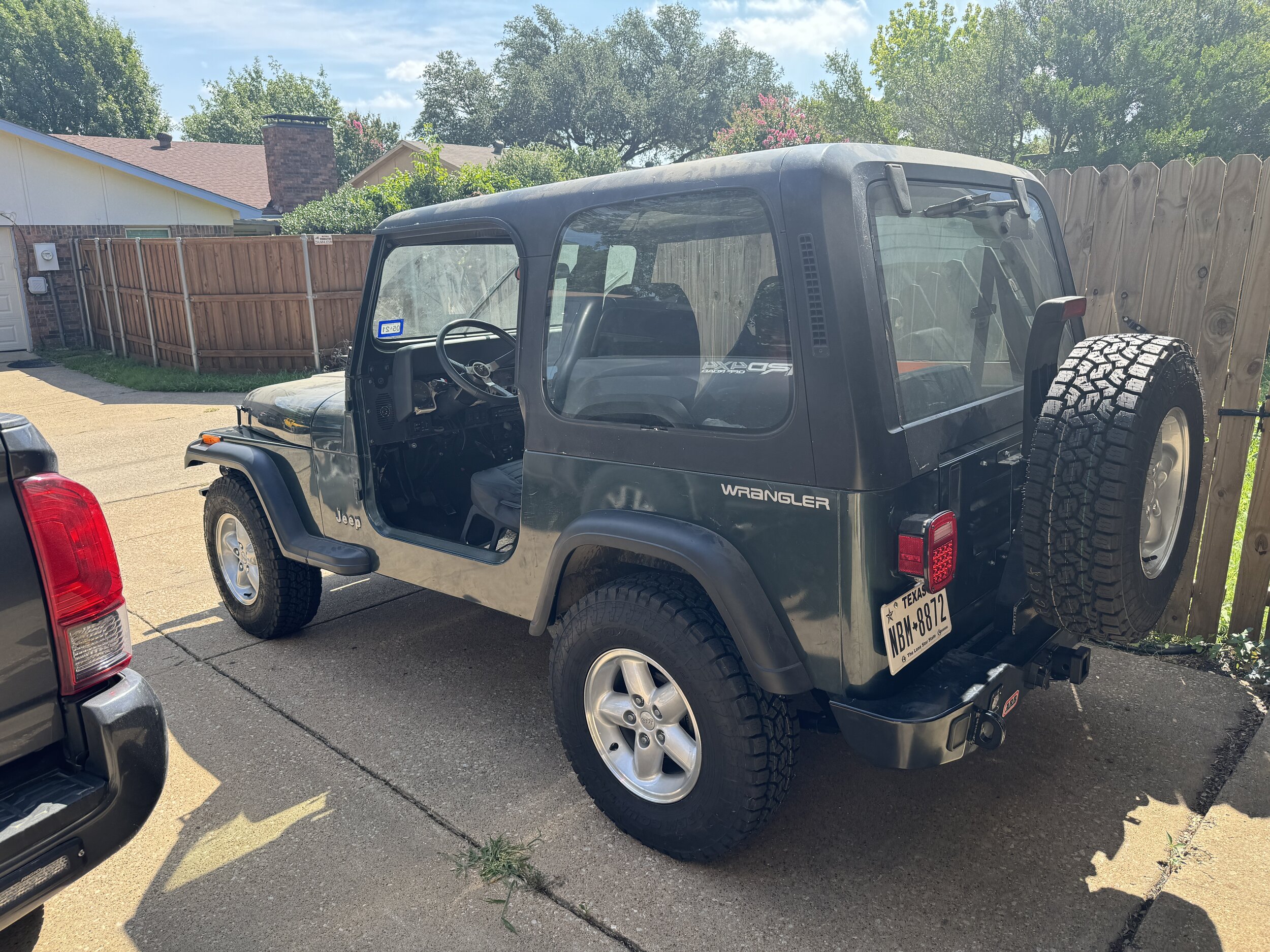

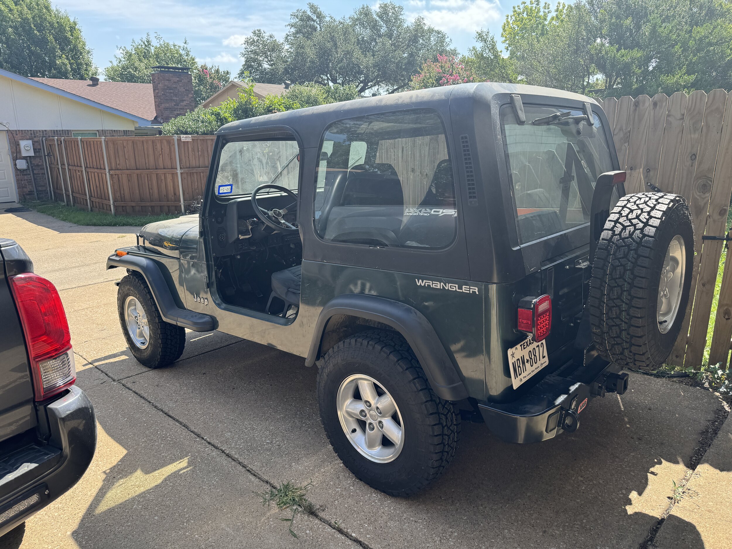

Here's a pic of mine on 15x7 TJ Grizzly wheels with 30x9.5 Toyo ATIIIs. It fit pretty well, just would hit the leaf springs on tight turns. One thick flat washer per steering stop fixed it. No lift here, lift would have looked a bit better I think.
Thank you! Beautiful Jeep by the way. What washers did you use? If you remember.
Thanks. Trying to restore it to its mostly original stock beauty, so it now has the styled steel wheels and 215/75 tires (BFG KO3). Although I did like the TJ Grizzly wheels too. I still have them and will hang onto them just in case. They were NOS from Mopar.
Washers were just for 3/8” bolts, I got them from the “thick flat” drawer at Ace Hardware. Being thick, they were more than needed, but I wanted something that wasn’t going to bend and flex when the steering was at full lock, so I went with the thicker washers. They also can’t be too large of a diameter or else they won’t sit flat on the spot on the knuckle. Just go to the hardware store and you ought to find something for 3/8” in the grade 8 section.

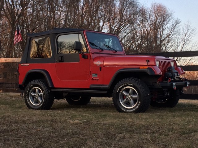

If you went with 235/75R15 (29x9.5), you wouldn’t have any rub at all on 15x7 wheels, but it may look a bit goofy on 2.5” lift.

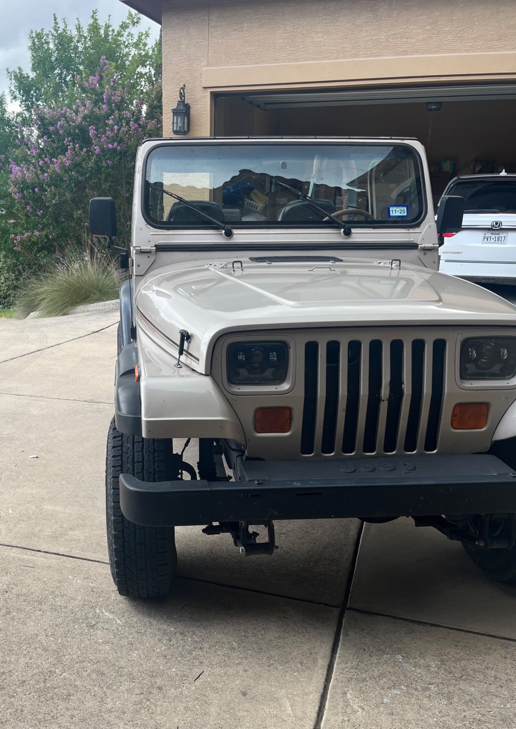

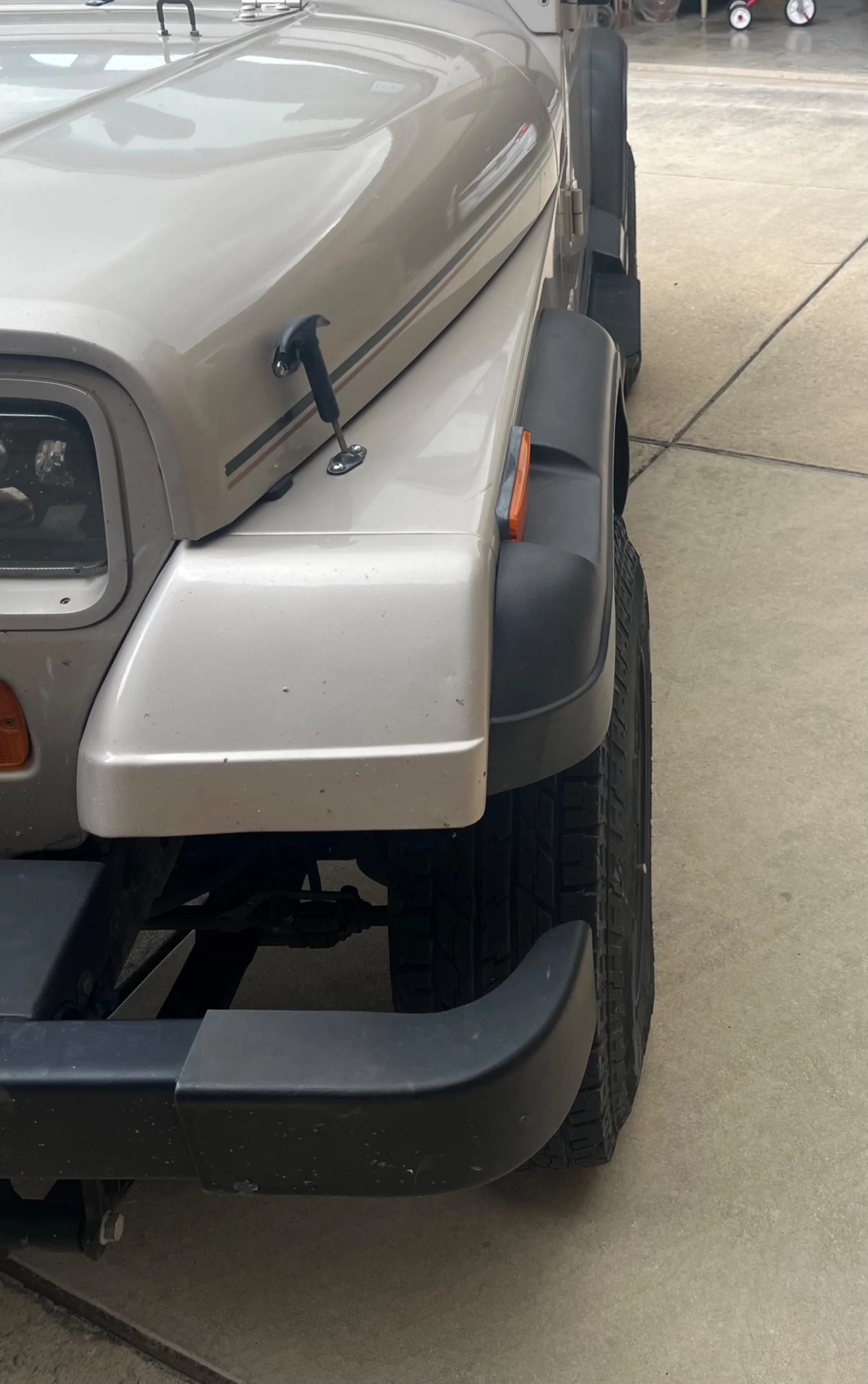

I have 30 x 9.5 tires on factory TJ wheels (15 X8) and a 2.5” lift. Tires don’t rub anywhere. Standard fender flares. I can post photos later today and even measure the total width if you like.
Beautiful! Thanks for taking the time to do that. Very helpful. Any chance you can send a pic from the side? I’d love to see the amount of clearance the tire clearance and if there is room to spare for 31 inch tires.
Never mind @TRevs! I looked back at one of your threads and found a pic from November 2024. 30 inch tires look to be a perfect fit. Thanks again!

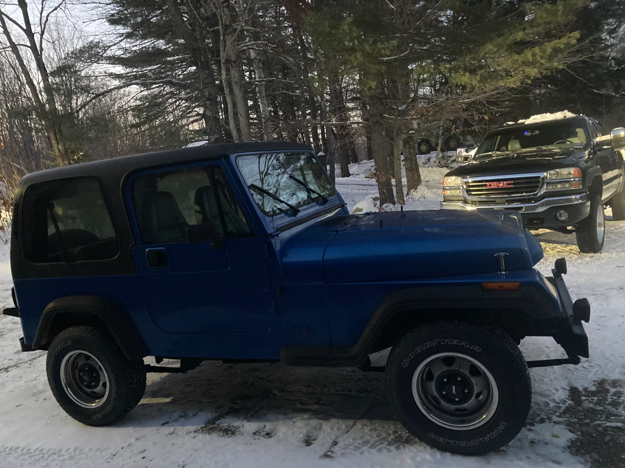

Little bit late to the post... 2.5" of lift with 30 x 9.5 BFG All Terrain KO2s on 15 x 8 Granite wheels...no rubbing issues...
