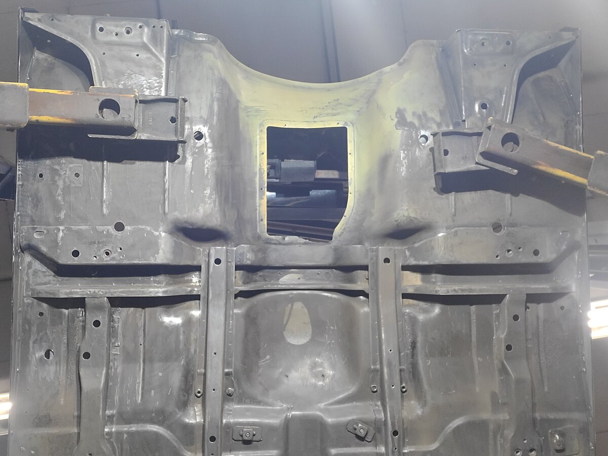

Debating on bed liner...
Any recommendations?

Im no expert on this but the couple trucks Ive had that were Rhino lined were not all that hard to chunk or nick exposing metal. When that happens moisture can get underneath IMO like drowning things with undercoating. Id think some good quality paint type coating would be best ,but again Im no expert.

Ditto. I would paint it. And that tub is in amazing shape in my opinion. If I could take the same pics as you of mine
you would probably laugh.

Thanks Brother. I've been pretty diligent about keeping her clean.
Not sure she'll ever see a mud hole again... but thank you.

That's one of the products I've researched. I believe I'll be using Raptor. It is highly rated. Locally produced. And able to be tinted. My painter has applied it numerous times so pretty familiar with the application process as well.

I'd just shoot it with a good rust preventer and then hit it hard with marine primer and then a few coats of good quality hard enamel to make it slick for easy pressure washing in the future.......

If you do do liner....Remember to put bolts/screws into all the threaded holes before you spray...And razor around the joint before you unscrew them.......
