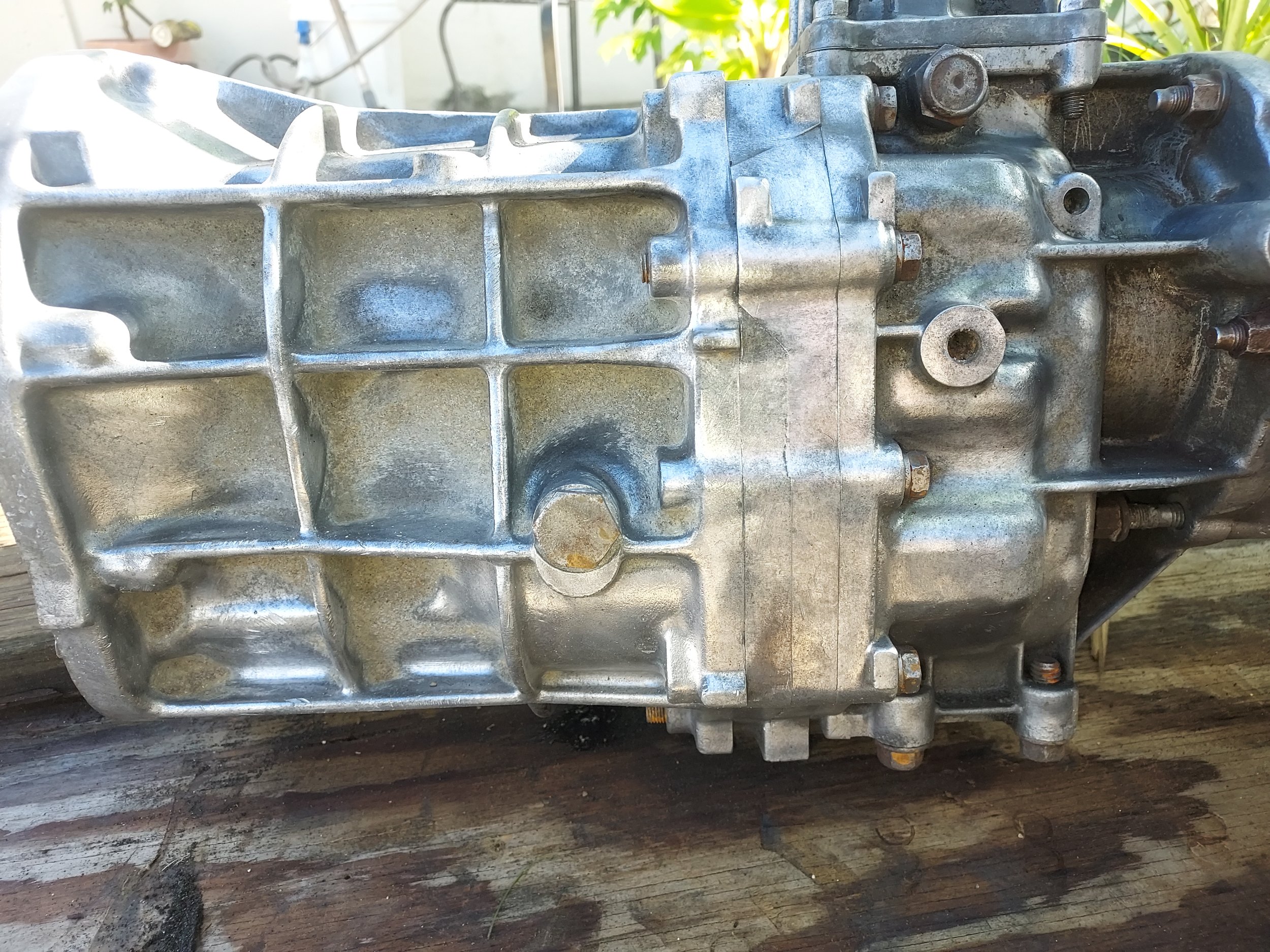

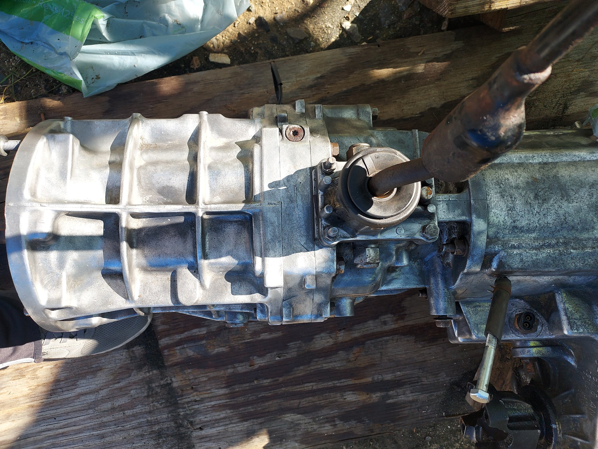

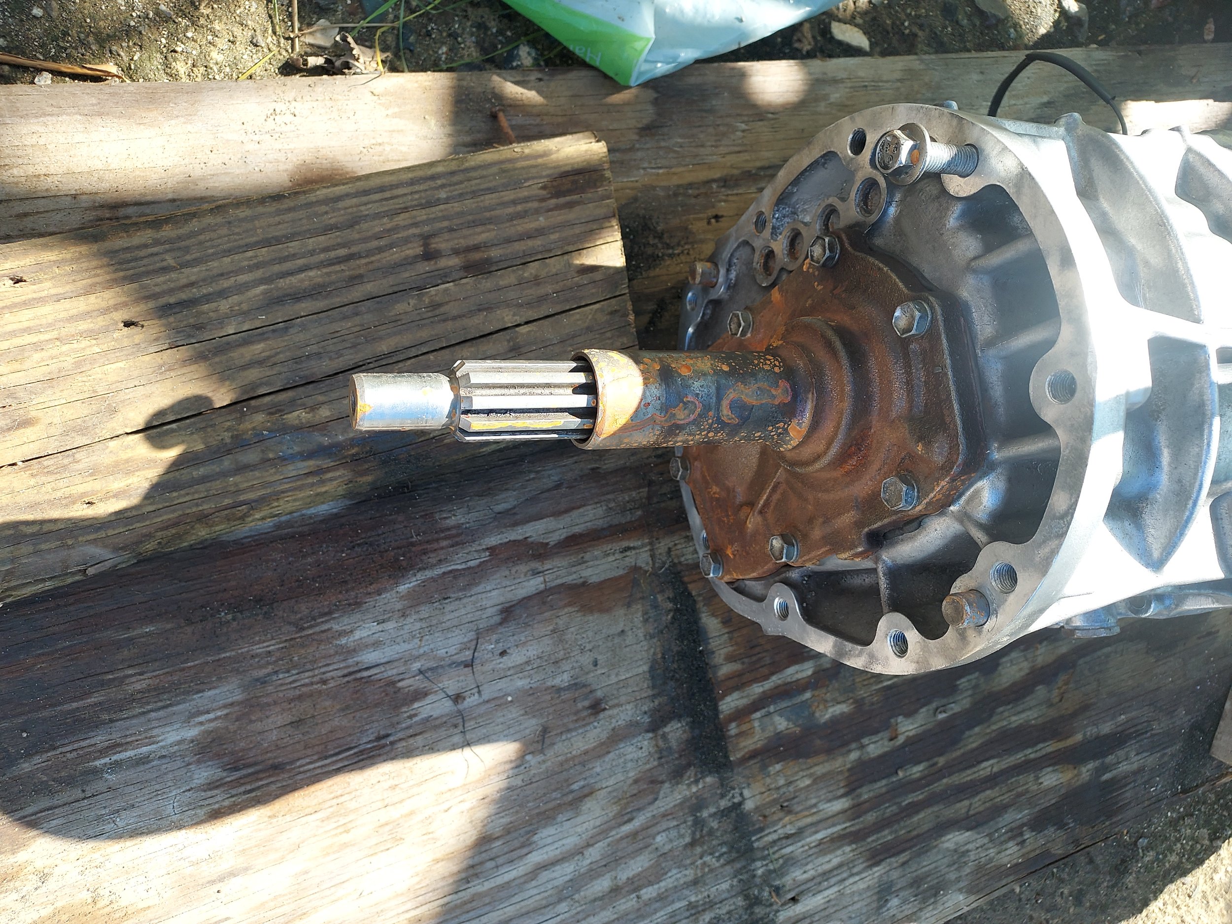

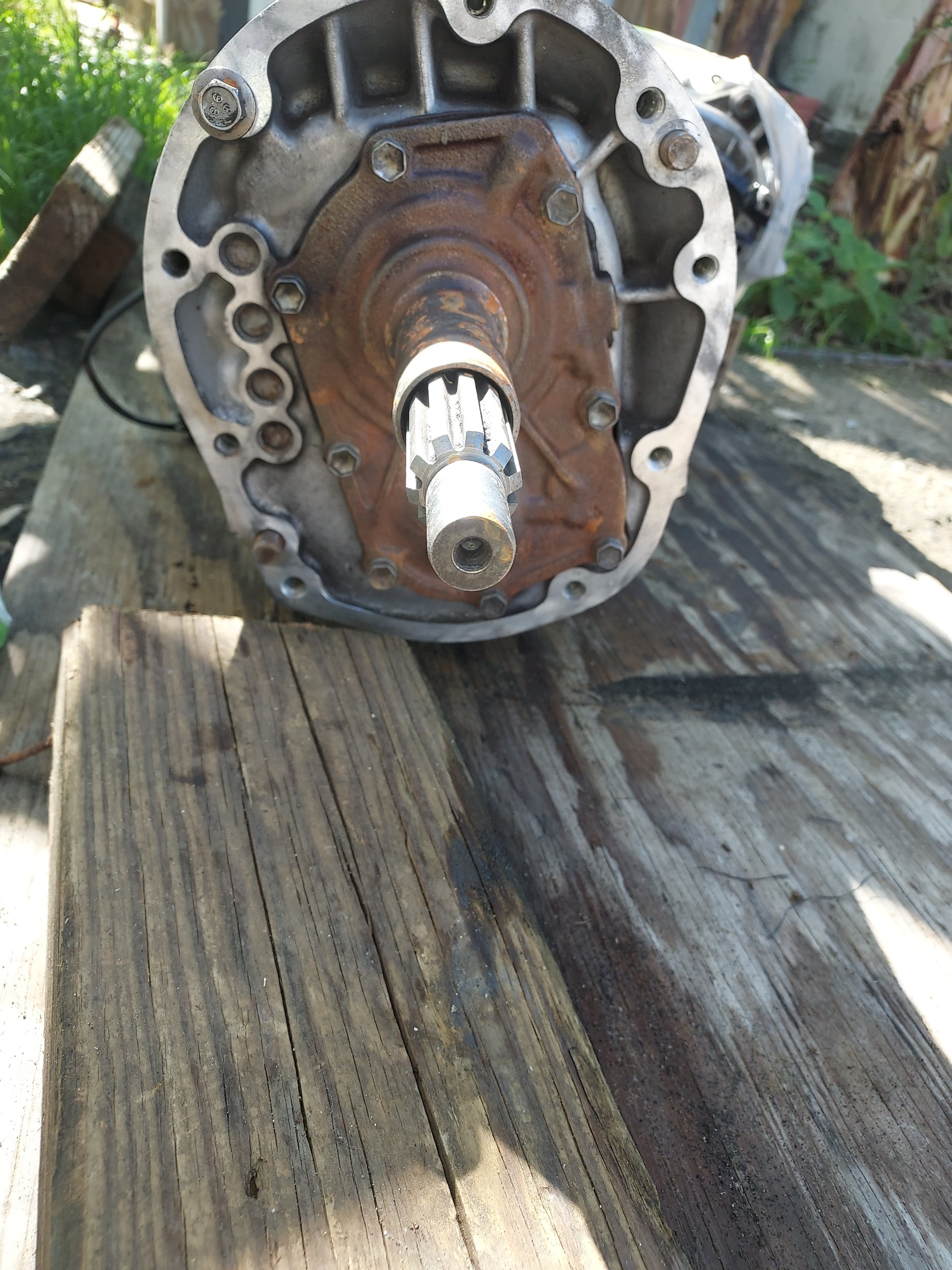

Hof. Dont know donor, tranny does not have any number nowhere, the suppossed number ubder the intermediate plate is totally erased. Please see attached pics if you con get me ahead. Thank you. I am concerned about manufacturing date so I order correct repair kit.
Did they list it for a TJ or a YJ? I can tell it's not out of an XJ. Any pics of the transfer case behind it? I'm assuming you got them together as a pair.
That's a great question...I can see some numbers just to the right of the t-case yoke in the third picture.
Never mind, it’s a TJ transmission because of the shifter. YJ has the straight shifter base, TJ uses the curved base. So it’s a 97-99. I don’t think anything changed in that year range, so you’re probably good to buy something for that time frame.
