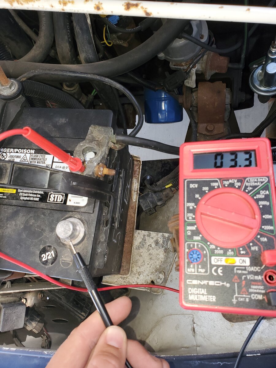

I am constantly getting a power draw of 3 miliamps on the battery from the alternator when the car is off. This is causing my battery to die in several days. I installed a new alternator thinking it was a bad diode, but still the same problem. If I unplug the voltage sensing line and ignition on input line plugged into the side of the alternator via an electrical adapter, the power draw goes away.
Installed a new key ignition cylinder since mine was warn out and still same problem.
I was considering placing an inline diode for one way power on either ignition line or voltage sensing line, unsure if that would fix the problem though.
Any suggestions or input on this would be very helpful appreciated. I've looked alot online and cannot find someone with the same problem. Thanks in advance.

The battery is new and I believe it is miliamps (new to using a mutlimeter). I included a photograph of the test. I completed a process of elimination by pulling fuses and harnesses, including the clock, and nothing changed the power draw until unplugging the two wire on the alternator.
Unsure if this matters, but the draw only occurrs when the alternator is grounded, which I believe is needed to complete the circuit anyways. It is a chassis ground and I also added a ground wire when installing the new alternator.
