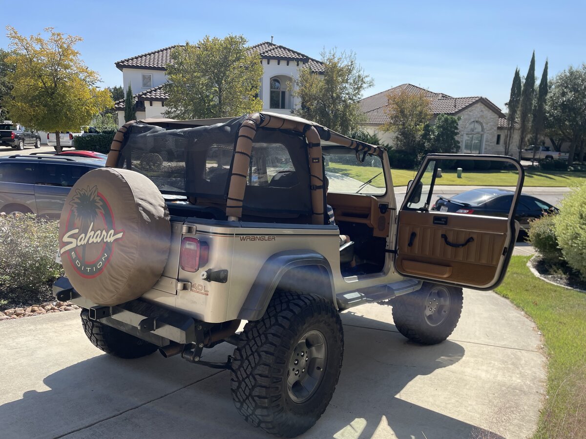

I just got my first YJ and wanted to document the project here. I've been on the sister TJ forum with an '06 for a few years so this seems like the place to be.
I never thought I'd have two Jeeps, but here we are... I have virtually no interest in new cars filled with computers/complexity/cost, so I'm looking back in time for an affordable, fun to drive ride that I can restore and maintain. The LJ takes me into the mountains on moderate trails, but the YJ will be a city driver so I can enjoy the open air and sun.
It's got the 4.0L I-6 and AX-15. I pulled the build sheet and it says:
"Lt. Pearlstone Pearl Coat"
"DANA M235 WIDE REAR AXLE"
"3.55 REAR AXLE RATIO"
among other things. The hard top and carpet are long gone, as are the original wheels and seats. At least it still has doors!
The PO put in OME springs and aftermarket long shackles for a total of 4" of lift. It's on 33x12.5 Goodyears. The tires are brand new but I really don't want to run 33's. There's a T-case drop.
There's a lot of wander in the steering, and at a minimum it'll get new tie rod ends soon. There was a significant gas leak from above the tank; the PO helped me drop the tank and replace the cracked hoses. I should have taken photos of that! There's some minor rust to address, plus all the fluids/maintenance. I need to source a stock airbox too. The to-do list is already fairly long.
My dilemma is what to do with the lift/tires. I know I want to return it to near-stock height and approach a stock appearance, but I'm debating whether to return to stock height shackles and keep the OME springs, for ~30" tires, or go even smaller (~235/75/R15) and go to stock spec shackles and springs.
Advice is welcome!

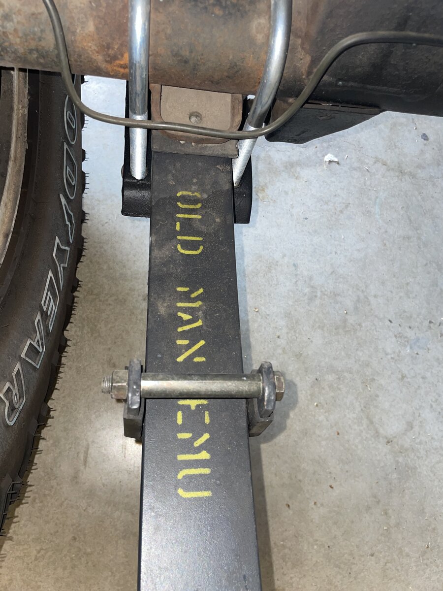

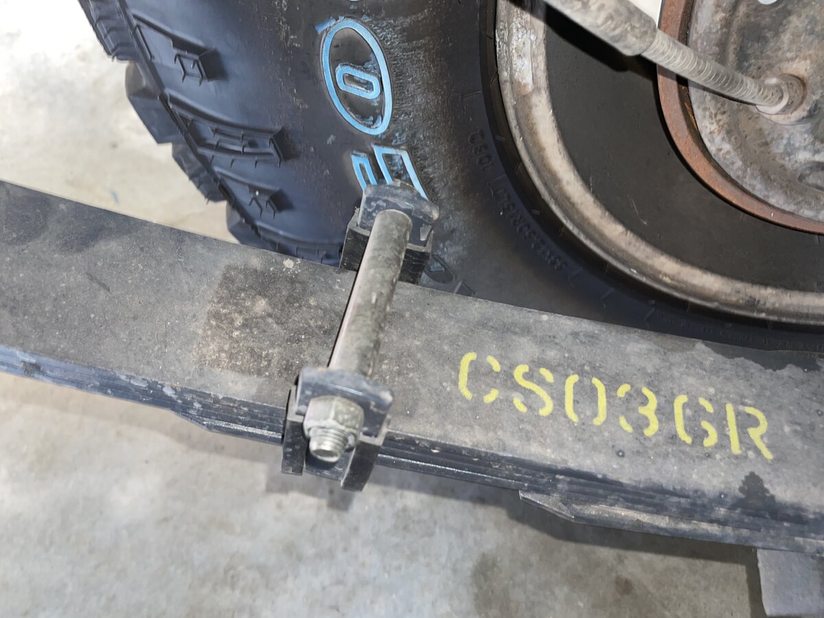

Turns out the nice and new OME springs are on the rear only. From the ARB catalog, CS036R can be Medium Load Rear, or Heavy Load Front.
Front springs are Skyjacker YJ20FSB, which is for 2.5" lift. They are not new but look serviceable.

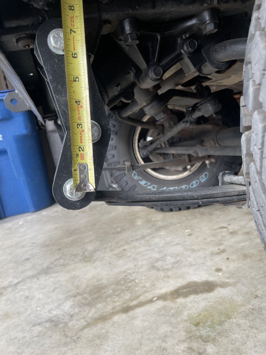

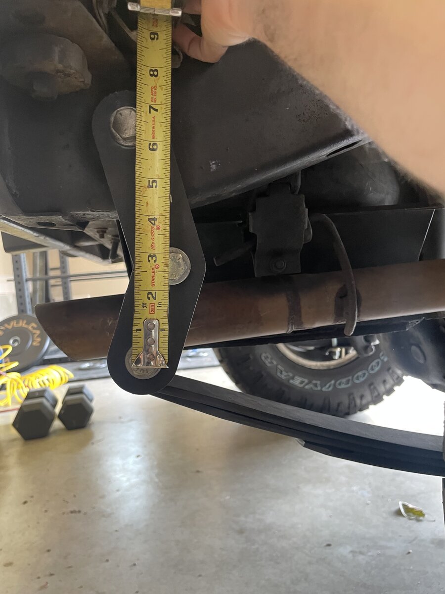

The shackles are 6.5" from top bolt to bottom bolt, so I guess that's an additional 2.5" of lift? I'm running 5" of lift right now??

Shackles lift the vehicle half the net added length. 6.5” shackle is 2.5” longer than stock, so 1.25” lift. So you’re around 3.75” if we’re calling the springs 2.5”.
The OME ‘heavy’, ‘medium’, and ‘light’ load stuff is a bit confusing. They only sell one front spring, that is the 14F which they call heavy duty. It is a 4-leaf pack and 140 lb/in spring rate. The rear options are the ‘medium’ 36R which is a 5-leaf pack @ 180 lb/in rate, and the ‘light’ load option is the 37R also @ 180 lb/in. The difference between those two is the built in arch, 37R are arched 1” less. The intended use is for hardtop vs soft top, though it doesn’t make much difference. The idea is that the hardtop will compress the 36R to sit at the same height as a 37R.
A popular choice for folks is to run 36Rs on all four corners for a leveling affect. That’s what I did. Don’t stress about the medium or heavy or whatever. They will ALL ride good. I’m not sure why they chose to make the front springs lower rate, that’s where most of the weight is with the motor and such. I guess it’s to maintain rake. Since you have 36R in the rear, I’d keep those. Whether you choose the 14’s or the 36’s up front is up to you. The ‘medium’ 36 will sit the front higher than the ‘heavy’ duty front 14F. That’s what makes it so misleading.

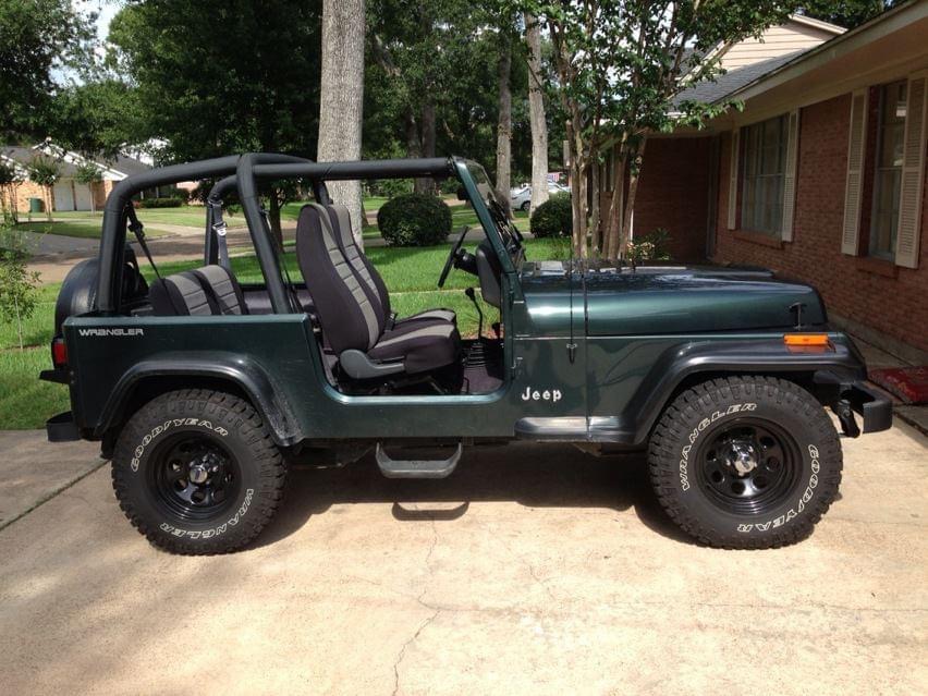

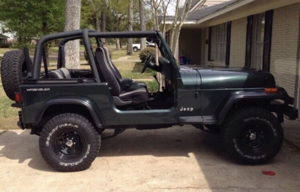

Here are two pics of mine from years ago, stock suspension and 31’s, vs Rough Country 2.5” and 31’s. The OME on 31’s sits about the same.
I thought 2.5” on 31’s was about the best look one can do without looking large and overboard, but 33’s look sharp as well. 30’s wouldn’t look bad at all either, just a bit smaller. I don’t think it’ll look like skipping leg day or ridiculous or anything.

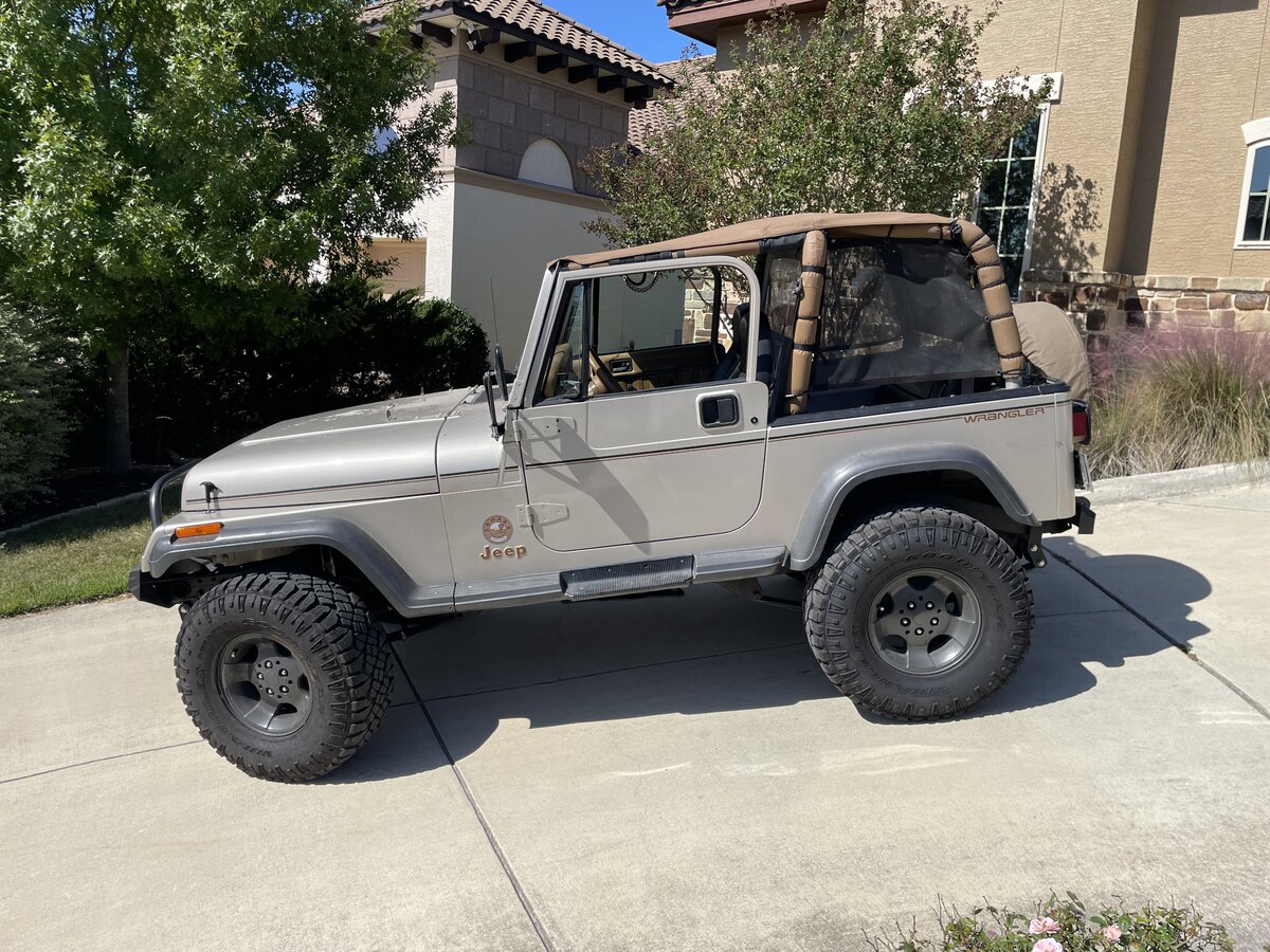

I’m pretty sure 30s will give me the look I’m after, especially since stock tires were around 27-28”.
The shocks are skyjacker and look fairly new. I’ll probably go with OME shocks if I get another pair of their springs, as well as their shackles.
In the immediate-term, I will use stock shackles the PO threw in, get it on 30s, remove the massive t-case drop.

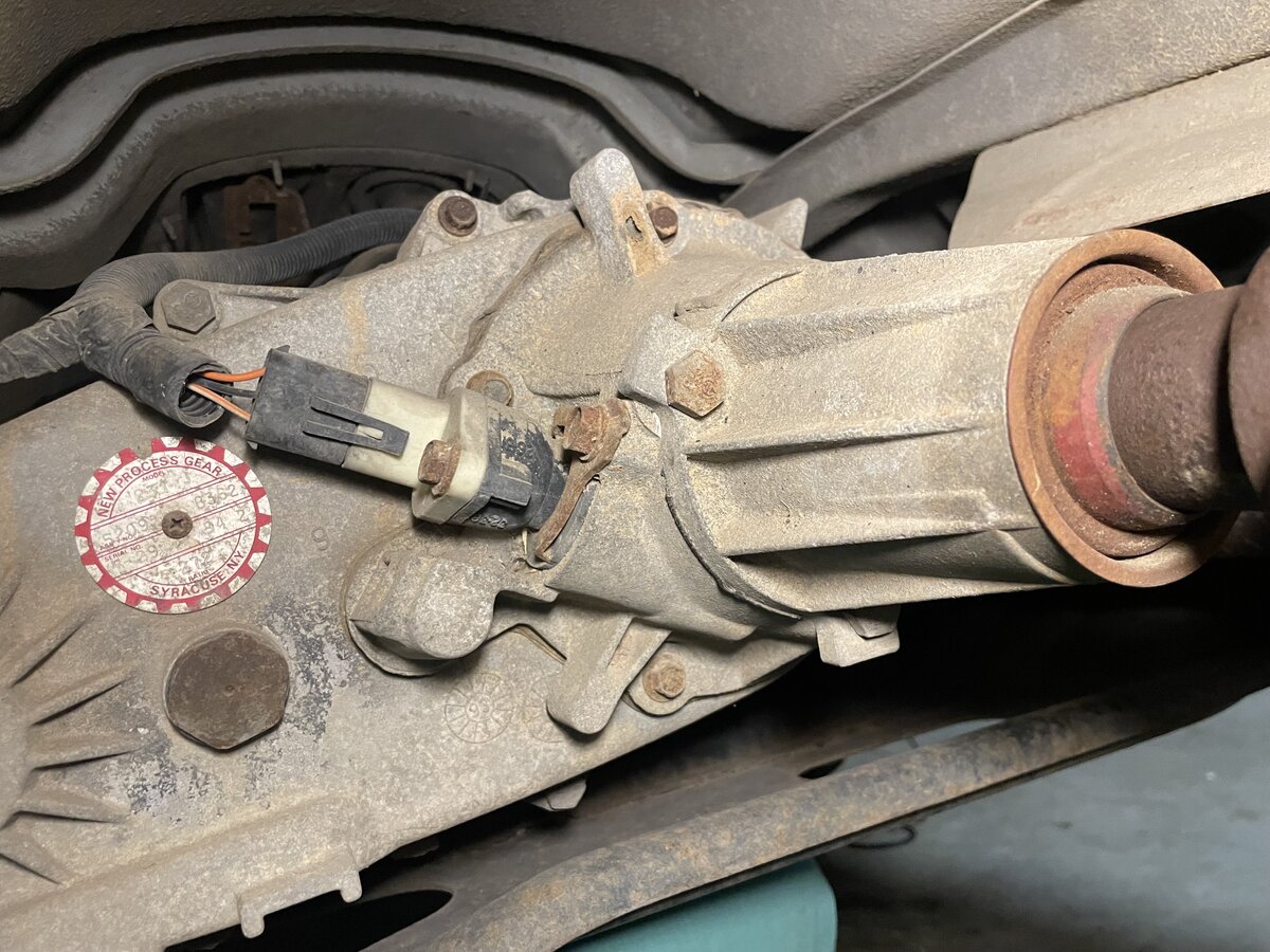

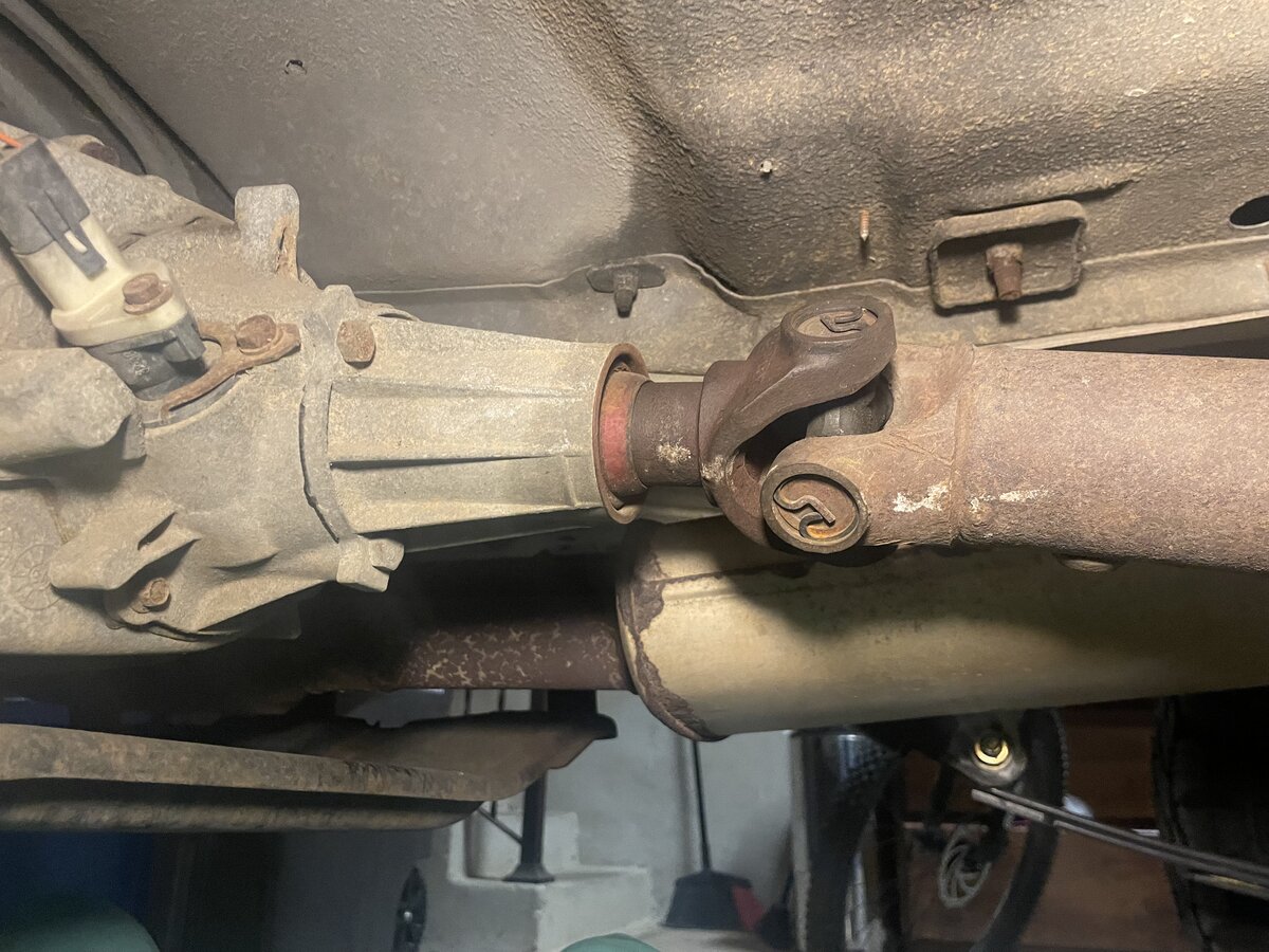

I’ll have to post photos of the driveshaft and shims. They’re way more than 2°. I assume I have the stock driveshaft without SYE, but I’m not familiar enough with all that to know what I’m seeing.

What’s the driveshaft setup? SYE, double cardan, stock? What tcase drop? The OME tcase drop kit is 6 shiny puck spacers. I’m not a tcase drop fan but the OME version is a very non intrusive one; it complements the shims they supply with the springs perfectly. But if your pinion angle seems way high, the PO may have added their own fatter shims for whatever reason, correct or not.
I finally got under the jeep and took some more photos. To me the drive shaft - transfer case - yoke all looks stock, but I really don't know.
