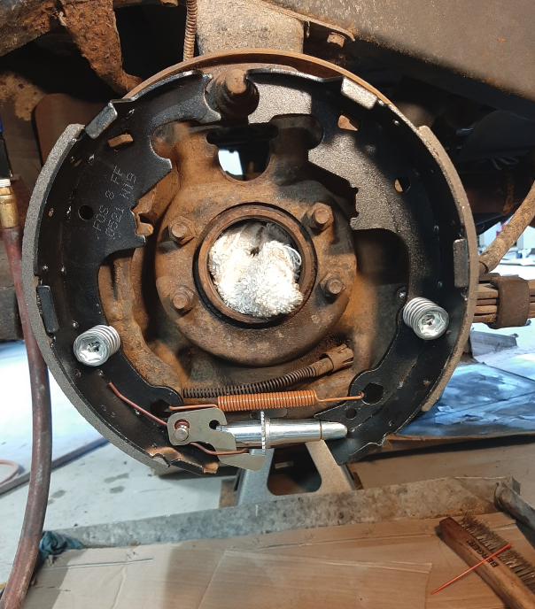

Note 2: I noticed I have 2 outer braces on each axle, perhaps the previous owner used 2 to prevent oil from leaking? Attaching picture of the old setup before I pressed the new bearing in.

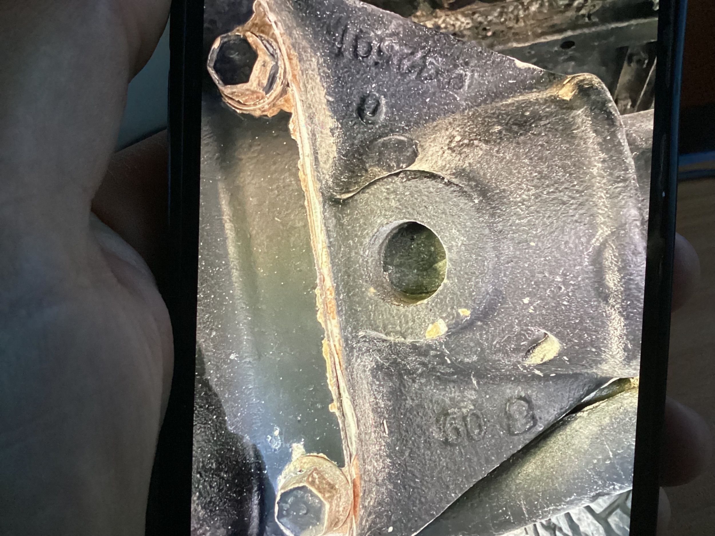

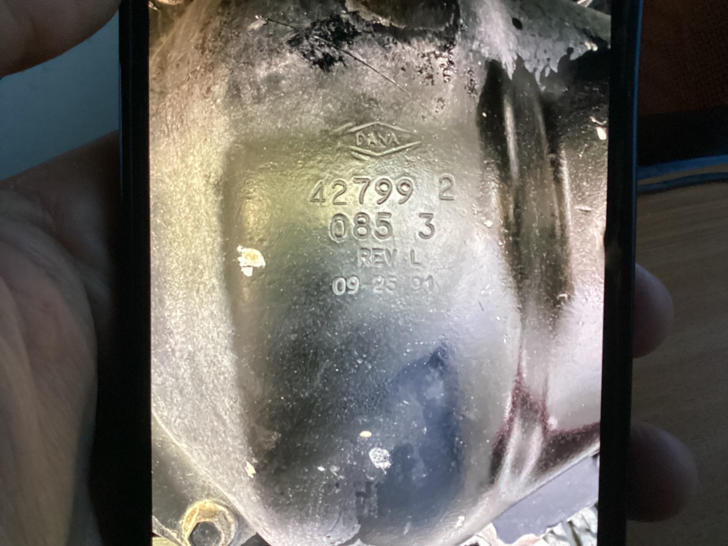

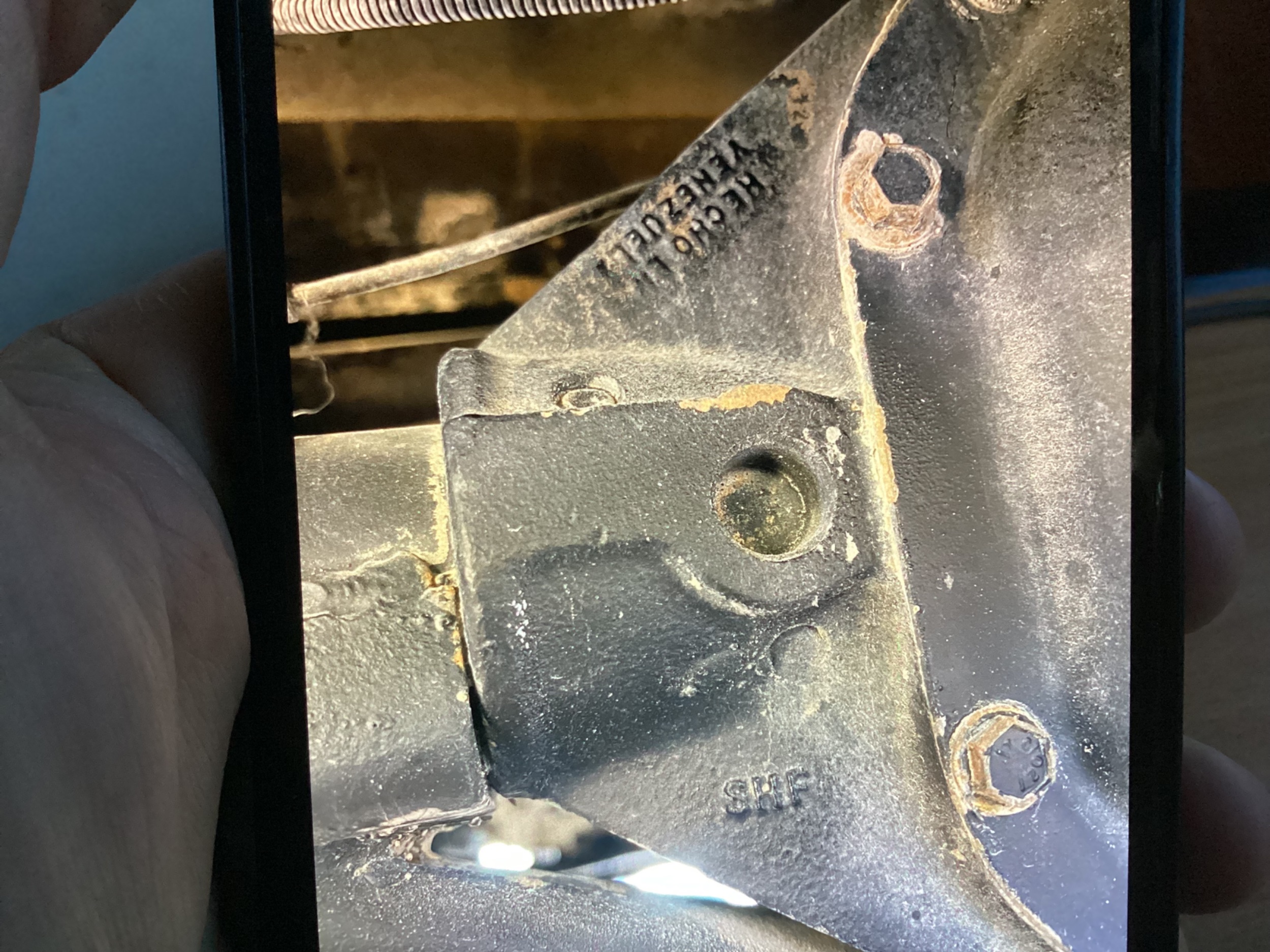

I did check the markings on the rear axle and I’m not sure it’s the original one, it looks like Dana 60 or am I not seeing it correctly? the bearing, seal and locking nut I ordered and installed were for Dana 44, I’m confused…
Attaching pictures of the markings on the rear axle:

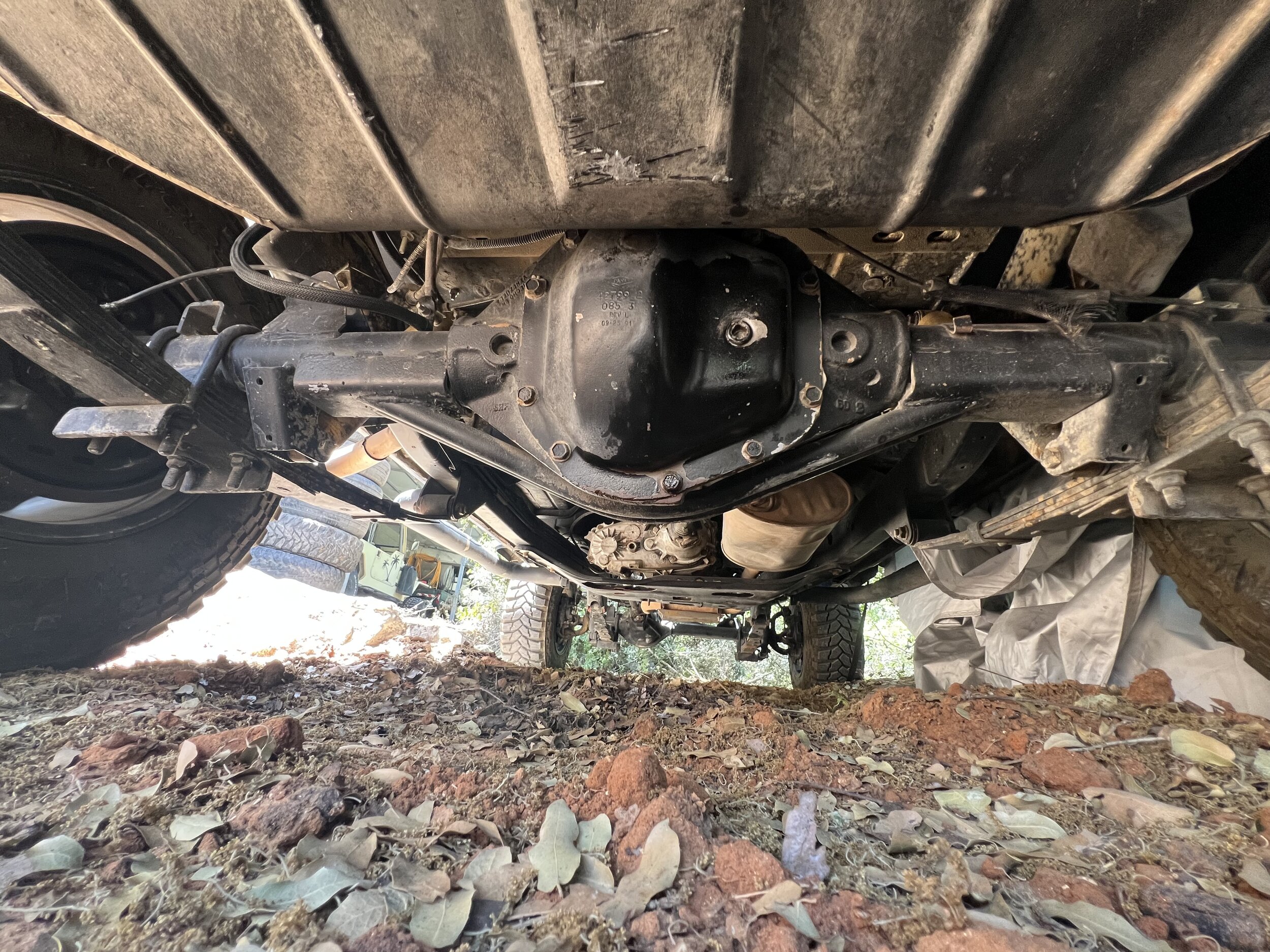

Can you post more photos of the axle as a whole? And some photos of the spring and shock mounts? It’s definitely not a Dana 35, could be a D44 or D60.
That actually kind of looks like the incredibly rare factory export Dana 44. I’ve only seen one before and I don’t remember if the brackets look like that, but the track bar mount and everything else looks too clean and perfect to be a welded up backyard mechanic job…
What’s your VIN? I’ll see if I can find any details.

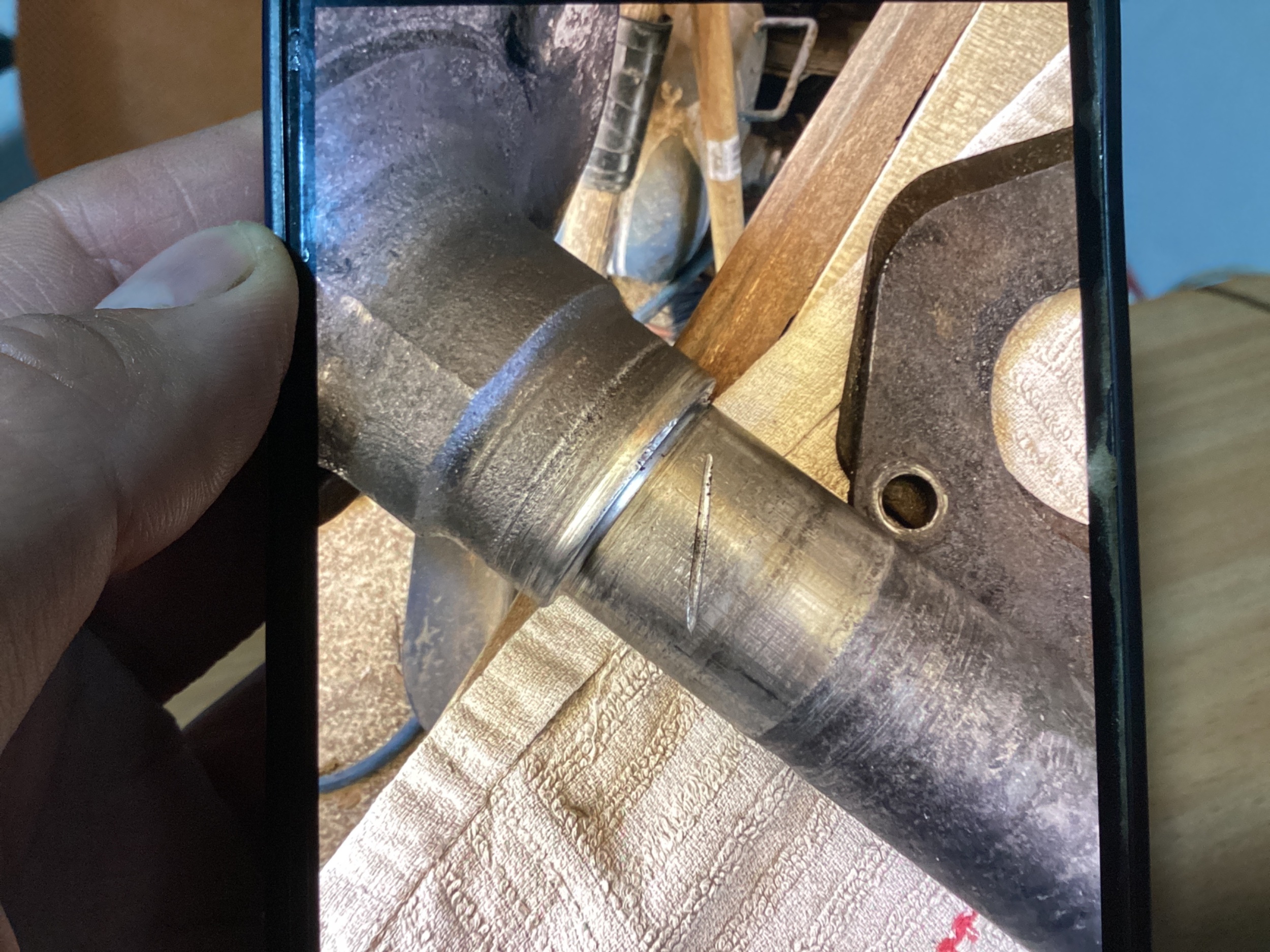

I really don’t know what’s going on. Did it rotate freely before you did all this work?….

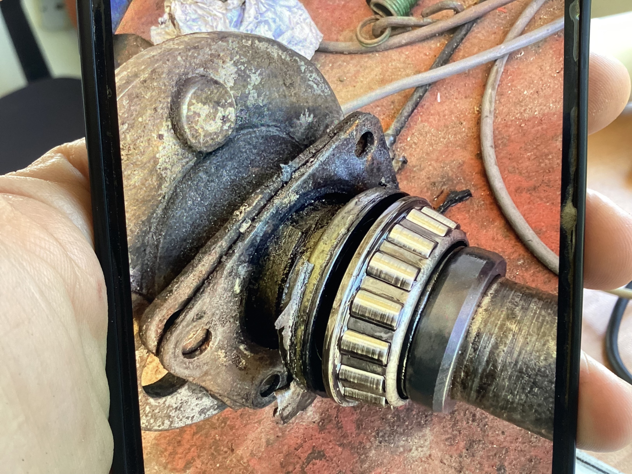

The scratch isn’t good but it shouldn’t be causing any real issues. At worst case you would be at risk of spinning the bearing race on the shaft. But the bearing is on there tight enough that that shouldn’t be anywhere close to being a problem.

You are using the stock axle retainer plates correct? The flat ones meant for drum brakes?

I am using the flat retainer plates exactly like I did with the left axle.
I’ll try taking the drum brake out, cleaning it completely, changing the mounting bolts order. I hope any of these will help.
